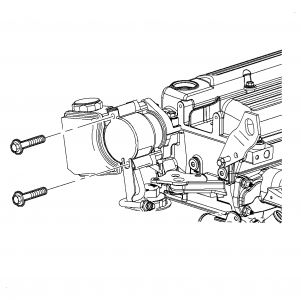

2003 Saturn L200 4 cyl Front Wheel Drive 175000 miles
The power steering pump on my Saturn has literally lost its innards. Engine oil is now coming out of the hole where my pump parts used to be. I am scared to death that just replacing the pump won't fix it..I am trying to find a picture of how the cam fits to the pump with no success... Pleas tell me whats up...
Dec 18, 2008 at 10:42 AM
2CARPRO JACK
  • 11,533 POSTS
It may have blown the seal between the two, causing oil pressure to push oil through the pump. The pump just bolts to the head. Unbolt it and see what blew up, if the p/s isnt working you will probably need a pump regardless
