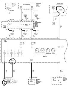

My vehicle will not shift into drive the dash light will not come on. The service light is on and the airbag light. None of the gauges work on the dash. The odometer has stopped working. I replaced the starter ignition switch hoping that was the problem. Everything started with me driving home from work one day and the speedometer bouncing up and down and the light flickering on and off on the dash. Then it just stopped working.

Hello fanizzle157 check power and ground. BCM/cluster fuse 15 A and cluster ground. Either power or ground is causing the problem. (Check out your email for this diagram)
https://images.2carpros.com/forum/automotive_pictures/46384_0996b43f80244e0c_1.jpg
