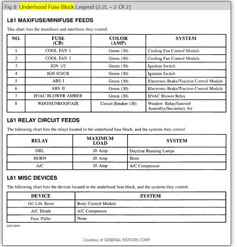

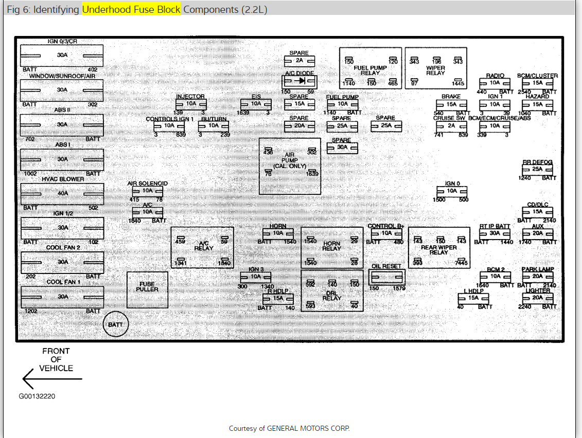

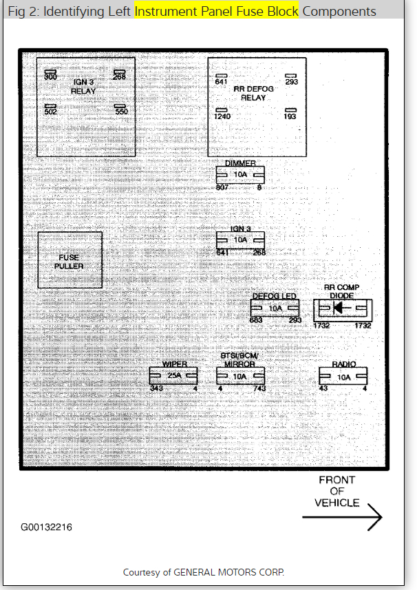

Where is the blower motor relay located?
Jun 12, 2010 at 1:03 AM
SATURNTECH9
  • 30,869 POSTS

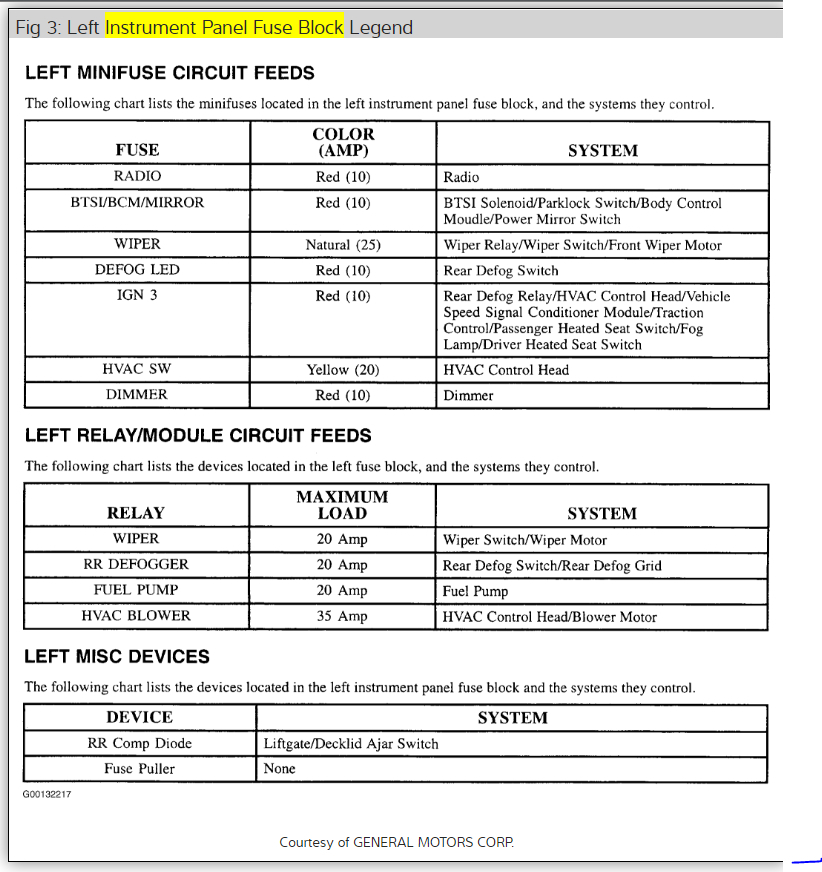

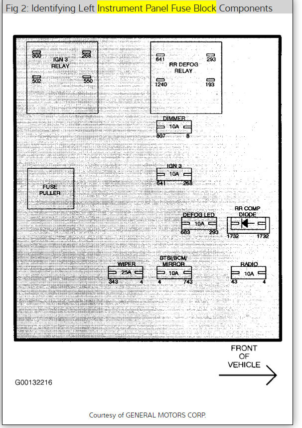

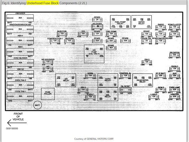

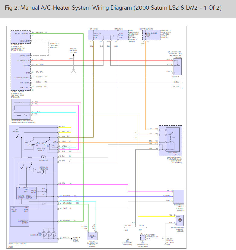

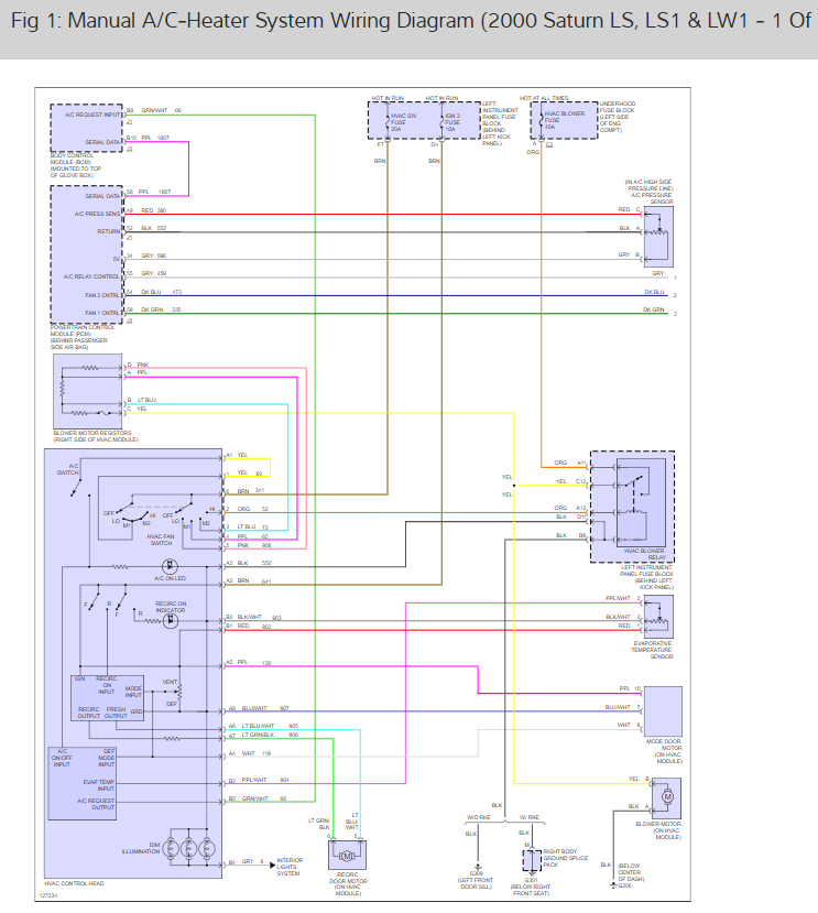

Here is the blower motor relay location and wiring diagrams so you can see how the system works and a guide to help you test the ac relay which control the blower.
Cheers
Jun 12, 2010 at 3:45 AM
VLGOING

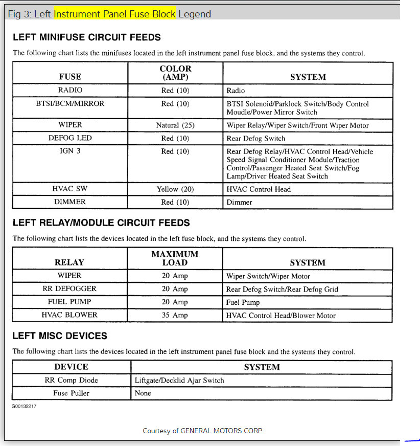

Well when we first got the car the blower would only work on high... Now it only works sometimes.. I replaces the resistor.. and the blower motor works. Someone told me it was the relay so i got a new one now i don't know where to replace it because i cant find the old one.. It's driving me crazy!!!lol
Jun 12, 2010 at 3:51 AM
SATURNTECH9
  • 30,869 POSTS
You could have a loose connection to the motor i have seen that also where you can wiggle the plug to the motor and make the motor turn on and off. I have seen the blower motor do that as well
Jun 12, 2010 at 6:22 AM
VLGOING
I found the resistor card on the passengers side against the firewall and its discolored and stuff. But does the resistor only control the 3 lower speeds? And the relay controls the higher speed. So I replaced the blower motor because it was all that was left and the problem is fixed thanks for your help.
Jun 12, 2010 at 6:53 AM
SATURNTECH9
  • 30,869 POSTS
Glad you could get it fixed, that kind of problem can be tough. Please use 2CarPros anytime we are here to help
