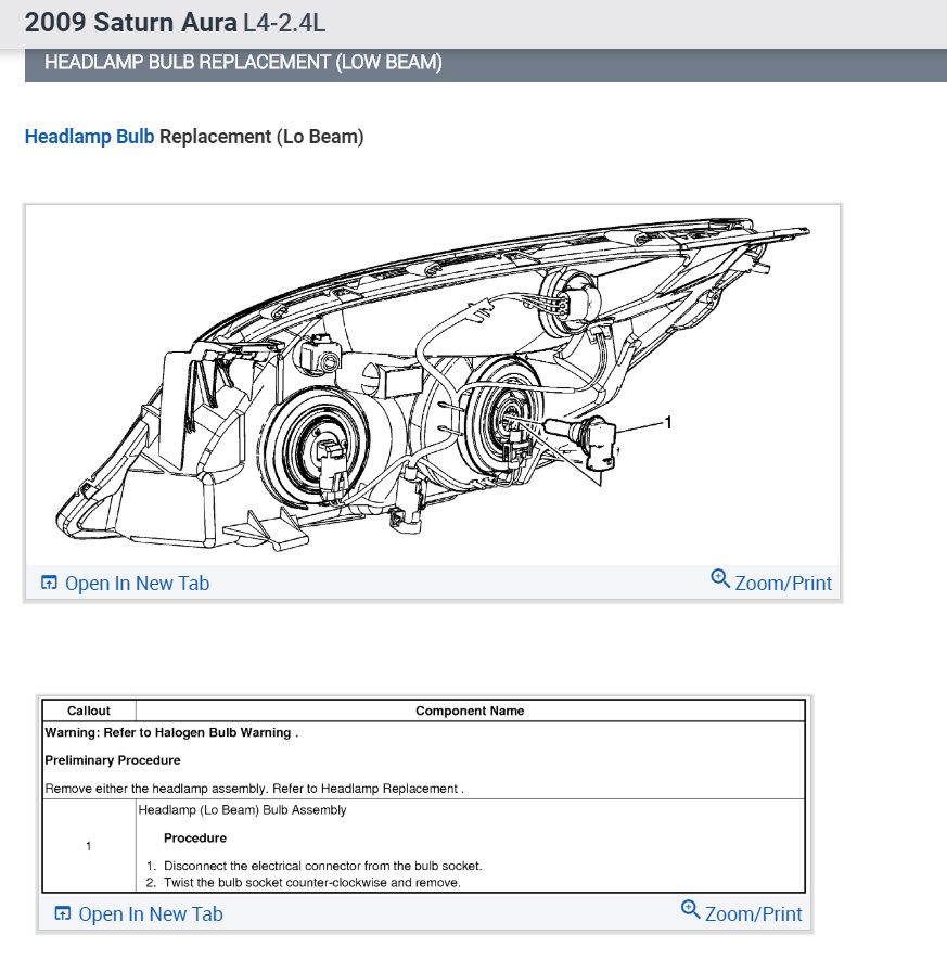

I have a 2009 Saturn Aura and I wish to change the lowbeam lights in it. Is there a easier way that I can get to the H11 bulbs with out having to remove the Front Bumper Fascia?

We, [Saturn dealer tech's] have tried other way's to make the job easier and faster, but the end result is the fascia must come off. We have found that the facia doesn't have to fully be removed from the car, but does have to be pulled away enough to gain access to the lamp assembly for it to be removed. Check out the diagrams (Below). Please let us know if you need anything else to get the problem fixed.

Unfortunately you do have to partially remove the front bumper cover.
Remove the front bumper cover fasteners from the center and side of the headlamp to be removed, gently pull the fascia forward to allow clearance to remove the headlamp assembly. Remove the three headlamp assy screws, Lift upward and pull the headlamp forward to disconnect the headlamp harness electrical connector. Then twist the bulb out of the socket.
