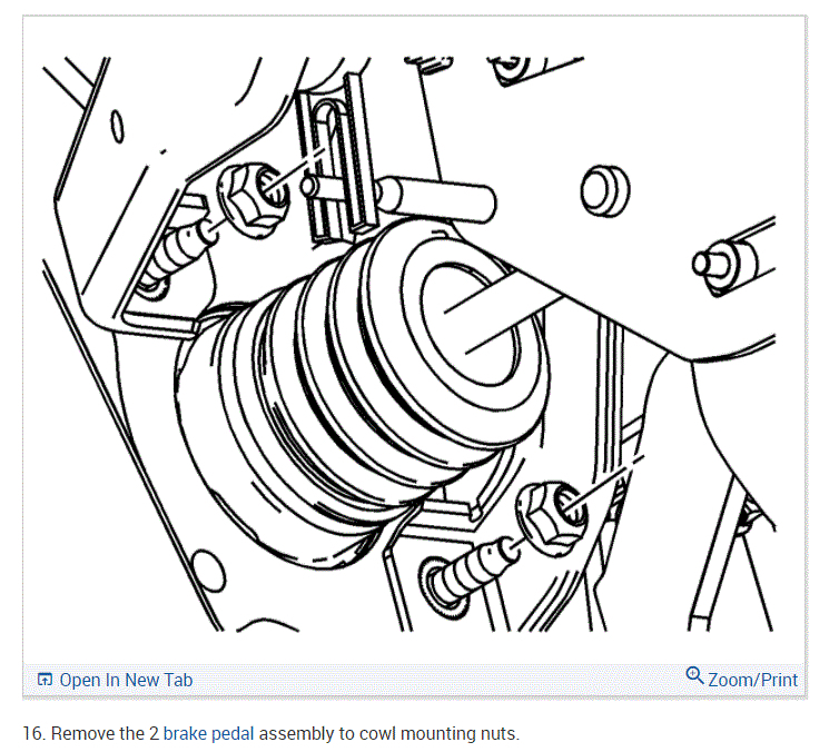

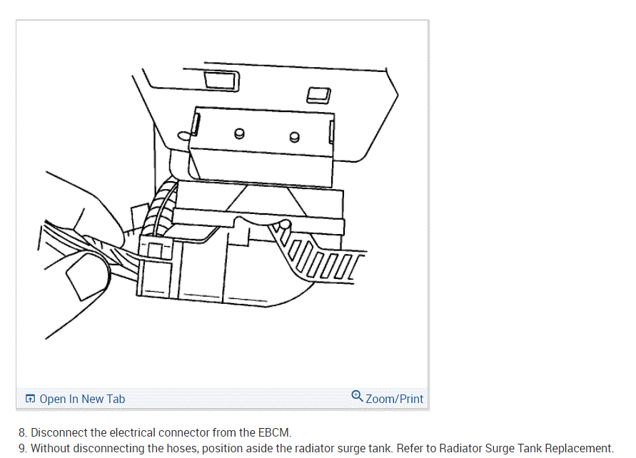

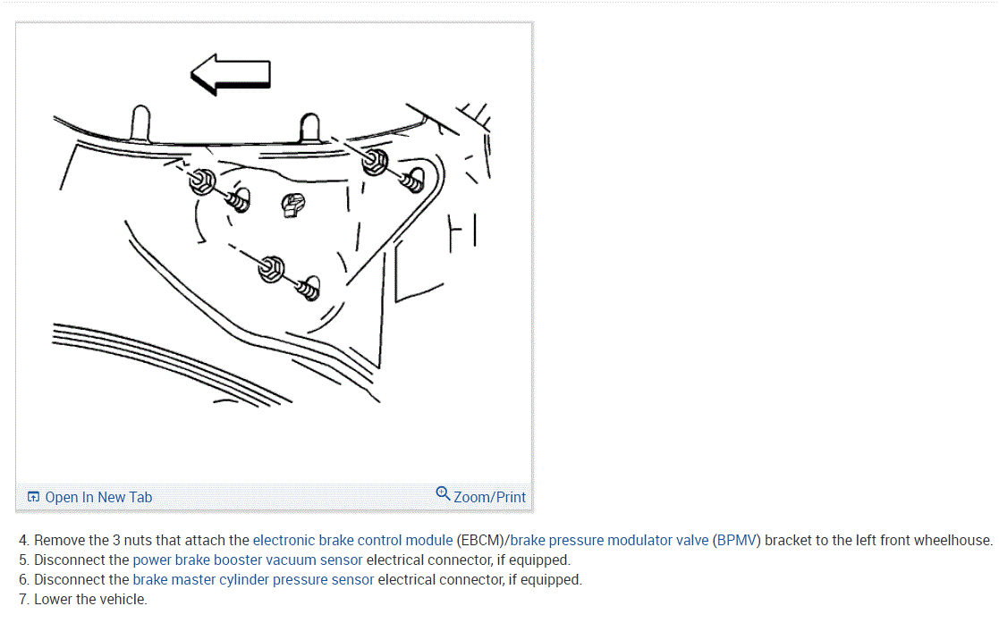

a mechanic said the brake booster is shot change it out?
Mar 8, 2010 at 8:51 AM
  • 110,244 POSTS

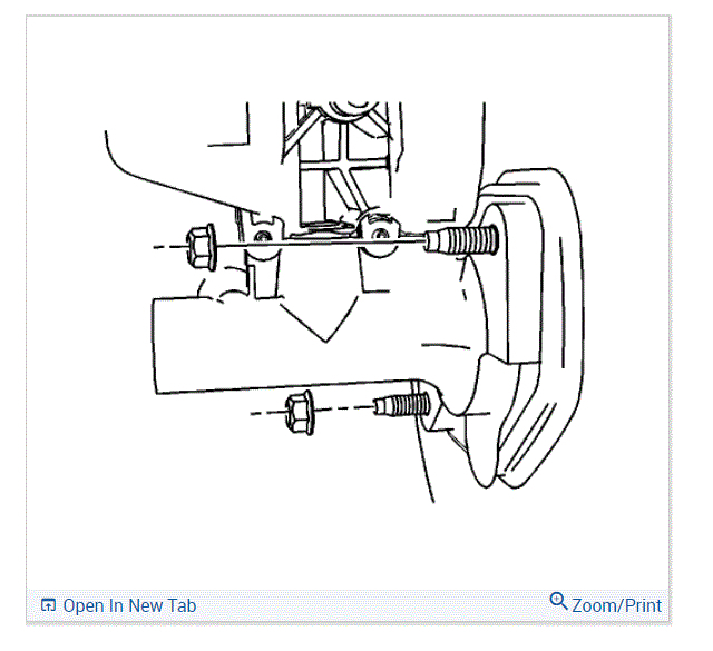

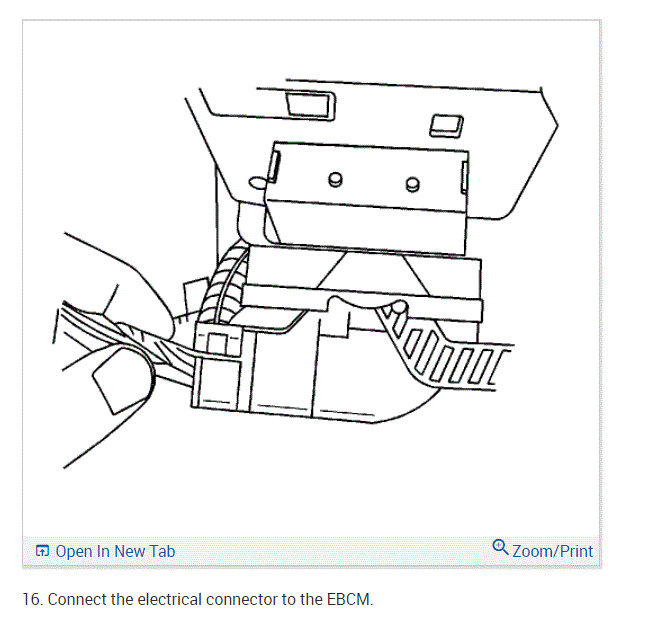

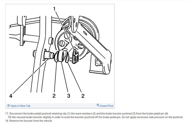

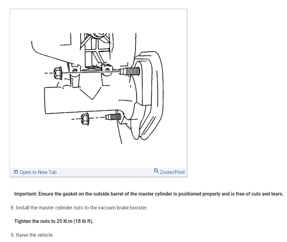

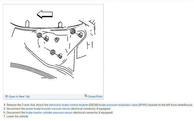

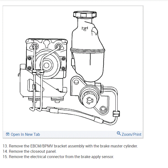

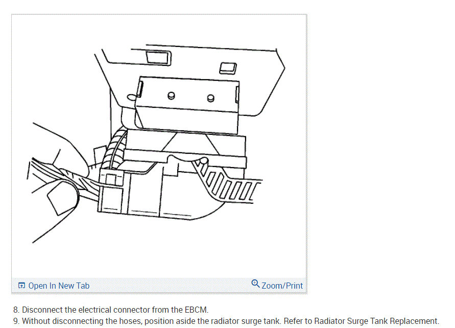

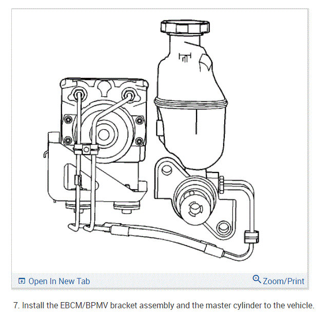

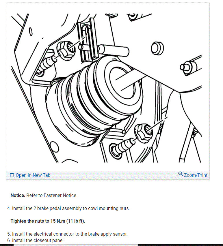

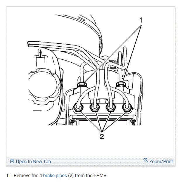

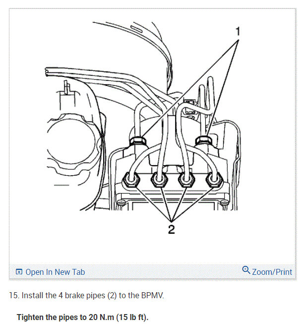

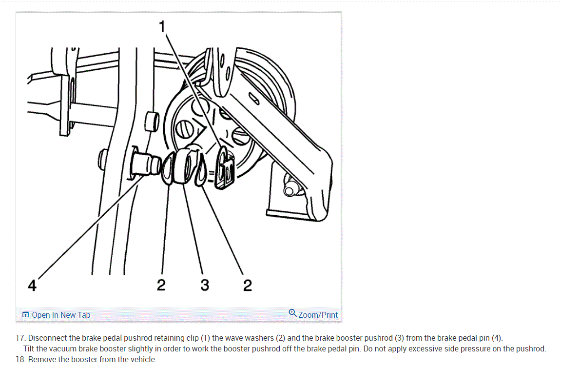

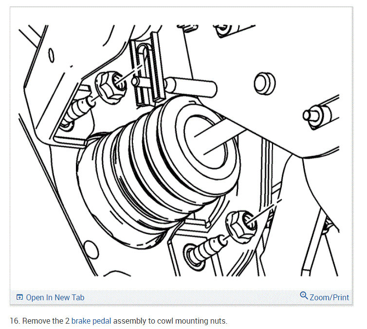

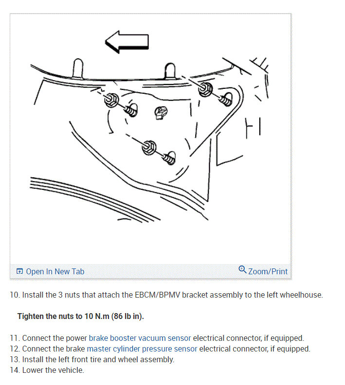

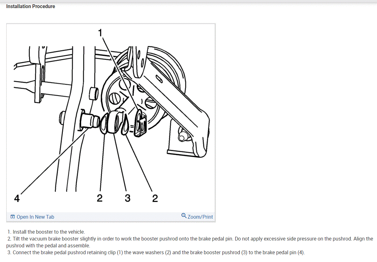

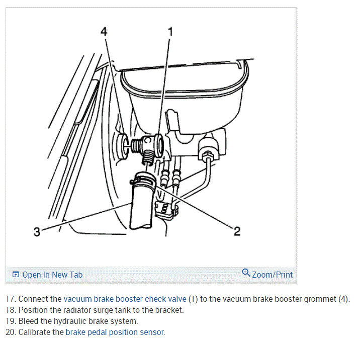

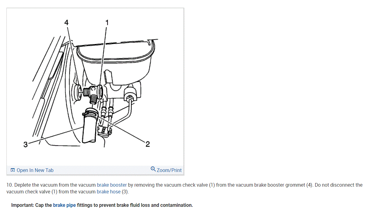

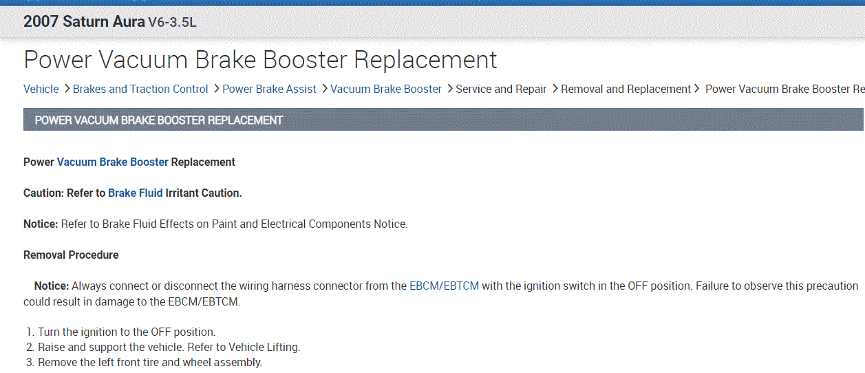

Replacing the vacuum brake booster isn't a bad job. It will require that you first remove the brake master cylinder, but that isn't too hard. The worst part of the job is working under the dash to unbolt the booster. It gets a bit tight. LOL
Regardless, if you look at the attachments below, they include the directions and pictures specific to your vehicle for replacement.
