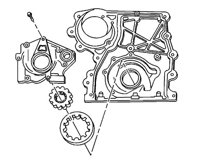

Do you know the bolt pattern and torque specs for the oil pump/timing chain cover?
Jun 30, 2020 at 11:37 AM
Good afternoon,
I attached a picture for you to view.
They do not list a sequence of tightening the bolts, just a torque.
2. Install the oil pump pressure relief valve plug.
Tighten the oil pump pressure relief valve to 14 Nm (124 in. lbs.).
3. Install the oil pump outer and inner gears as removed.
4. Install the oil pump cover.
5. Install the oil pump cover bolts.
Tighten the oil pump cover bolts to 10 Nm (89 in. lbs.).
