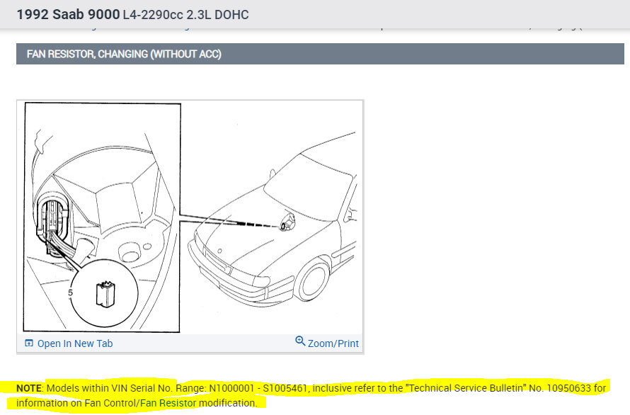

I have a UK spec vehicle listed above CD Turbo. When I try to run the A/C or heating, the four-option selector knob only works on the fourth (highest) setting and it makes an incredibly loud noise. I have taken it to a mechanic shop here and they believe it is either the blower motor or the blower motor resistor/speed regulator? I am trying to figure out how to fix the issue and get my car's A/C heating to work on any speed and not make a worrying noise the entire time. I don't know where to check to locate my blower motor/blower motor resistor on the vehicle and before I can even see if the part still exists anywhere, I want to make sure I have the right part # for the vehicle. Any help with this issue would be appreciated.

When the blower motor only runs on high, it is usually the resister. The idea that it makes a lot of noise may indicate the blower motor is failing. That could be the cause of the resister failure.
I don't have the specs for the UK model you mentioned, but they should be either the same or very similar. Of course, it may be on the opposite side of the dash. LOL
I attached the directions below for removing and replacing the resistor that I have. Again, they should be very similar.
See pics below. Note what I highlighted in pic 1 and let me know if relates to your vehicle.

Thank you, this definitely helps! I will likely disassemble the components blocking access to the blower motor, and then replace the resistor and the blower motor itself.
