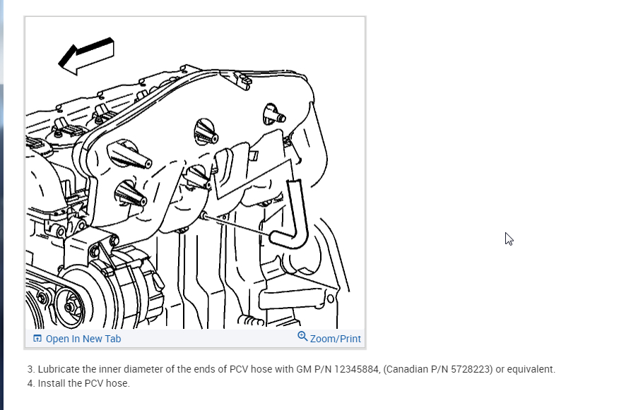

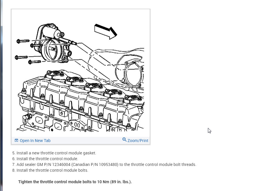

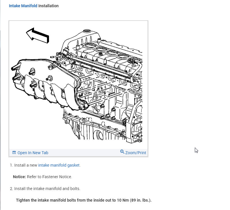

Do you know if there is a bolt pattern and torque specs for the intake?
Jul 11, 2020 at 4:18 AM
I attached the process. There is no pattern but I would suggest starting on the inside bolts and working to the outside. These are individual runners so when you tighten one, it doesn't really affect the others.
Let us know if you have other questions. Thanks
