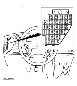

After reading my obd codes they instructed me to replace my o2 sensors. Both came up with a "slow circuit response" code. I put two new Bosch universal sensors in. It cleared the first code but now I have a heater circuit malfunction code. P0141 and p0135 I beleive. What does this mean? Is there a certain type of o2 sensor I need?

Start by checking fuse #38 in dashboard fuse box ?
DTC P0135: FRONT HEATED OXYGEN SENSOR (HO2S-1) PREHEATING
With ignition off, connect TECH 2 scan tool to DLC. Turn ignition on. Contact TRIONIC 5 OBD II. Check for stored DTCs. If DTC P0141 has not been set, go to step 3 . If DTC P0141 has been set, check fuse No. 38 in dashboard fuse block. See Fig. 6 . If fuse is defective, replace fuse and go to step 5 . If fuse is okay, connect SST 86 11 857 test light (or equivalent) between upper terminal of fuse No. 38 and ground. Go to next step.
Use scan tool to select ACTIVATE: MAIN RELAY. If test light does not flash, repair faulty circuit between fuse No. 38 and crimped connector J76 (Grey/Red wire). See appropriate wiring diagram in WIRING DIAGRAMS article. If test light does flash, turn ignition off for at least 5 minutes. Unplug HO2S-1 and HO2S-2 connectors. Use DVOM to measure resistance between HO2S connector terminals No. 1 and 2 (both White wires) on each sensor. See Fig. 5 . Both readings should indicate 1.8-4.0 ohms. If either sensor value is not as specified, replace faulty HO2S sensor. See HO2S SENSORS under ENGINE SENSORS & SWITCHES in REMOVAL, OVERHAUL & INSTALLATION article. If both sensor values are as specified, check for faulty circuit between fuse No. 38 and HO2S harness connector terminals No. 1 of each sensor (Grey/White wire). Repair as necessary. Go to step 5 .

https://www.2carpros.com/forum/automotive_pictures/266999_saab_5.jpg
