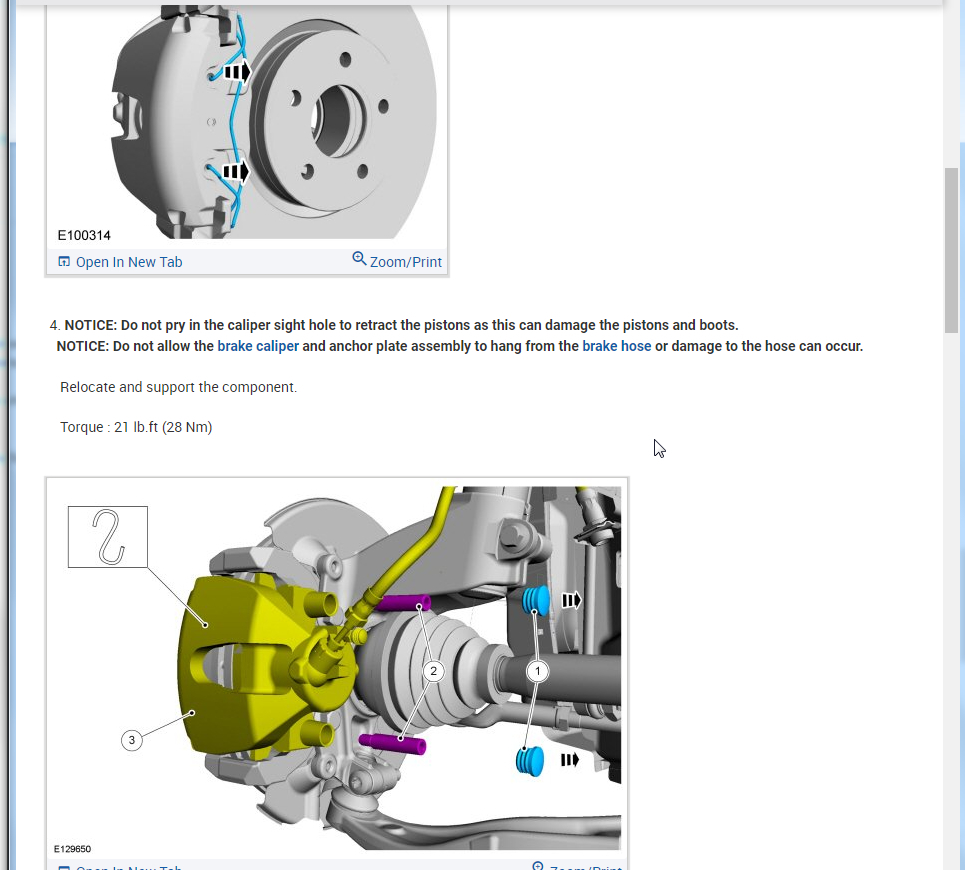

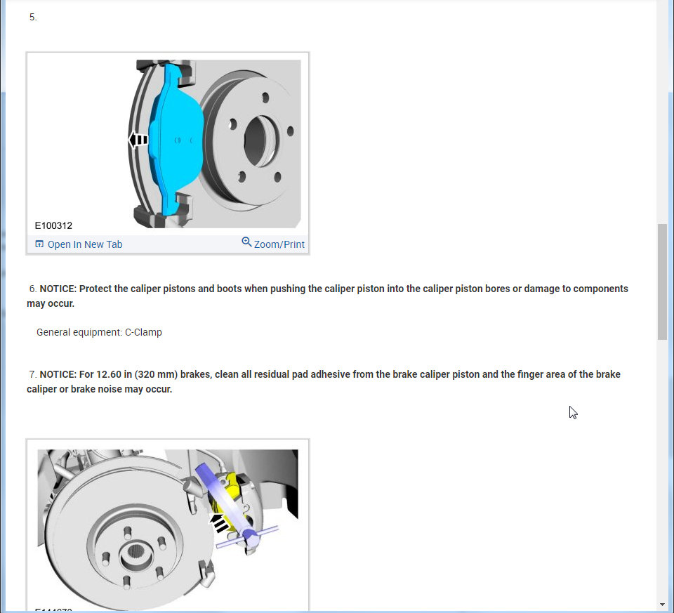

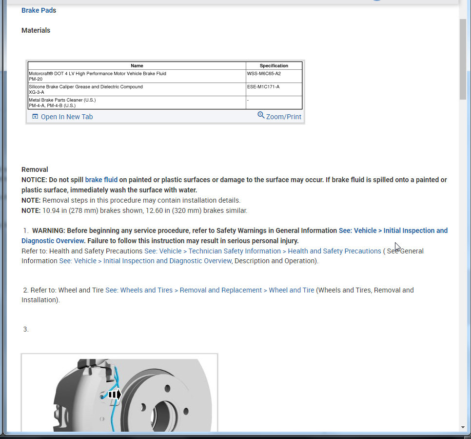

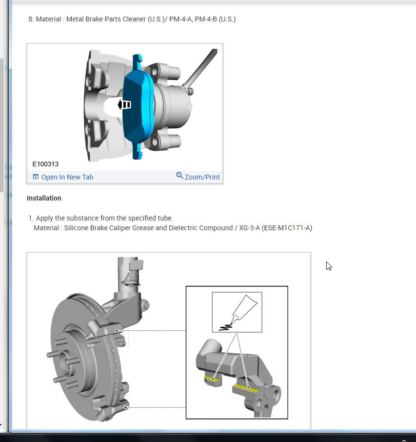

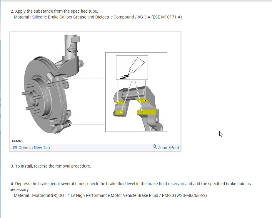

More then likely this is the front pads wear indicators or the rattle clips are making noise. Here is a guide that will help with this:
https://youtu.be/_iFN5xaJjJY
and
Below you will find the process from the manual on how to replace them. Let's run through this and go from there. Let us know if you have other questions. Check out the diagrams (Below). Please let us know if you need anything else to get the problem fixed.
