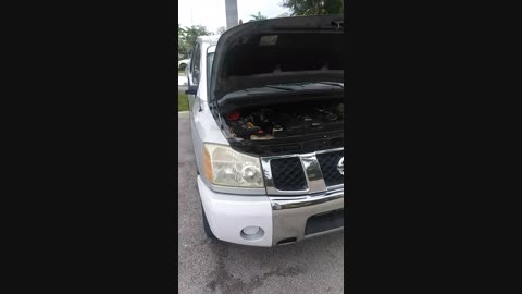

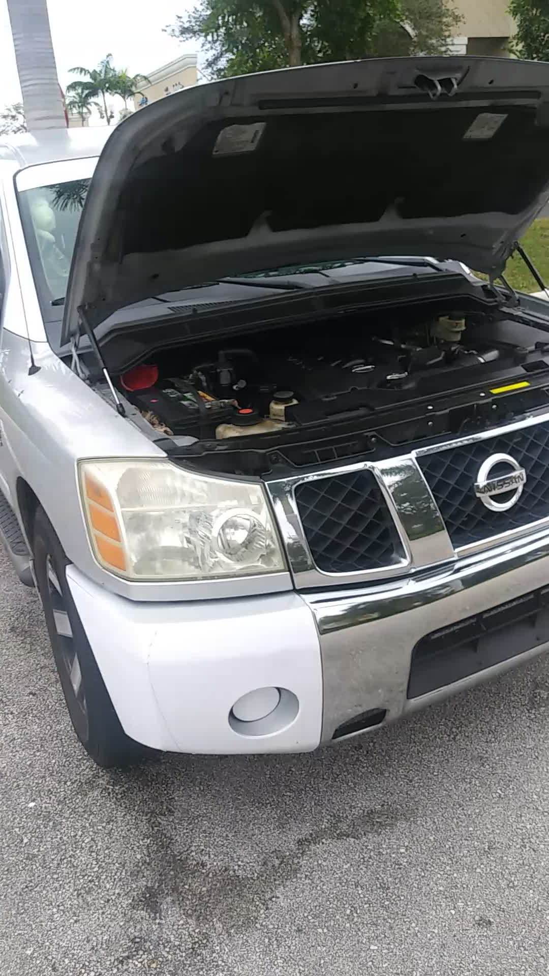

Hello again Ken and team,
I did come up with another question/issue please.
I am including a video to help show what I mean.
I cannot find any schematics showing what wiring system is just in front of the passenger seat in the motor compartment.
I checked connections with a testing light and one came up bright and another one very dim or even blinking.
My code reader still gives me a p0335 generic. Crankshaft position sensor "A" circuit
and manufacturer control.
if you could help me decipher what the wiring connection is in front of the passenger area by the motor that would be a great help.

Hi Paul,
Can you please take this question and start a new thread so the subject matter is not mixed please? Include the video.
