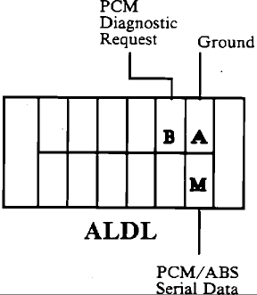

Try to see if there are any codes in the computer. Under the driver side dash there will be a connector. I posted image below. Get a paper clip. With the engine off jump pins B and A by inserting paper clip one end on B and other end at A. Turn the key on engine off and count the flashes. Here is the procedure.
Accessing codes:
The code(s) stored in the PCM's memory can be read either through a hand held diagnostic scanner plugged in the ALDL connector or by counting the number of flashes of the 'service engine soon" telltale lamp when the diagnostic terminal of the ALDL connector is grounded. The ALDL connector terminal "B" (diagnostic terminal) is the second terminal from the right of the ALDL connector's top row. The terminal is most easily grounded by connecting it to terminal "A" (internal PCM ground), the terminal to the right of terminal "B" on the top row of the ALDL connector.
Once terminals "A" and "B" have been connected, the ignition switch must be moved to the "on" position, with the engine not running. At this point, the "service engine soon" telltale lamp should flash code 12 three times consecutively. This would be the following flash sequence: Flash, pause, flash-flash, long pause, flash, pause, flash-flash, long pause, flash, pause, flash-flash. Code 12 indicates that the PCM's diagnostic system is operating. If code 12 is not indicated, a problem is present within the diagnostic system itself.
If you want to record it and post it on here I can count the flashes to get the trouble codes if there are any stored.

Thank you, My husband did this and the only code other than the 12 that flashed was 23 which he said was some kind of Air sensor, he knew was damaged 2 years ago. No other flashed.

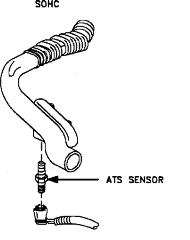

Code 23 is the air intake sensor shorted or disconnected which will cause the problem you are describing.
Here is the sensor location so you can check it out.
Also this guide may help as well.
