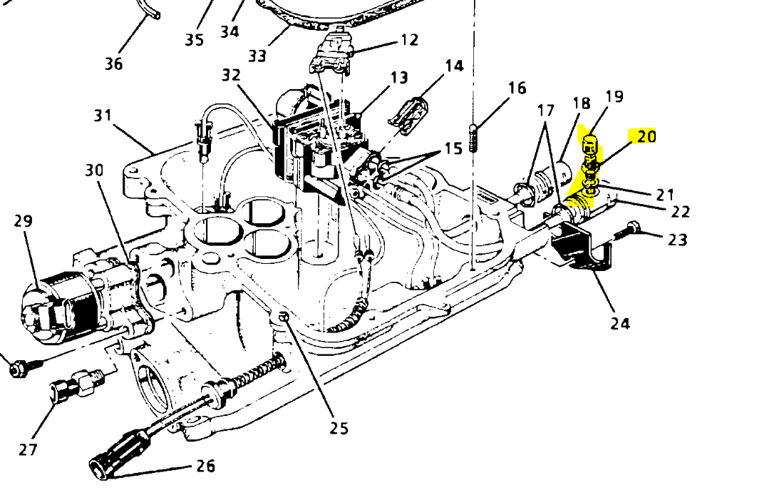

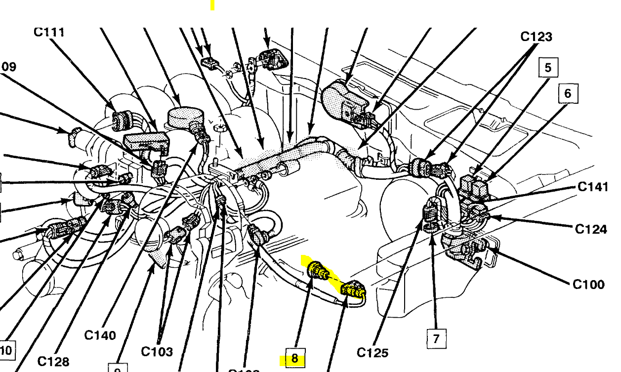

Was running just fine then started running really rough and all of a sudden. Shows code 24,43.

Also I can’t find the knock sensor to save my life 4.3 v6.

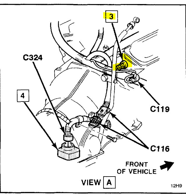

As far as the knock sensor location, there are two. On the left side of the vehicle (driver's side) it is on the side of the cylinder head. See pic 1. There is also one on the rear of the right cylinder head. It is on the rear of the head. See pic 2.

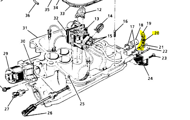

The air intake temp sensor is front center (intake) see pic 3. I feel confident you already know the description of the codes, but here they are.
23 Air intake temperature sensor
43 Knock sensor
Let me know if this is all you needed or if you have other questions. I will tell you that a knock sensor issue will usually cause a valve noise or engine noise because they are responsible for maintaining proper ignition timing. The IAC, on the other hand, is most likely the cause of the rough idle, if you aren't hearing any engine noise.

It’s showing 24 and 43 on codes. It has no engine noise really but runs rough idling and driving and backfires. Cuts out when applied more gas.

The knock sensor on the driver side between the two spark plugs? Also have no wire or nothing connected to it. Seems to have been that way for awhile?

IAC stands for idle air control. It is an electric motor that allows air to enter the engine at idle when the throttle plate is closed and is responsible for maintaining the engine idle speed.
Since you have a backfire, I would be checking the fuel pressure. It may be too high.

Do you think it’s the knock sensor? It’s cuts out really bad too.

Anything is possible. The knock sensor is what fine tunes ignition timing to prevent valve knock. It is possible that it is throwing things off. However, I would think it is ore related to a fuel issue or the intake air temperature sensor.

It backfires from the intake also? What should I change if it's getting to much fuel? I think that's the problem.

If too much fuel is the issue, it can be one of three things, high fuel pressure, a bad coolant temp sensor, or faulty fuel injector.
Here is what I suggest. First, check fuel pressure to confirm it is high (beyond the manufacturer's specs). Here are the manufacturer's specs. Also, if you look at pic 1, I highlighted the test port for checking pressure.

Next is an engine coolant temp sensor. It is located on the front top of the engine. See pic 2. Now since this is an OBD1 system, you can check for diagnostic trouble codes, but chances are this problem won't show up. What can happen is the sensor indicates extremely cold temps. As a result, the computer makes the air / fuel mixture extremely rich to run the engine. Although the sensor sends an inaccurate reading, the computer doesn't know it's wrong, so a code may not show up.
