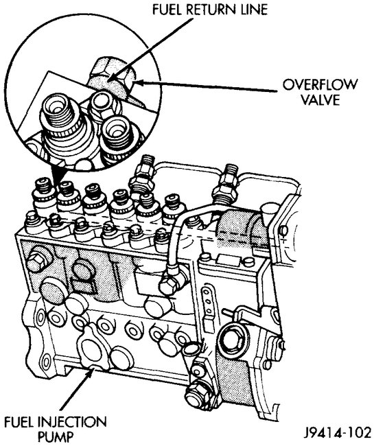

Injection Pump Overflow Valve
pic 1
A sticking check valve within the overflow valve may cause low power. Refer to the Fuel Transfer Pump Pressure/Capacity Test. Overflow valve testing is covered in this test.
Whenever the fuel injection pump is being replaced or removed for calibration, the overflow valve must stay with the pump. Make sure a new overflow valve is used with a new or rebuilt injection pump and the old (original) overflow valve is returned to authorized repair facility with the old injection pump.
Fig. 18 Installing Special Tools
pic 2
Make sure the overflow valve is correctly installed at the fuel return line (pump outlet) (Fig. 18) and not incorrectly installed at the fuel supply line (pump inlet).
May 6, 2020 at 1:26 PM

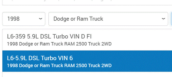

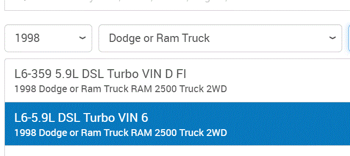

Can you do me a favor? Can you check the engine code in the VIN? I want to make sure I have the exact one. I need to know if it is VIN D or something different. See the attached picture.
I'm asking because when I look through the manual, it's showing a lift pump and injector pump. I can't find reference to one in the tank.
May 7, 2020 at 2:00 PM
CHAD ADAMS
There is a D in the eighth position of the VIN. Is this the position that you were referring to? Engine code D, It is a 5.9 Cummins Diesel engine. The truck was built in August of 1997 and sold as 1998 year model.
May 8, 2020 at 1:33 AM
  • 110,251 POSTS
That's it.

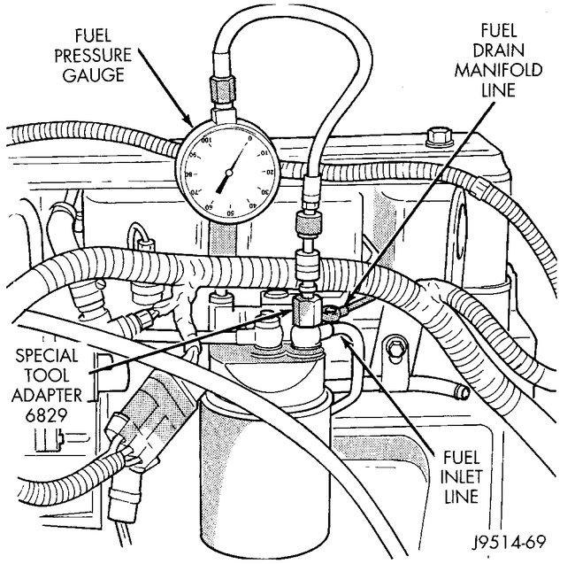

The purpose of the fuel transfer pump is to supply fuel to the injection pump. The transfer pump produces about 25 psi. Then, the low-pressure is raised by the fuel injection pump for operation of the high-pressure fuel injectors. The transfer pump is actuated by the cam.
Okay, I was reading and reading and reading, and then I saw this.
All aftermarket devices used to identify low fuel pressure are incompatible with the retrofit Electric In-Tank Transfer Pump and should be disregarded.
So, the idea that you feel there is a fuel pump in the tank makes sense if the transfer pump isn't working. Do me a favor, check pressure from the supply (transfer pump). It should be approximately 25 - 30 psi. I have a feeling someone has retrofitted it with an electric pump and the lift pump doesn't work. Ugh!!! This is only a theory at this point.
