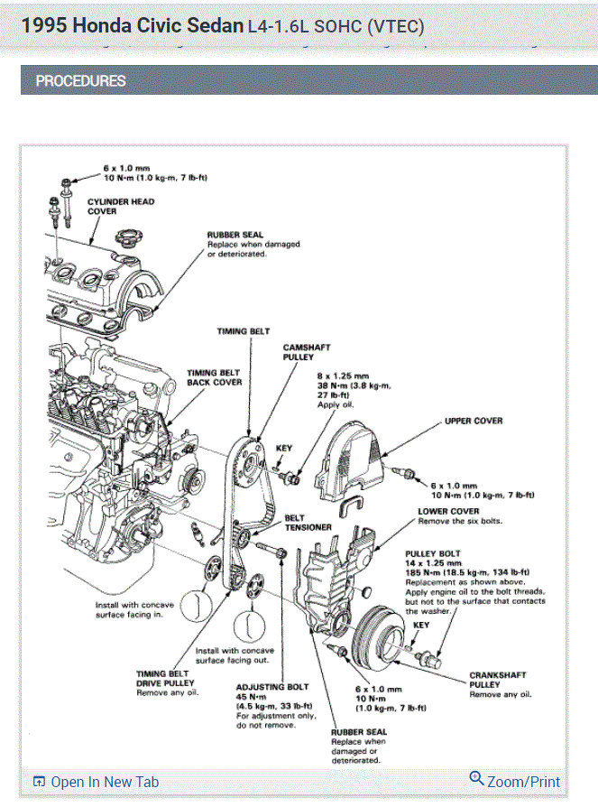

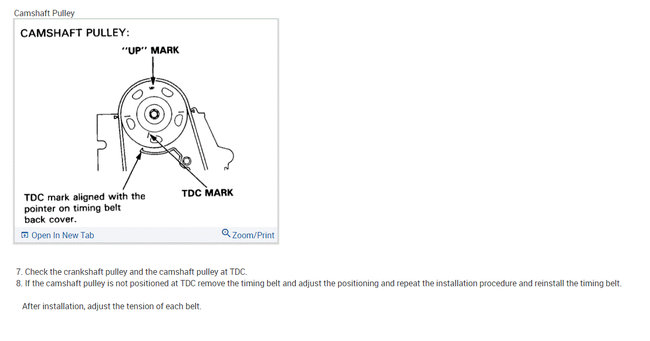

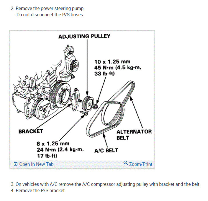

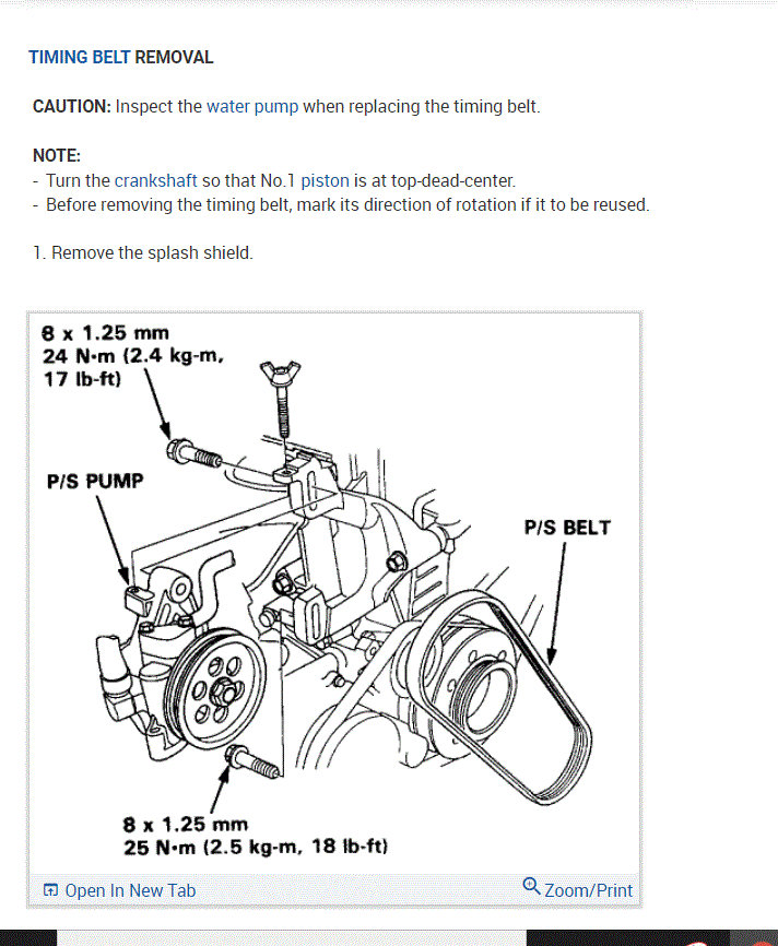

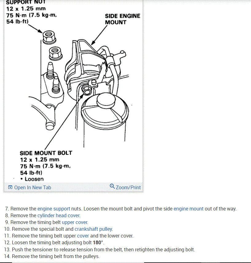

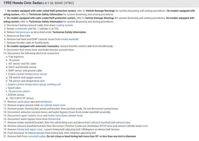

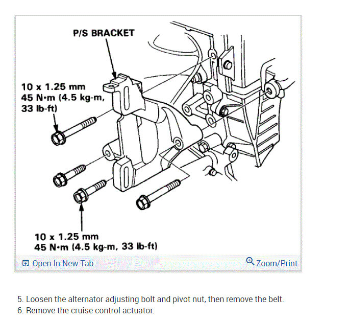

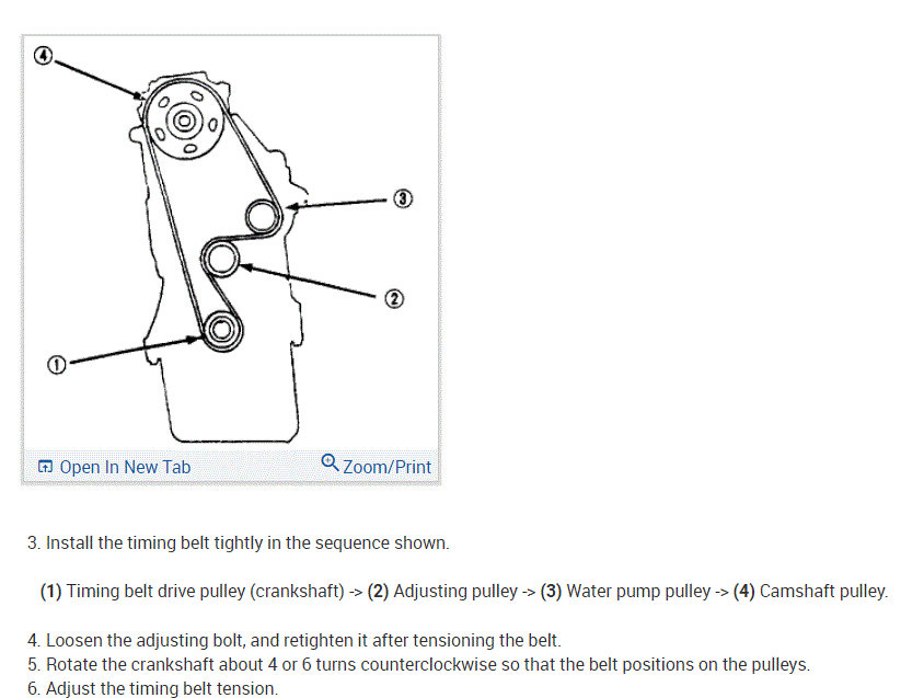

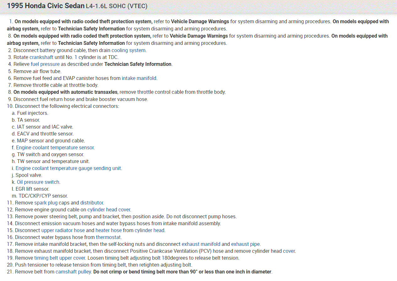

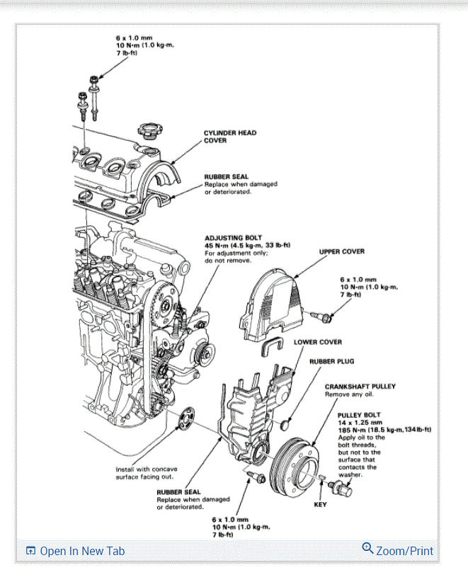

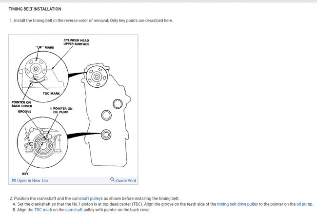

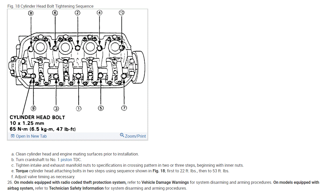

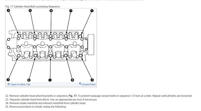

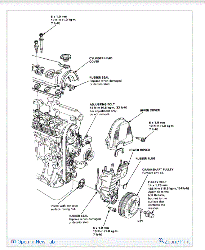

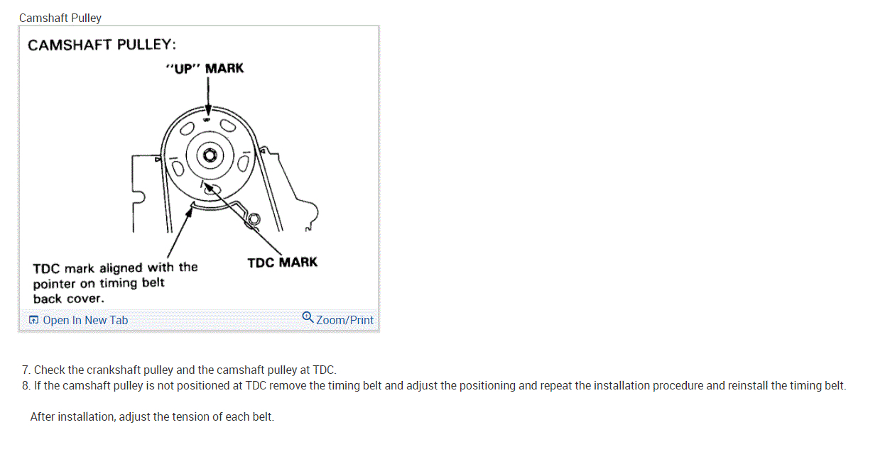

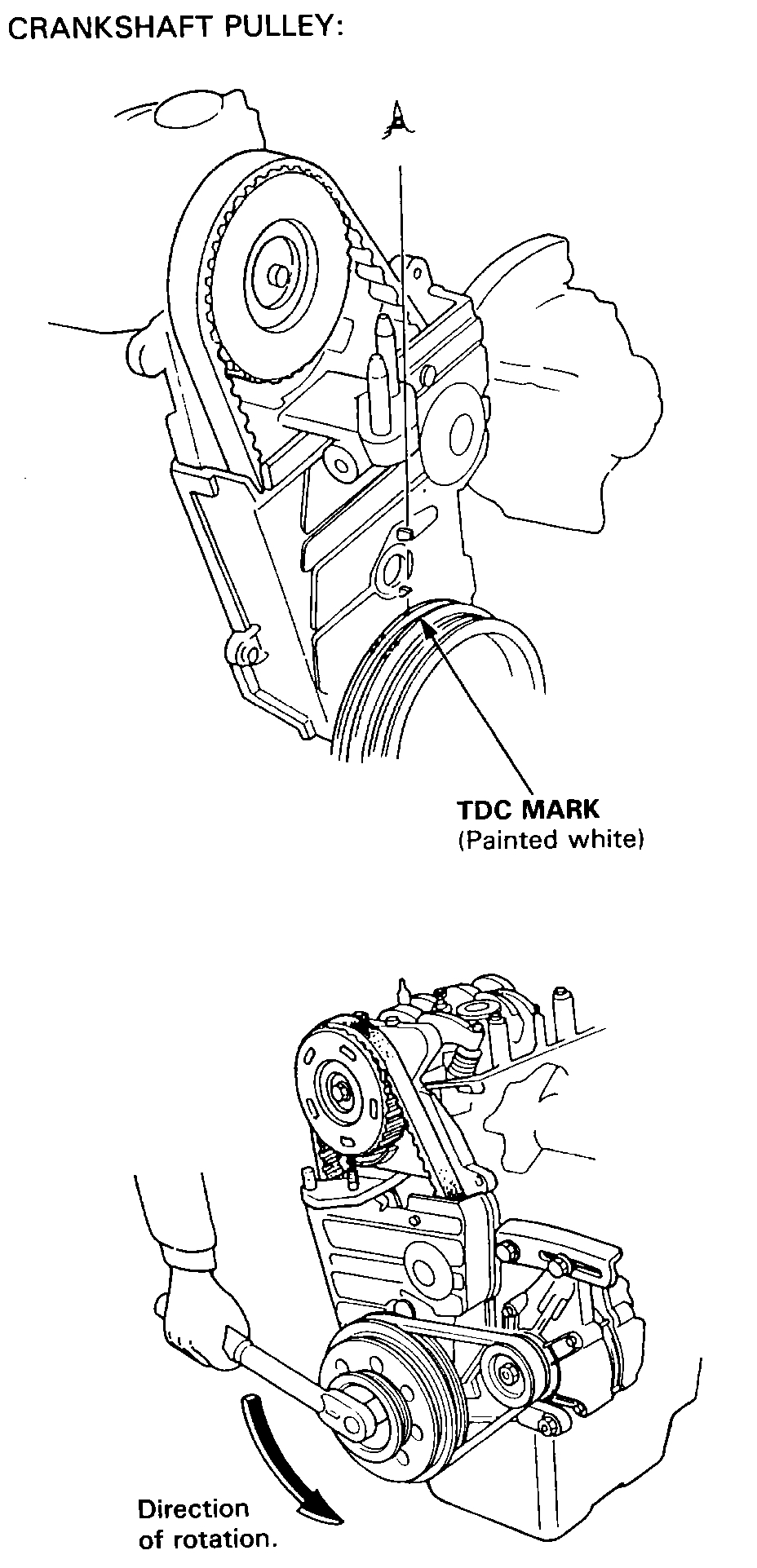

If we determine it is a head gasket, here are the directions for replacement. The pictures below show both the directions and pics for doing the job. Pics 1-3 show the removal and replacement of the cylinder head. You will also need to remove and replace the timing belt to remove the head. The remaining pics correlate with timing belt replacement. This is a good time to replace the belt and its components.
Check out the diagrams below. Let me know how this turn out for you.
