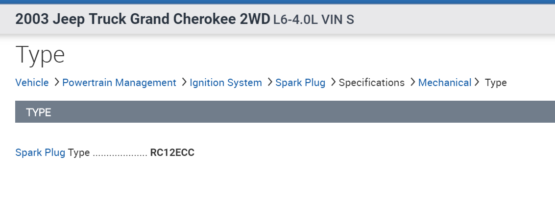

No codes set. turn off wait a few minutes try to restart runs rough it wont idle. removed key and then restart and it is okay. It keeps happening four or five times a week. never gets over 10 mpg either. Thanks for your help. you guys are great, so glad you are here.
Jun 24, 2019 at 9:33 AM
SCGRANTURISMO
  • 4,897 POSTS

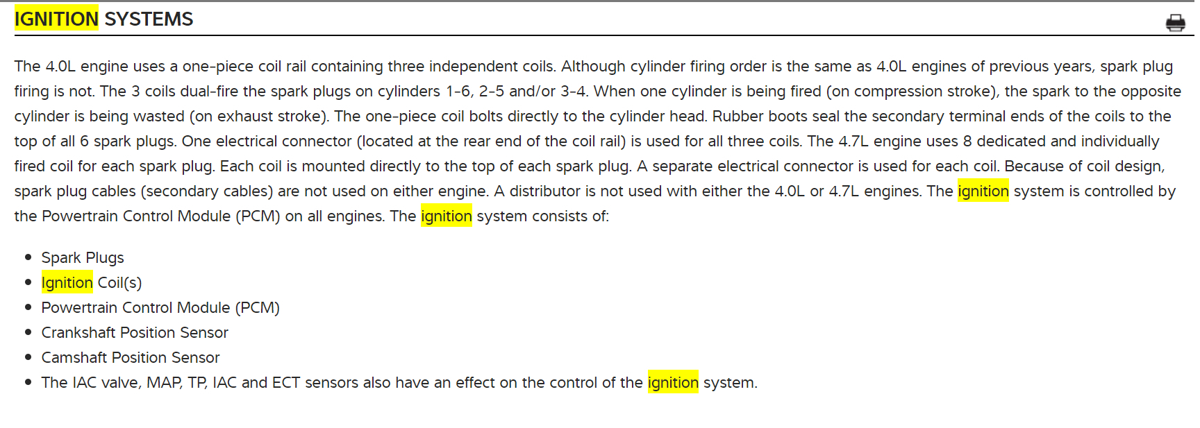

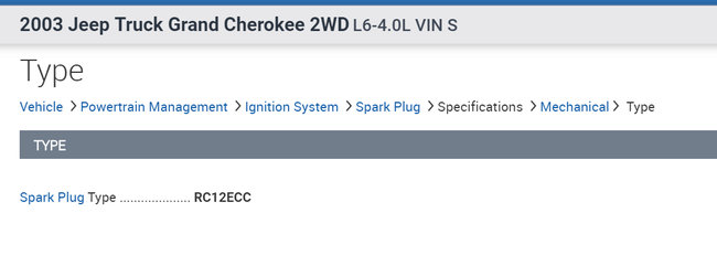

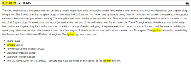

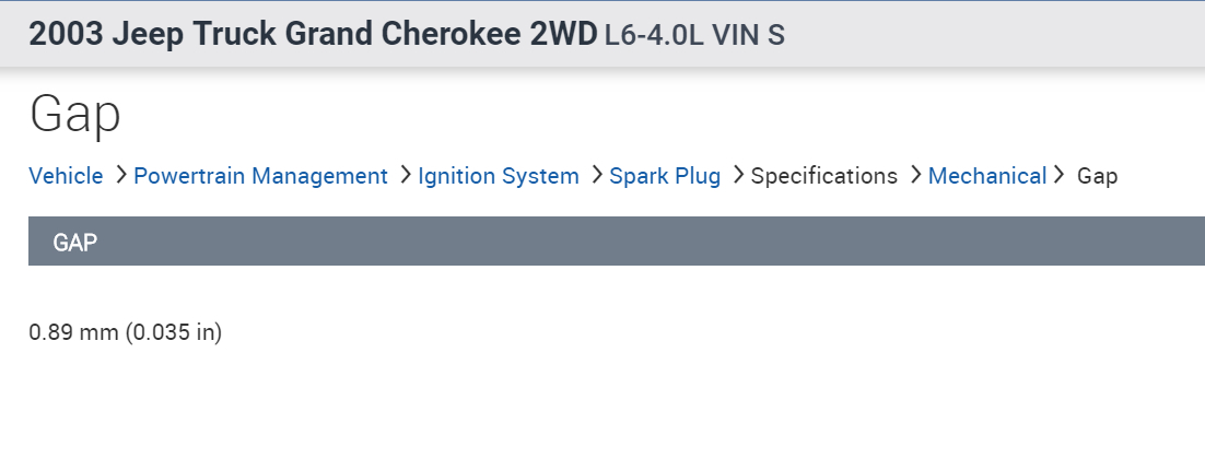

When was the last time that your vehicle had the spark plugs changed? This is what I would do first. In the diagrams down below I have included a description of your vehicle's ignition system as well as the type of spark plugs along with the proper gap for them. I have also included a link below for you to go to.
https://www.2carpros.com/articles/how-to-change-spark-plugs
Please go through these guides and get back to with how things turn out. There are other things to check as well, this is a good starting point.

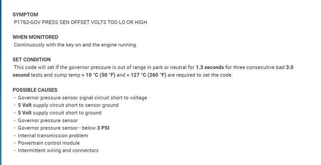

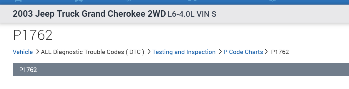

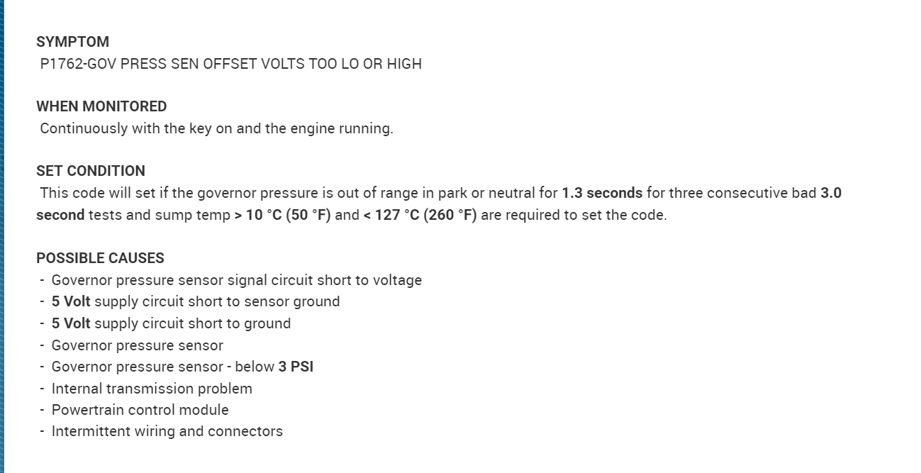

i put in rc12ecc plugs. seems to run okay,but check engine light came on and set p1762 code. did i cause that? and what is it? I turned the key on three times and it said done, then the light went out. will it come back on or should i have someone scan it? thank you for the help.
Jun 28, 2019 at 12:43 PM
JESSIE473
  • 24 POSTS
PS: i drove it about two miles and it did not turn back on.

i started it up this morning, the check lite came on. it ran like it had a miss. turned it off, took the key out then started it back up and light stayed out,and ran good. drove it about six miles and i was okay again.thanks again for your help.
Jun 30, 2019 at 3:08 PM
JESSIE473
  • 24 POSTS
today i drove it about 5 miles when i cranked it back up ,it ran rough and then shut off. i put it in park started it again ,it ran good again,it has done the same thing about every 50 miles i put in the factory plugs and it did run better. thanks for your help.

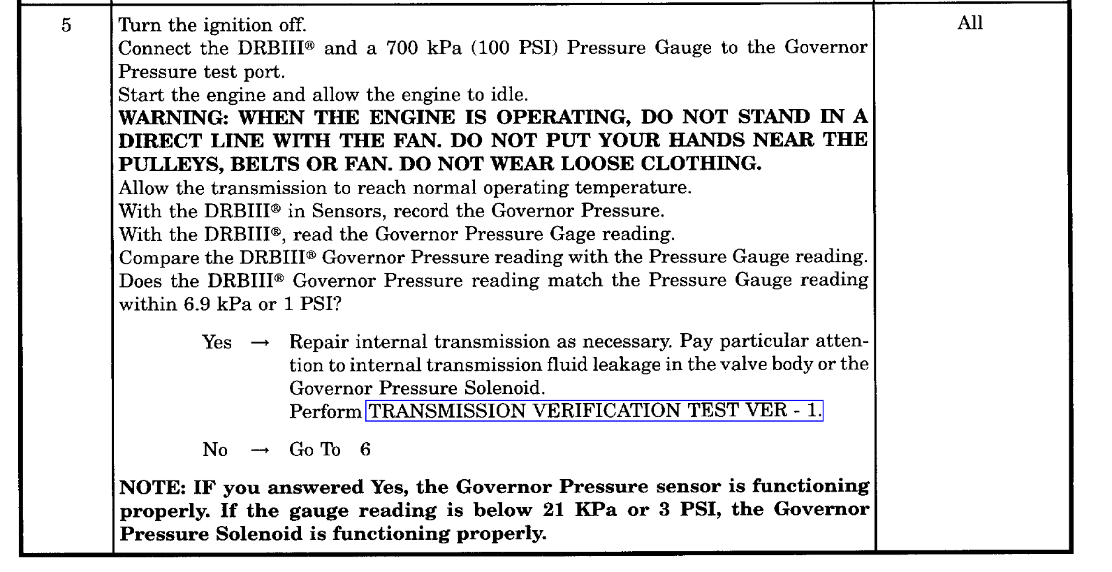

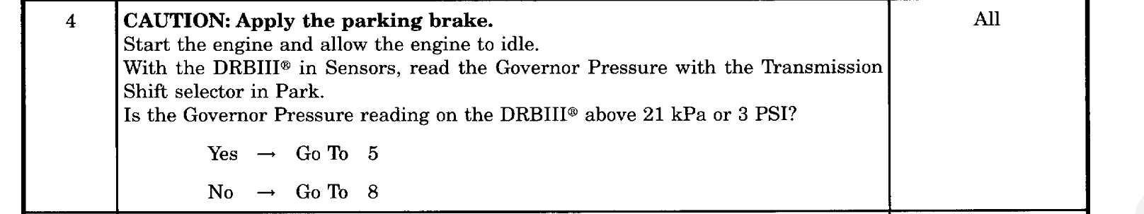

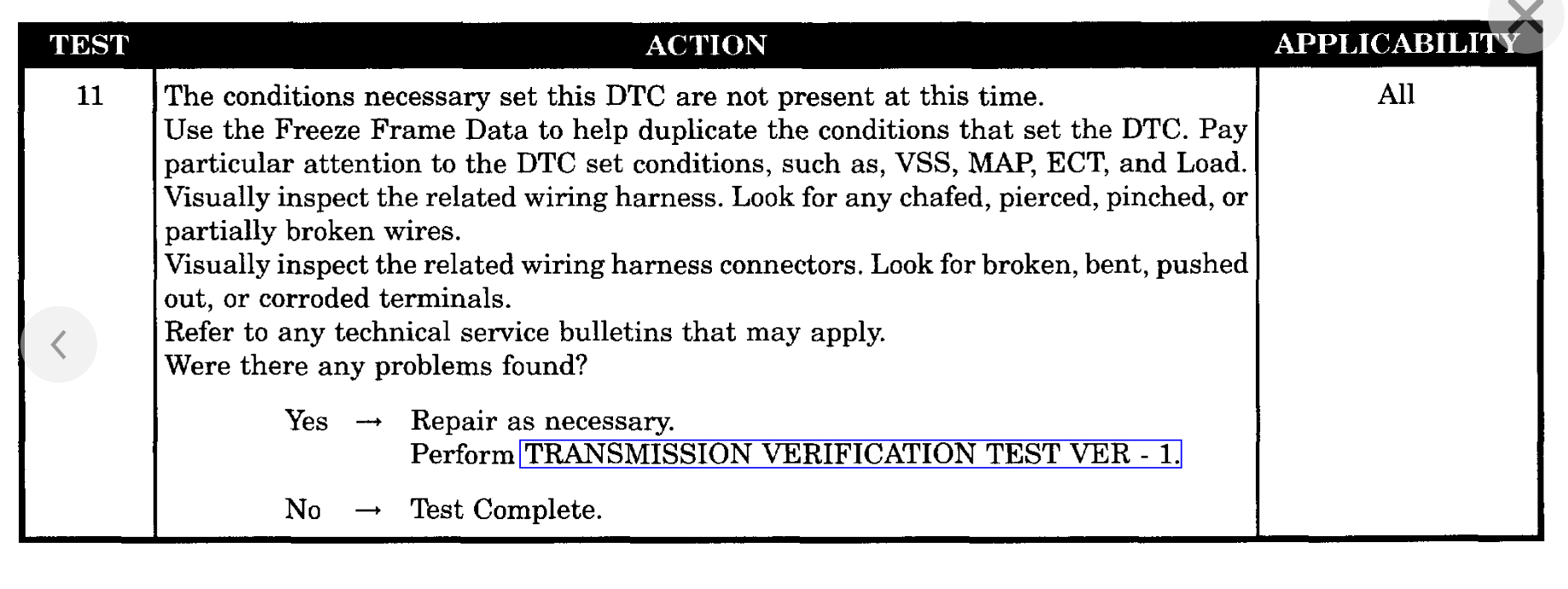

SCGRANTURISMO
  • 4,897 POSTS

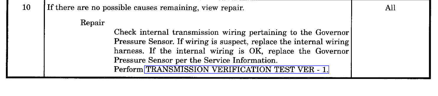

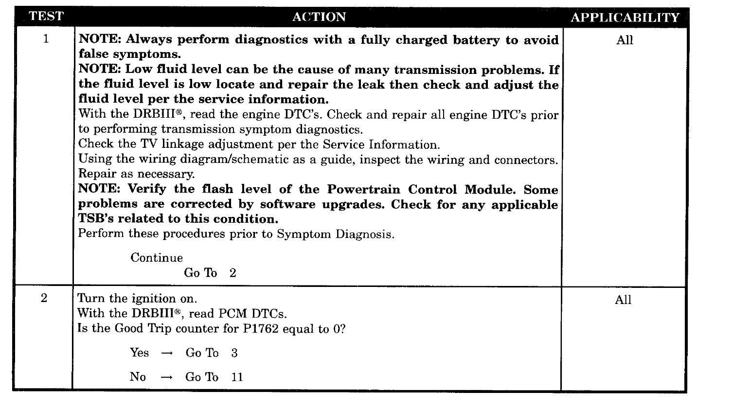

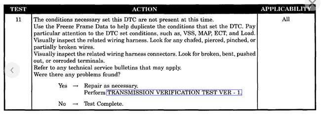

Hello again,

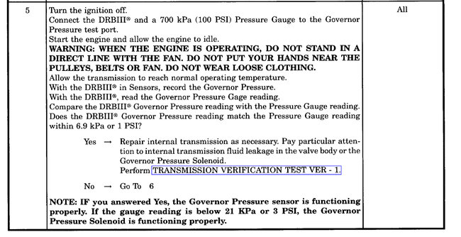

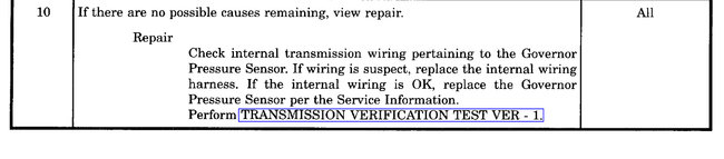

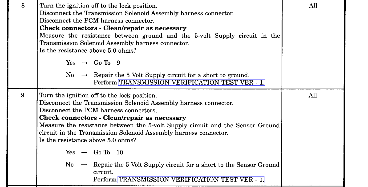

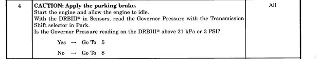

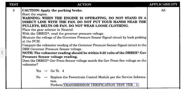

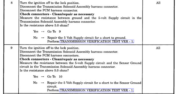

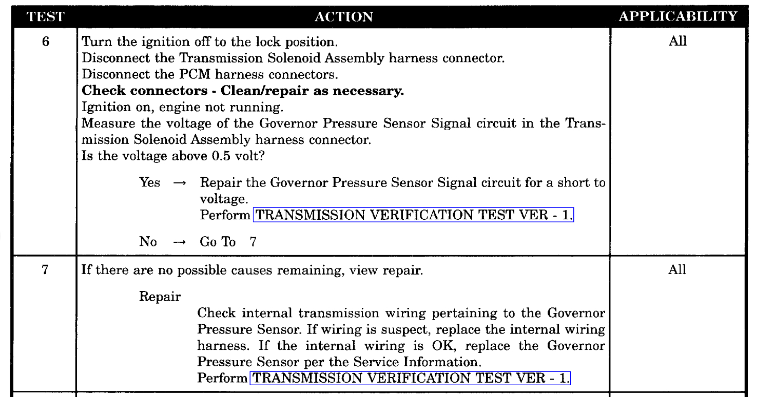

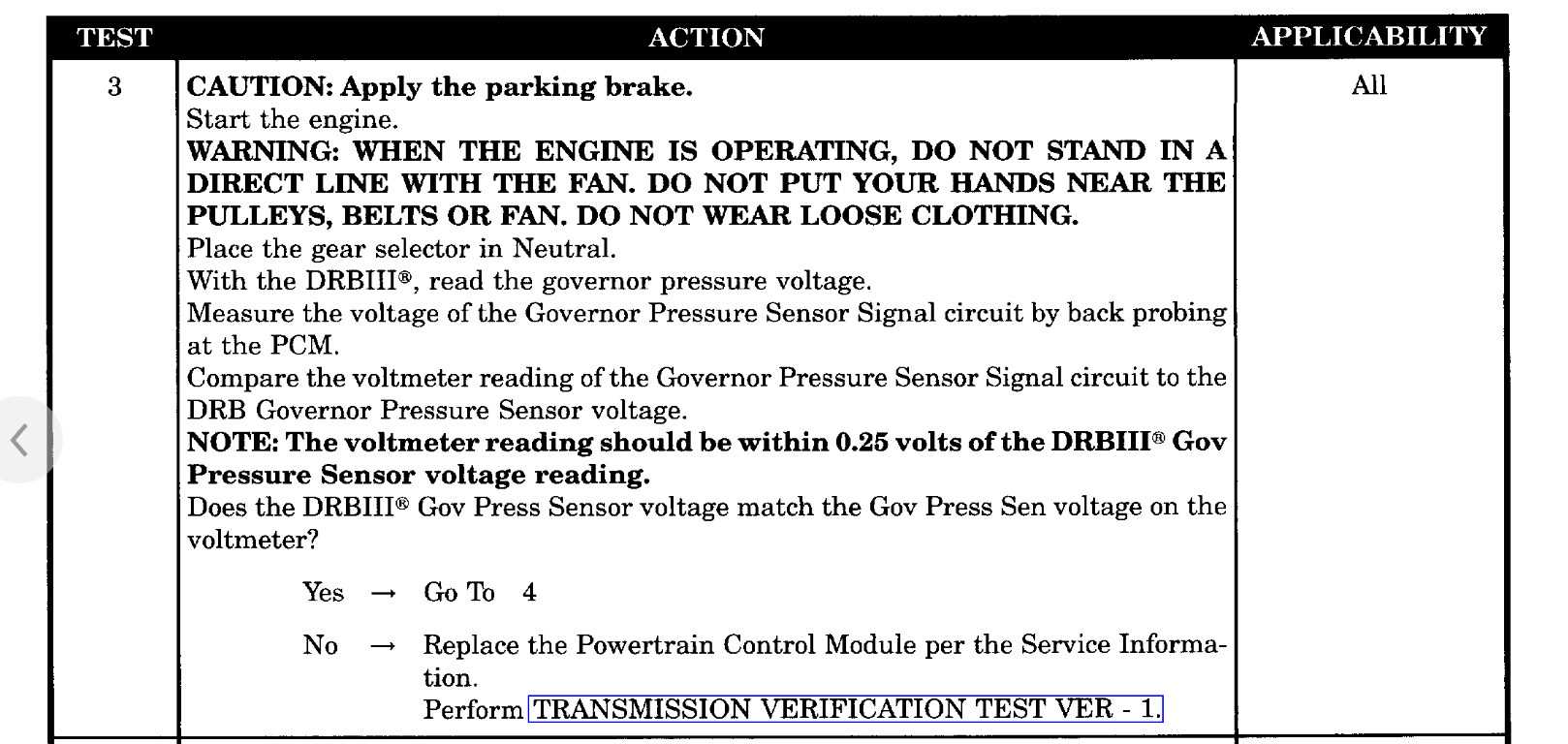

In the diagrams down below I have included the factory diagnostic troubleshooting guide for Direct Trouble Code (DTC) P1762. Please go through this guide and get back to us with what you are able to find out.
