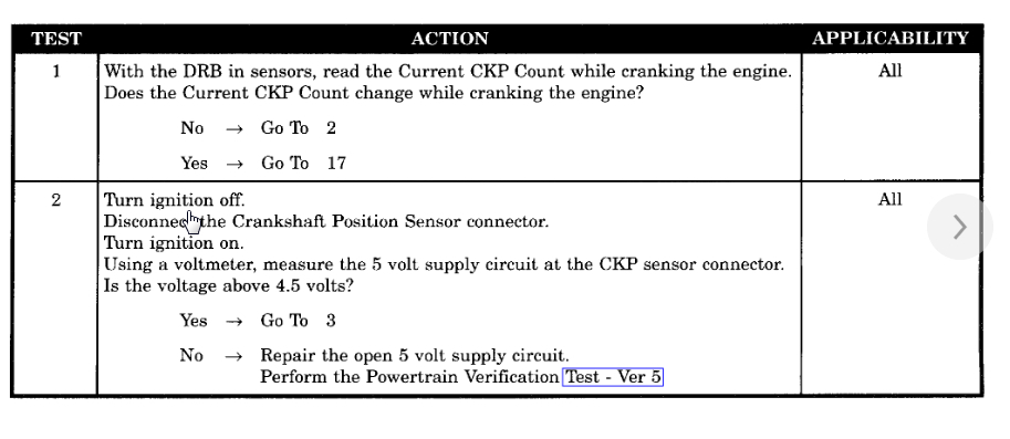

Runs fine until it gets to operating temperature. Then cuts out and chugs on like two or three cylinders, after it sits starts and runs great until warmed back up. just had replaced the cam sensor recently.

The CPS was installed two weeks ago, showing codes of 0320,0700,1494. no check engine light. when it cools it runs fine.

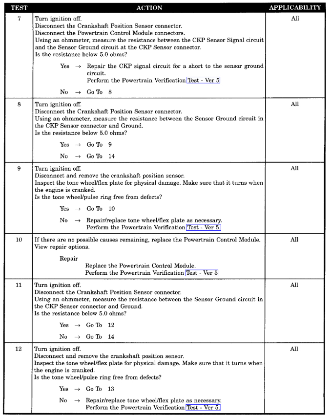

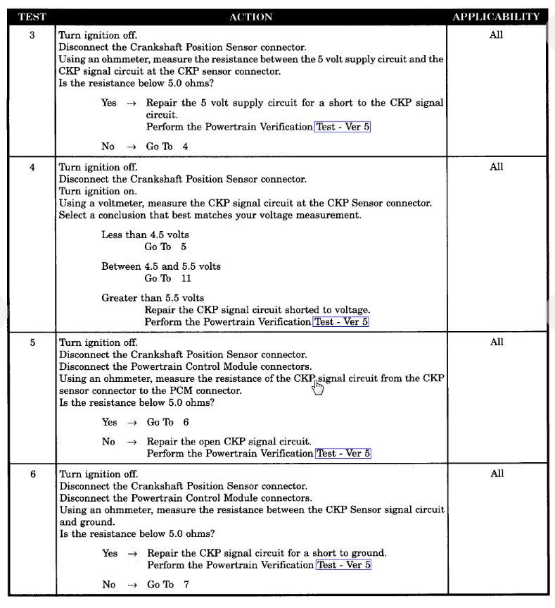

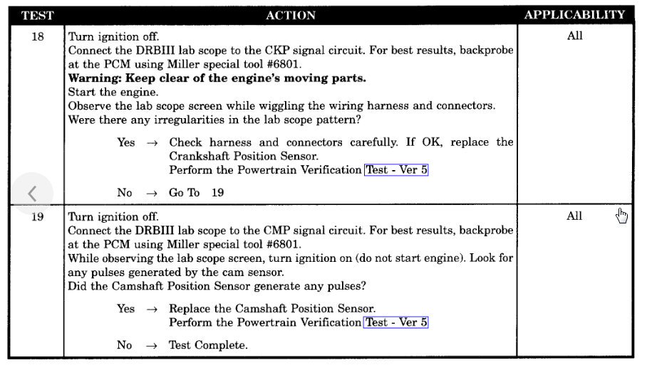

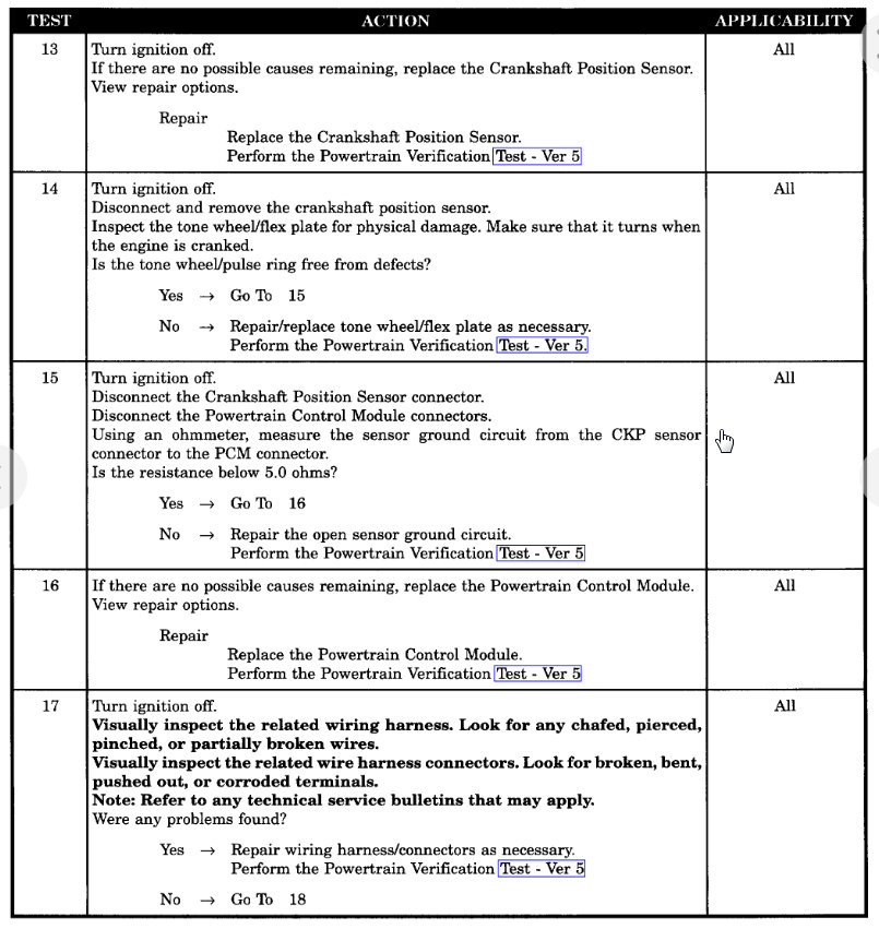

Okay. Are these the current codes or were these there when you installed the CPS? The P0320 is for the crank sensor. The P0700 is saying there is a transmission code. The P1494 is for the leak detection pump.
The crank sensor could be your issue. Here is the diagnosis test that you need to follow to figure it out.
As you will see in this guide, a crank sensor that is beginning to fail will act up when it is hot and then when it cools it works find.
