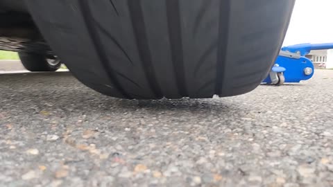

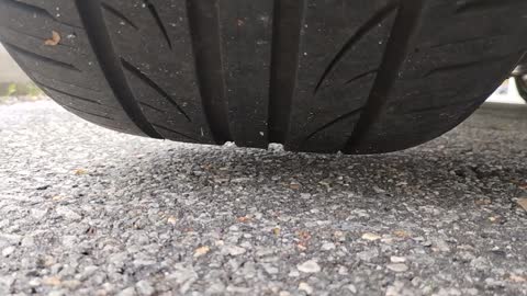

Not yet it's been raining heavily. It's nice out today so I'm going to do in a little. I'll report my findings once I do. I'm going to record it just in case the video catches something my eye is can see or missed.
May 1, 2023 at 3:26 AM

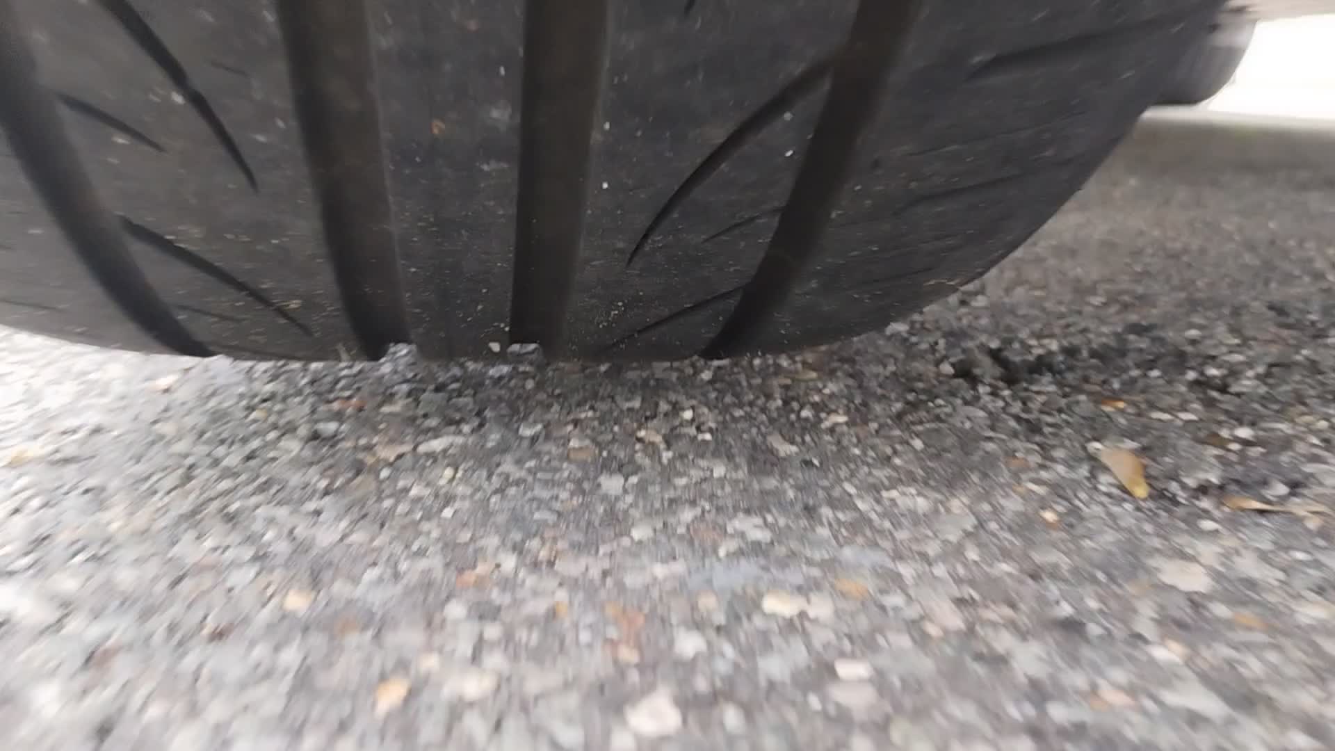

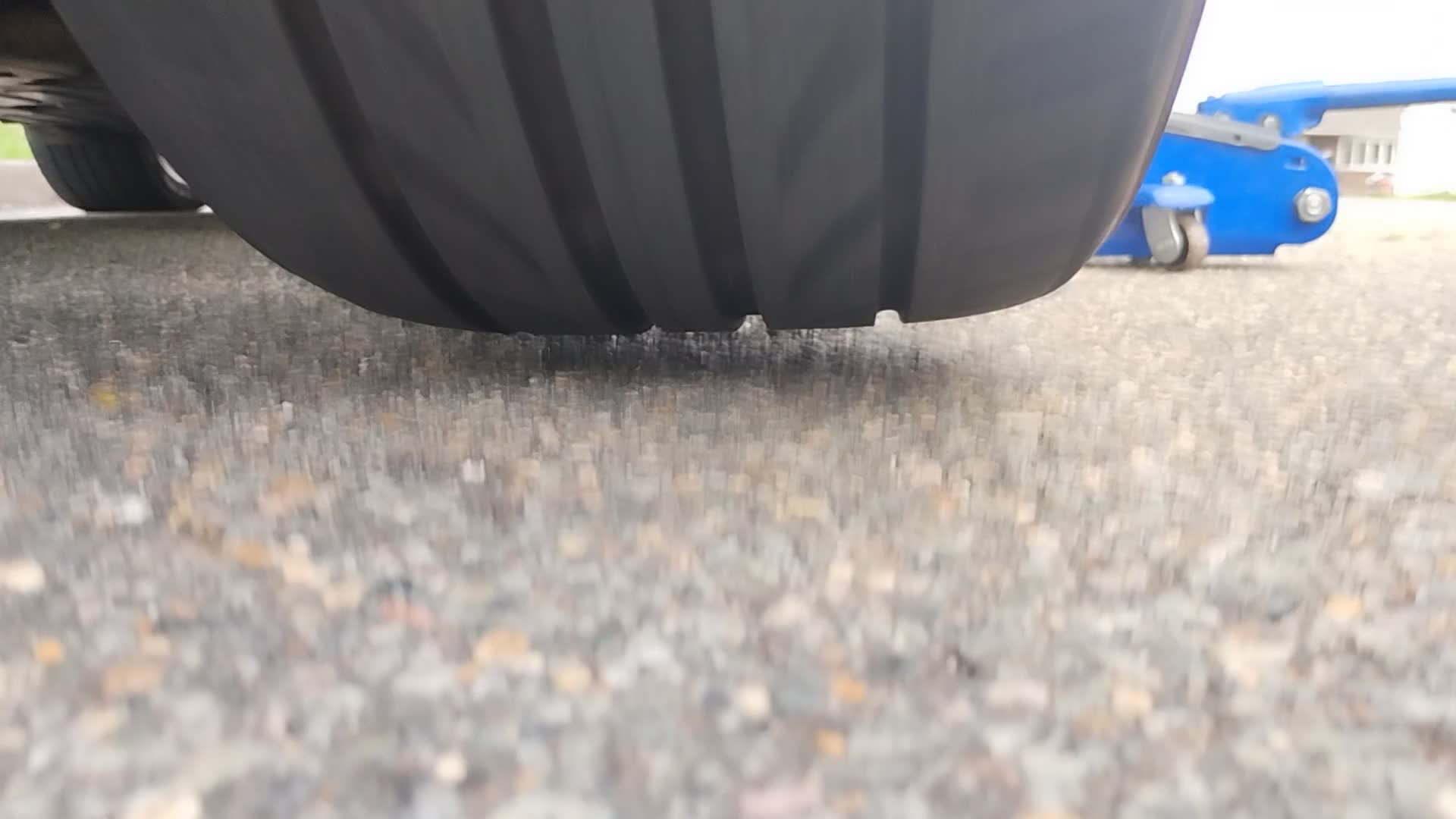

GENESIS88
  • 140 POSTS
The first video is passenger front second video is driver front. Both tires either have a small flat spot or damaged/broken belts causing tire to deforme. My rear tires are probably the same since I swapped my tires and there was no change. The tires while new where made in in 2010 so they probably have structure issue. I also noticed my front lower outer control arm bushings are bad along with my inner and outer upper control arm. I'm just going to go ahead and replace everything. Upper control arms, lower ball joint, lower front and lower inner control arm, sway bar links and wheel bearings and seals both sides. I plan on keeping car for another couple years so I think it's wise to do. I'm definitely replacing all my tires as well.
May 1, 2023 at 4:04 AM
  • 55,381 POSTS

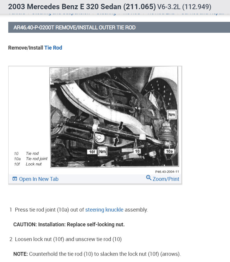

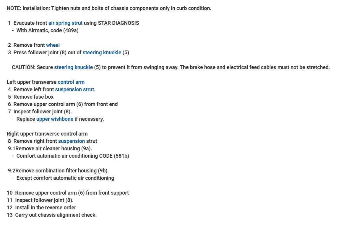

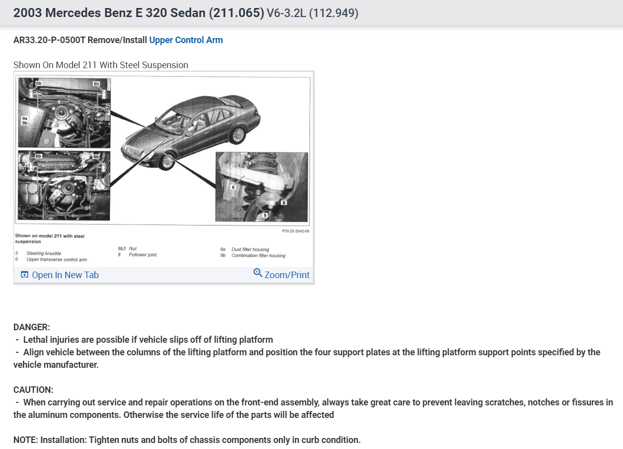

Thanks for the videos, it looks like the ties are okay. I think you were more on point with the front suspension issues. I would check the tie rod ends as well.
Here is a guide to help with that:
https://www.2carpros.com/articles/tie-rod-end-replacement

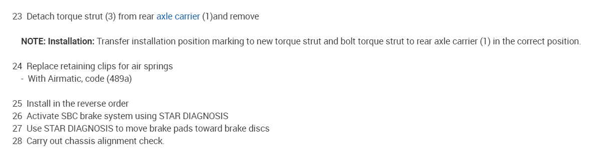

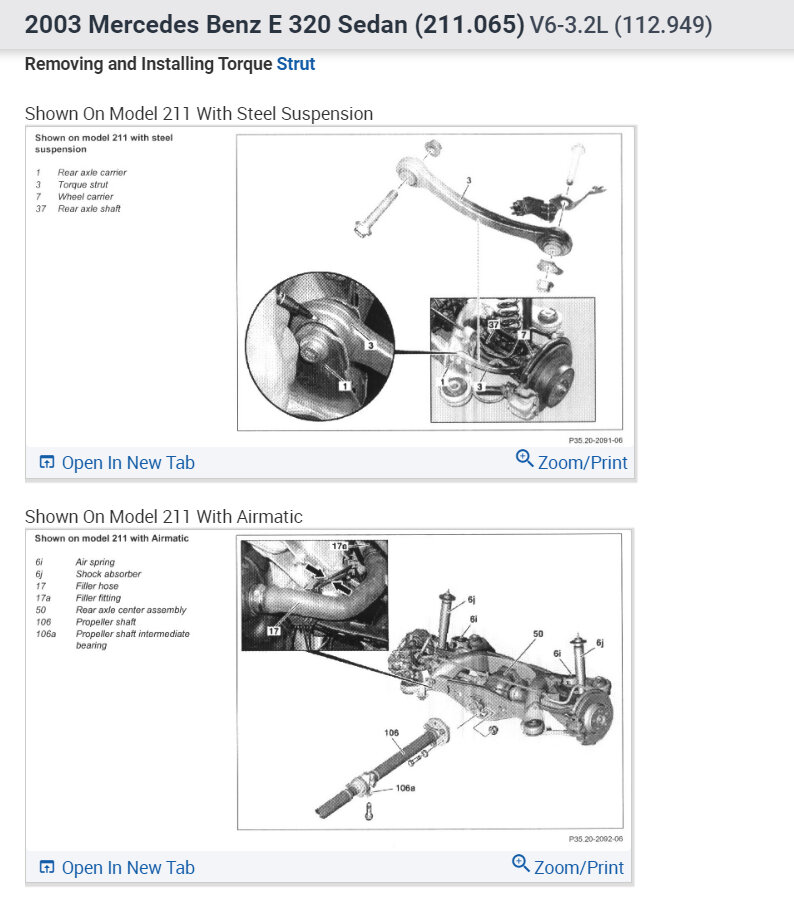

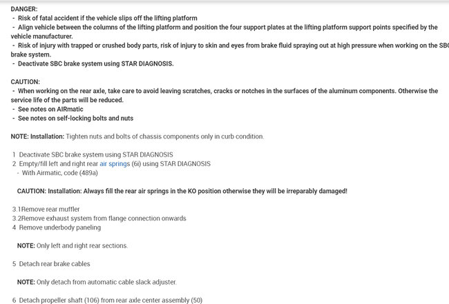

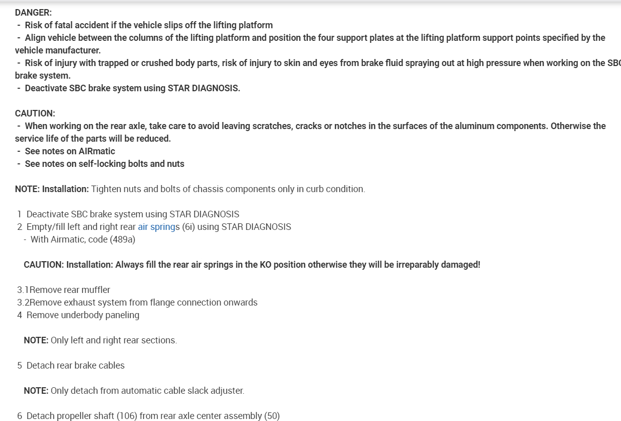

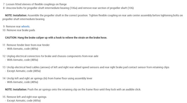

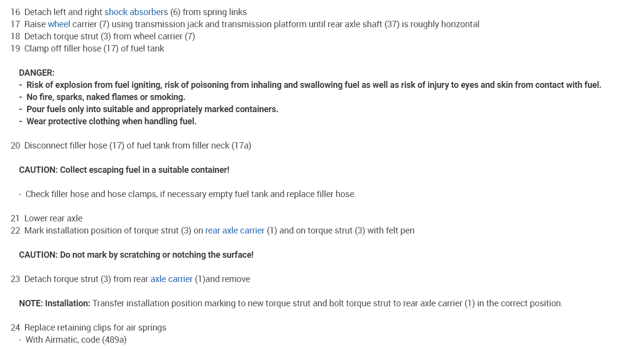

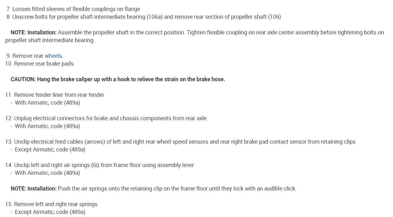

Also, I have left instructions on how to replace the parts mentioned. Check out the images (below). Let us know what happens and please upload pictures or videos of the problem so we can see what's going on.

Thank you for the information, it's greatly appreciated. But I already know how to do everything short of rebuilding a CVT transmission I can do everything. I just have trouble with diagnosing, I think losing part of my hearing and vision is what makes it hard for me. With those videos of you look at the ground and the tread of the tire while spinning you can see a wobble. I'm thinking my new wheel bearings are failing as well. The ones I installed were the cheapest things as they came with the hub. It only cost 50 dollars for the hub assembly. Today When I was driving going between mostly between 25 and 60 next to a divider, I heard what sounded like a growing and roaring noise. It also had a sound similar to when a cage in a ball bearing breaks and you have the rattle metallic sound. While it wasn't really that audible, you can hear it in that case. Also, when slowing down or giving gas it sometimes feels like something is binding or dragging. Since a lot of parts are original or have been replaced with cheapest budget part coupled with driving 10,000 miles all highway past 2 months. I think everything just started giving out Before that I would only drive 2,000 miles a year and it was mostly city and country style roads. I would almost never go above 45 mph. I think it's best I replace everything. It doesn't cost that much to get a full replacement kit for both sides with from a good brand. Also, even if the tires may be good, I want to replace them. They aren't a good tire at all and have a lot of road noise and aren't comfortable. They seem like a very hard compounded tire.
May 2, 2023 at 7:03 AM
  • 55,381 POSTS
I did see the flat spots but I am not sure they would cause the problem, but when it comes to tires sometimes the problem are internal and can't be seen so to be on the safe side let's replace the tires.
