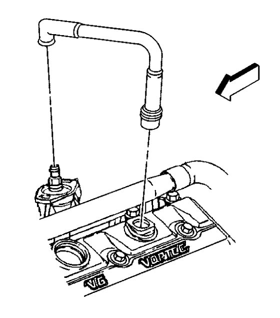

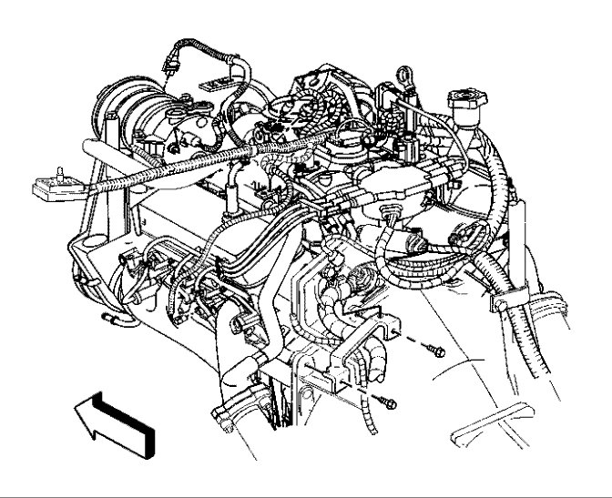

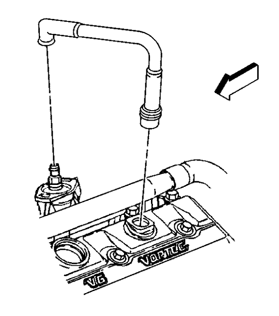

It has a rough start and idle. I know the map and MAF sensors are good, also put in a new air temperature sensor, new PCV valve. Does not seem to be any vacuum leaks and it runs really good after 1,500 RPM's. There is smelly exhaust and black coming out of the tailpipe. I have also cleaned the intake manifold and new plugs wires, distributor.

Rough start and idle plus better performance at higher RPM sounds like it is running rich. Those love to leak fuel from the fuel pressure regulator and the fuel lines inside the intake manifold on the spider injectors. They also get the poppet injectors that stick but that usually shows up as a single cylinder miss while the others cause random misfires and rich running. The smell and black smoke both indicate the rich condition. I would try to get it repaired ASAP as running it that way can easily damage the converters.
Replacing both parts is not all that difficult as you only need to remove the upper intake cover. However, if it has not had the lower intake gaskets replaced yet it is not a bad idea to do them as well as you will already have the intake apart.
Also the 1999 usually has the older poppet style injectors. You can get a conversion unit that replaces that with the newer updated MFI injector unit. That gives each cylinder an actual injector instead of the SCPI system. I do that upgrade on most of the 4.3's that have issues and everyone has come back and said they get better mileage and a much smoother engine than they were before the conversion. The updated unit is about $50.00 more but it eliminates a few problems on the older injector units.

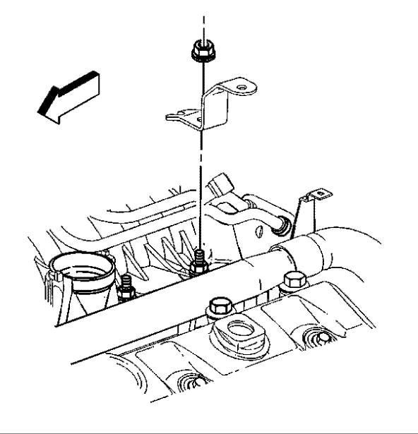

Remove the air cleaner outlet duct from the throttle body.
Remove the air cleaner assembly. (image 1)

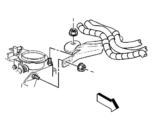

Disconnect the vacuum hose from the intake manifold, if equipped with A/C. (image 2)

Remove the PCV valve hose assembly form the intake manifold and the valve rocker arm cover. (image 3)

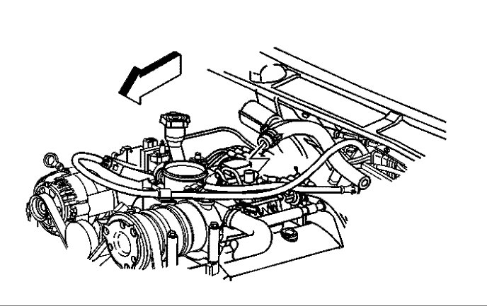

Leave the accelerator and cruise control cables and the engine wiring harness on the bracket. (image 5)

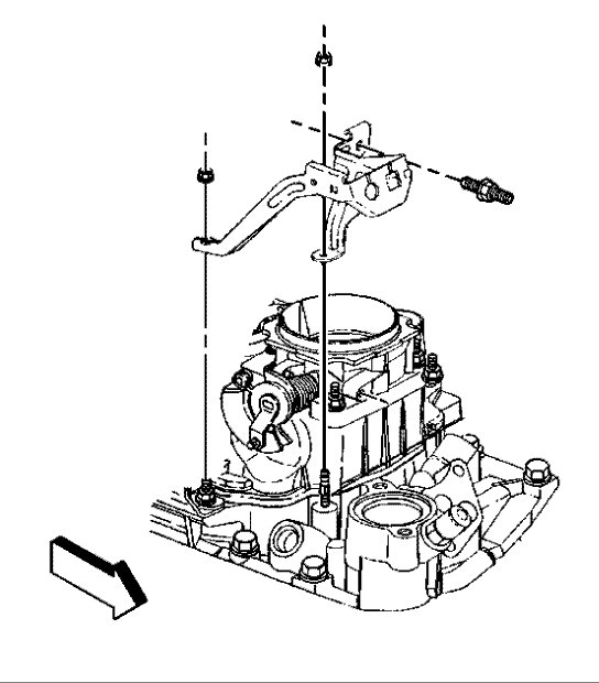

Remove the bracket for the engine wiring harness from the intake stud. (image 6)

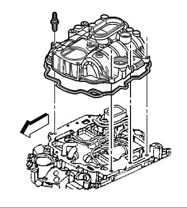

Remove the upper intake manifold. (image 7)
Clean all sealing surfaces.

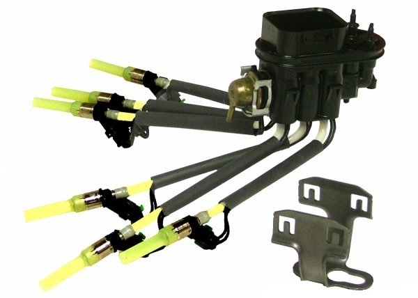

Disconnect the fuel lines from the SCPI injector and remove the bolts from the clamp that holds it down. Squeeze the injector retainer clips and pull each injector out of the lower intake manifold.
If you do the upgrade be sure to get the bracket and clamp for the new unit. Some include it some do not. The last picture shows the new unit and the hold down bracket.
