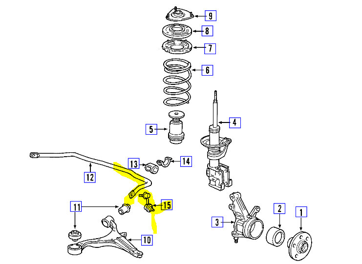

When making left turns there is a rubbing noise coming from the front passenger side?
2004 HONDA CRV
145,000 MILES • 2.4L • 4 CYL • 4WD • AUTOMATIC
ANGIEBIG
Front passenger side has a rubbing noise only on left hand turns.
Aug 21, 2023 at 9:52 AM
  • 110,244 POSTS
Can you tell if it is coming from the front or rear? Is it loud enough to record and upload for me to hear?
Next, if you haven't already, inspect under the front of the vehicle. Check to make sure nothing is broken or damaged and touching the tire or axle. I attached a pic below showing the sway bar link and sway bar. Check both of those for damage. The link (number 15) may have broken and is touching the axle or tire. So, check the rear of the tires to make sure there isn't evidence of something rubbing it.
Let me know if you find anything. Also, pay attention if the sound changes when you apply the brakes.
Take care.,
See pic below.
