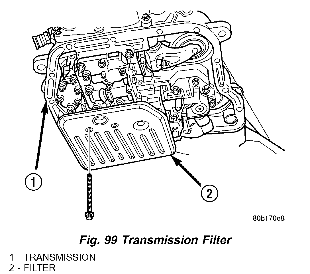

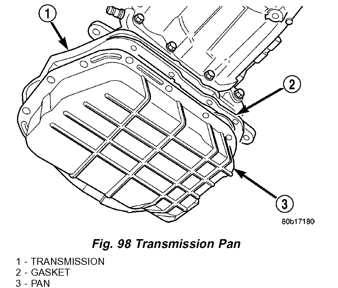

The transmission when shifting from fourth to fifth the RPM's go up and feels like it does not want to shift
2004 JEEP CHEROKEE
150,000 MILES • 4.0L • 4 CYL • AUTOMATIC
CRANE87
I just bought the vehicle listed above used that I think has been sitting at least a few months. I haven’t had the funds to do anything yet other than get it legal and buy it. It runs well usually. Occasionally when it’s going from fourth to fifth gear (automatic) the RPM's will go up and down and it feels like it does not want to change gears. It always has so far though and otherwise runs fine. I checked to transmission fluid and it’s full and reddish/brown in color. Do you have any advice? Please and thanks.
Oct 11, 2019 at 12:16 AM
  • 110,236 POSTS
Welcome to 2CarPros.
The fluid shouldn't have any brownish color to it. It should be a bright reddish pink. The first thing I would suggest is to change both the fluid and the transmission filter. Here are the directions for doing it. The attached pics correlate with the directions.

3. Remove bolts holding front and sides of pan to transmission (Fig. 98).
4. Loosen bolts holding rear of pan to transmission.
5. Slowly separate front of pan and gasket away from transmission allowing the fluid to drain into drain pan.
6. Hold up pan and remove remaining bolt holding pan to transmission.
7. While holding pan level, lower pan and gasket away from transmission.
8. Pour remaining fluid in pan into drain pan.

9. Remove screws holding filter to valve body (Fig. 99).
10. Separate filter from valve body and pour fluid in filter into drain pan.
11. Dispose of used trans fluid and filter properly.

1. Position a new transmission oil filter onto the valve body
2. Install the screws to hold the filter to the valve body Tighten the screws to 4 Nm (35 inch lbs.).

4. Position the oil pan gasket onto the oil pan.
5. Position the oil pan and gasket onto the transmission and install several bolts to hold the pan and gasket to the transmission.
6. Install the remainder of the oil pan bolts.
For OE type reusable pan gasket: tighten the bolts to 13.6 Nm (125 inch lbs.).
For aftermarket pan gasket: tighten the bolts to 17 Nm (150 inch lbs.).
7. Lower vehicle and fill transmission.

That is where I would start. If, however, the check engine light is staying on when the engine is running, you really should have the computer scanned to see if there are any diagnostic trouble codes related to the transmission.
Do this and let me know if it helps.
