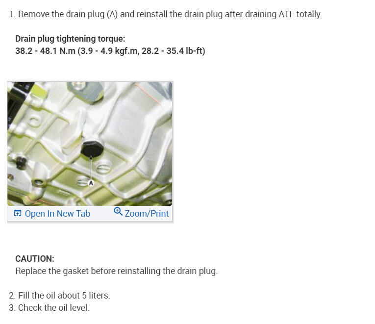

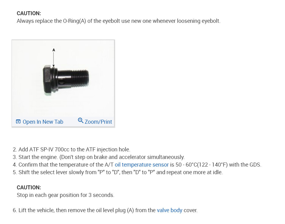

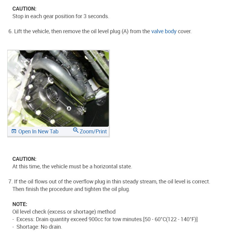

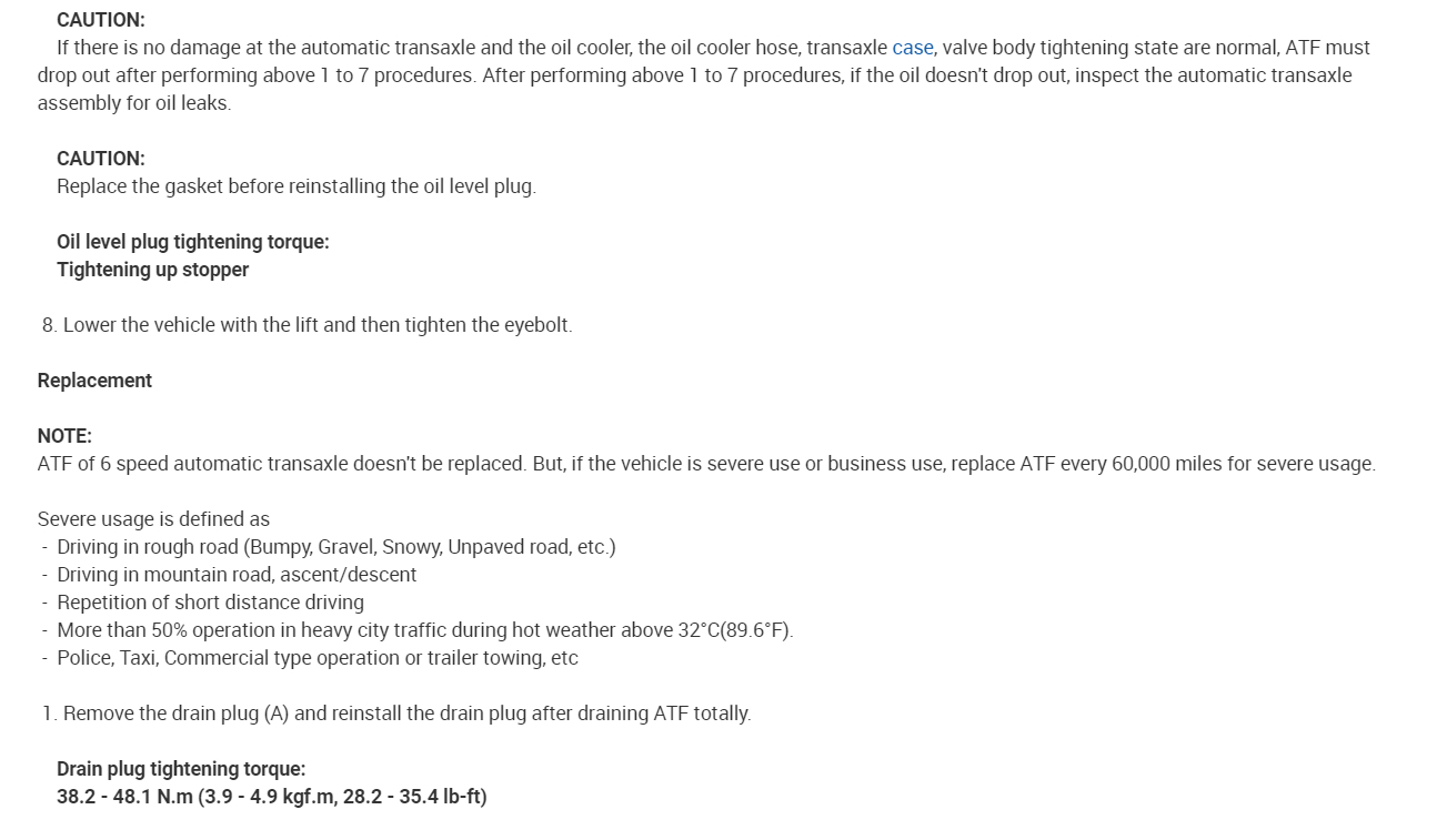

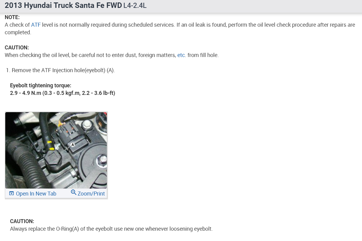

It does sound like the transmission is low on fluid or the transmission is going out. Please upload pictures or videos of the problem so we can see what's going on. Here is a generic guide to help you step by step with instructions in the diagrams below to show you how on your car:
https://www.2carpros.com/articles/how-to-check-and-add-transmission-fluid
Automatic Transaxle Fluid
Type .................... MICHANG ATF SP-IV, SK ATF SP-IV, NOCA ATF SP-IV, HYUNDAI genuine ATF SP-IV or other brands meeting the specification approved by Hyundai Motor Co..
Capacities
Capacity .................... 7.50 qt (7.1L)
If the fluid smells burnt, I would try a transmission service.
Check out the images (below). Please let us know how it goes.
