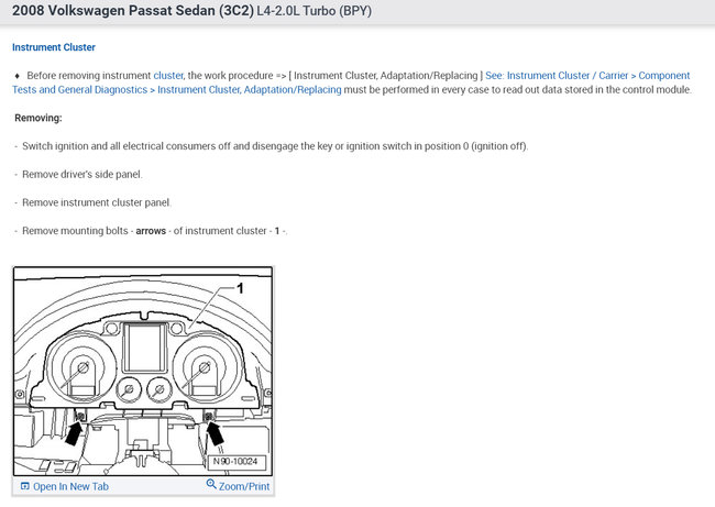

Tachometer and speedometer not working
2008 VOLKSWAGEN PASSAT
195,000 MILES • 2.0L • 4 CYL • AUTOMATIC
MAUBUCHON123
Also when car is in park after turning on or in park it idles up and down.
Nov 6, 2019 at 1:53 PM
  • 54,832 POSTS

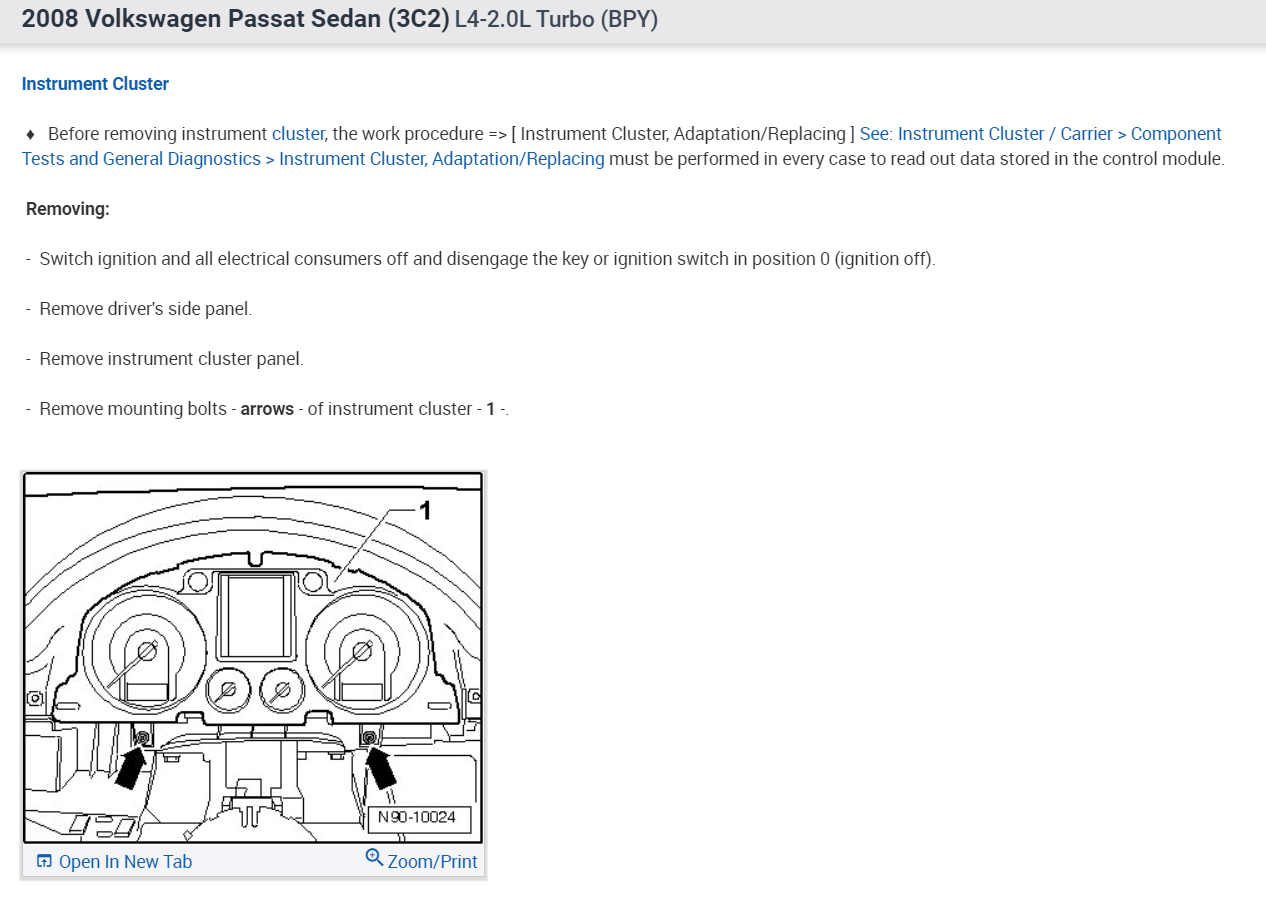

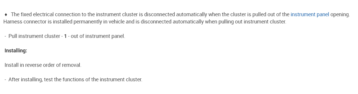

This sounds like the cluster had gone bad which will cause the issue you have described. Here is a video of the job being done on a similar vehicle and instruction in the diagrams below to show you how on your car below:
https://youtu.be/_HEC44xENxw
Please give the cluster rebuilder your VIN and mileage so they can program the new unit.
