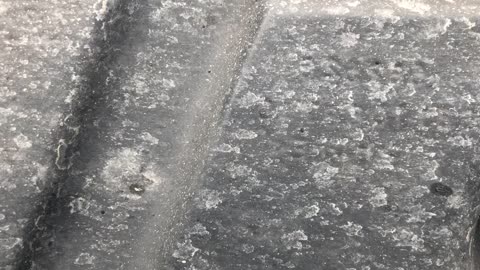

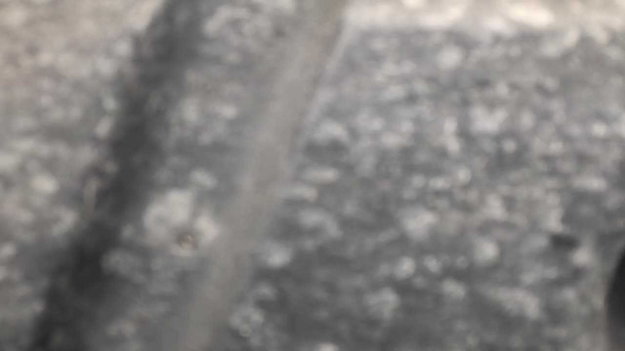

JACOBANDNICKOLAS. My friend that is a very good mechanic said the fuel trims looked fine on the live data scanner when he checked. The manifold leak is pretty bad it ticks very loud on a cold start up and I feel as if I still hear it slightly when driving next to a wall. I haven’t really checked for vacuum leaks since I’m not sure exactly where to look. So far I cleaned the Throttle Body twice in 7 months the first time was dirty the most recent time it wasn’t bad at all. I use Premium gas always 93 and synthetic oil on every oil service. I always check my oil catch can about once a week. I do drive the truck hard or “sporty” just hard acceleration but no burn outs or racing. Lots of highway miles so prolonged driving at 77 mph. The truck now has 126,384 miles on it. Also cleaned the PCV valve which wasn’t bad due to the catch can and cleaned the MAP sensor as well. My volts stay around 13-14 but lights do dim from time to time when I’m parked and over roll my windows up so not sure if the alternator maybe getting weak.
Aug 4, 2019 at 9:39 AM
CORY SHANAHAN
  • 6 POSTS
This is a cold start up hopefully the video attaches .
Aug 4, 2019 at 9:41 AM

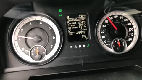

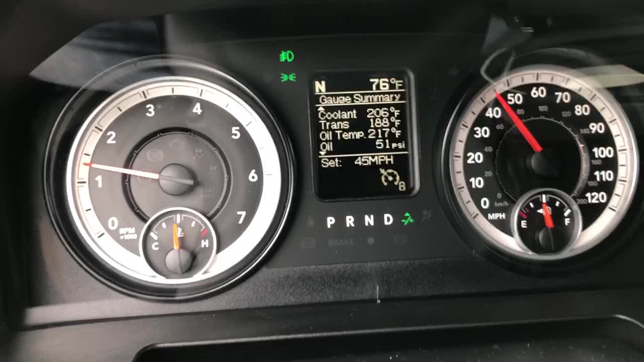

This is the RPM's at 45 mph on cruise control without touching the pedal at all. You may have to zoom in while watching. Been like this for 2 weeks still with no light or stored codes of any kind.

If you're seeing an rpm change while driving at highway speed, switch on the gear indicator to verify the transmission isn't hunting between two or more gears. If it's staying in 8th gear, but you see engine speed increase by 200 rpm periodically, the torque converter is unlocking. That can be due to a brake light switch that's out-of-adjustment and vibrating over bumps in the road. Hold the brake pedal up with your foot. If the switch is causing the problem, the engine speed will hold steady while you're holding the brake pedal.
It's much less common, but a throttle position sensor, or more likely a corroded connector terminal for it can cause the torque converter to unlock too. Normal range of sensor signal voltage is 0.5 to 4.5 volts. Anything outside that range is what sets diagnostic fault codes. If you approach one of those maximum values, the Engine Computer interprets that as "wide-open-throttle", or "closed throttle" and preparing to come to a stop. Either condition initiates a momentary torque converter unlock. I haven't looked yet to see if my truck uses the same old-style throttle position sensor or if it only uses the one built into the throttle body assembly.
You can also watch engine speed on a scanner while on a test drive. The scanner will also show the torque converter clutch as "locked", or "on", or "unlocked", or "off". If you see it switch to "unlocked" when rpm increases, you still have to look at the other sensors to see why the computer is unlocking it. The "record" function that most scanners have is useful for this. You can play the short recording of sensor data back slowly in the shop to see what changed when the torque converter unlocked.
