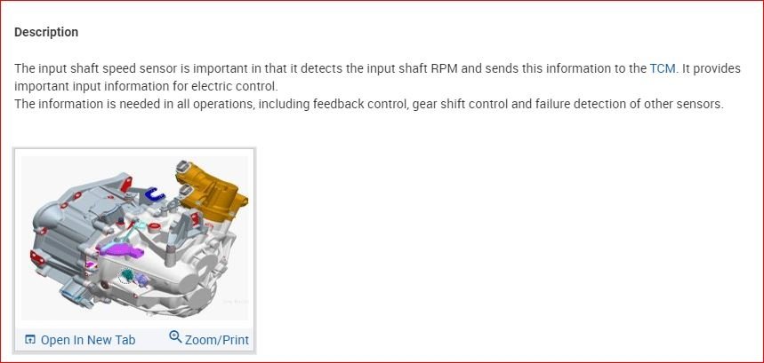

Unfortunately there are a lot of things that could have caused this. The fact that it was only the tachometer that went to zero tells me there could be an issue with the input shaft speed sensor because that is what tells the Transmission control module what the RPM of the engine is and obviously the tachometer is displaying this input.
However, when you add the fact that the vehicle would not start to this, the input sensor would not prevent the vehicle from starting. This part of it is what makes this more complicated.

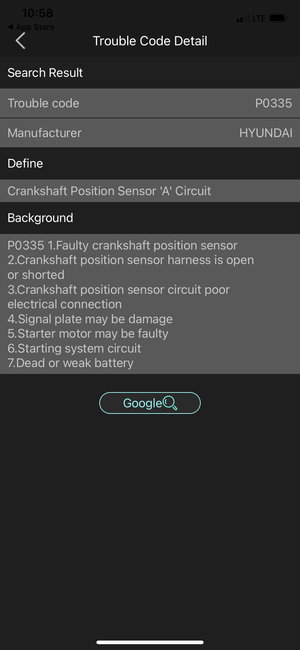

I have the EXACT same problem with my 2012 Veloster 1.6 L 4-cylinder. Error code P0335. Faulty crankshaft position sensor “A” circuit.Di you have any follow up? Is this an easy fix?
Mar 28, 2021 at 1:06 AM
Unfortunately we do not have a response. However, if you have that code it is normally one of 3 things. Either the sensor (most likely) the wiring, or the control module.
Unfortunately again, we don't have a module on your vehicle so we can't provide specifics but here is a guide on how to replace a crank sensor:
Hopefully this helps but this is where I would start.
