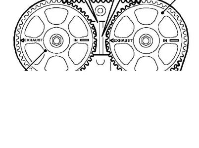

I drove though around 3foot of water.. Car sat in it for about 2 hours before being recoverd. Have no water in oil or coming from pistons when cranked by hand.. However car will not start.. Just a single click. Will not jump/ bumpstart .. Any ideas!?

All spark plugs removed.. When you try to manually crank, will only crank quater.. Maybe halfway, then stops! Also, piston's are 3 up 1 down.. The manual states should be 2up 2 down.. Air filter was sodden so am guessing water has been taken into engine..
All electrics work fine as does starter motor/ battery/ fuel pump..

It has plenty of oil in..almost full. I was going around 10/15 mph when I drove into the water.The car just stopped dead..So im guessing that when the exhaust got under the water..the engine took in water at that point killing the engine?

No that wouldn't have killed it other wise I could have killed my truck everytime I dock my boat. It took water into the intake that is why the air filter was wet. How wet was the air filter? What I am thinking is the water got into the engine and hydro locked it and maybe bent a rod or something. So what you do now it bring the timing up to tdc and check the cams are they aligned (see pic) and check the pistons to make sure they are as they should be.
https://images.2carpros.com/forum/automotive_pictures/249564_timingof16valvezk6_1.jpg
