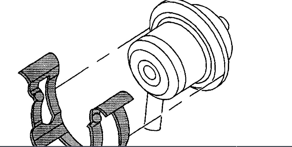

Good morning,
I would start with the fuel pressure. Check it and make sure the pressure is correct.
You need 55-60 pounds of pressure.
The issue is the fuel pressure regulator. It is common to fail and when it does it drips fuel directly into the intake manifold and makes it run rich and also lowers the fuel pressure as well.
Are there any codes set?
If you have a scan tool, can you give me the long and short term fuel trim percentages?
REMOVAL PROCEDURE
1. Disconnect the negative battery cable.
2. Relieve fuel system pressure. Refer to Fuel Pressure Release Procedure.
3. Remove the upper manifold assembly. Refer to Engine Mechanical.
DISASSEMBLE PROCEDURE
1. Disassemble the fuel pressure regulator snap ring retainer.
2. Disassemble the regulator assembly and the O-rings.
3. Discard the O-rings.
NOTE: If the fuel pressure regulator is to be reinstalled, inspect the filter screen (if equipped) for contamination. If contaminated, remove. Discard the filter screen.
ASSEMBLE PROCEDURE
1. Lubricate the new O-rings with clean engine oil.
2. Install as an assembly, backup O-ring, large O-ring, filter and small O-ring.
3. Assemble the regulator with vacuum tube pointing down and snap ring retainer.
INSTALLATION PROCEDURE
1. Install the upper manifold assembly. Refer to Engine Mechanical.
2. Connect the negative battery cable.

I would start with the regulator as I suggested. It is part of the spider but can be replaced by itself as in the picture I gave you.

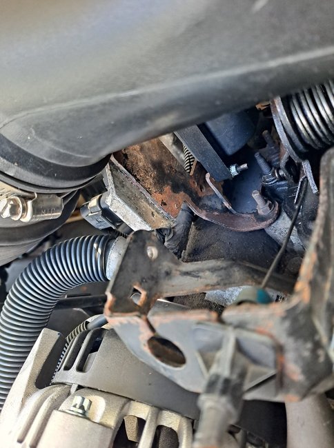

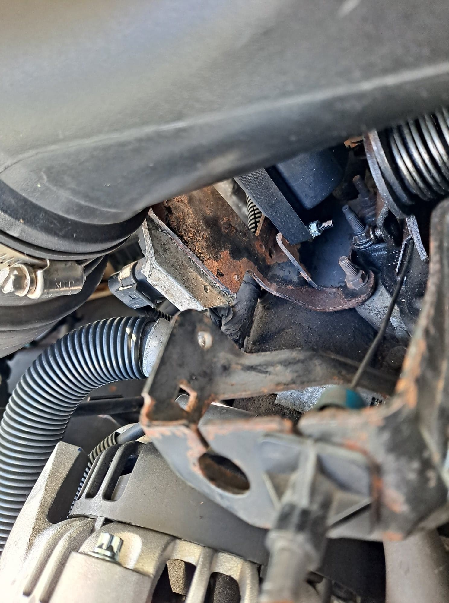

After further inspection, (although it's right in front of me and several mechanics) the "heat sink" is missing from my ICM. I'm going to try a new ICM and new heat sink before I tear the intake manifold apart.
Sep 30, 2020 at 5:50 AM
Okay, that will not effect the fuel pressure issue at all.
