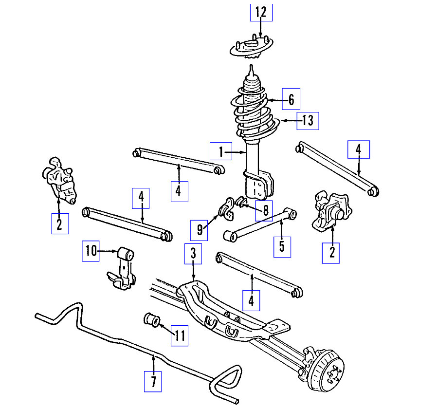

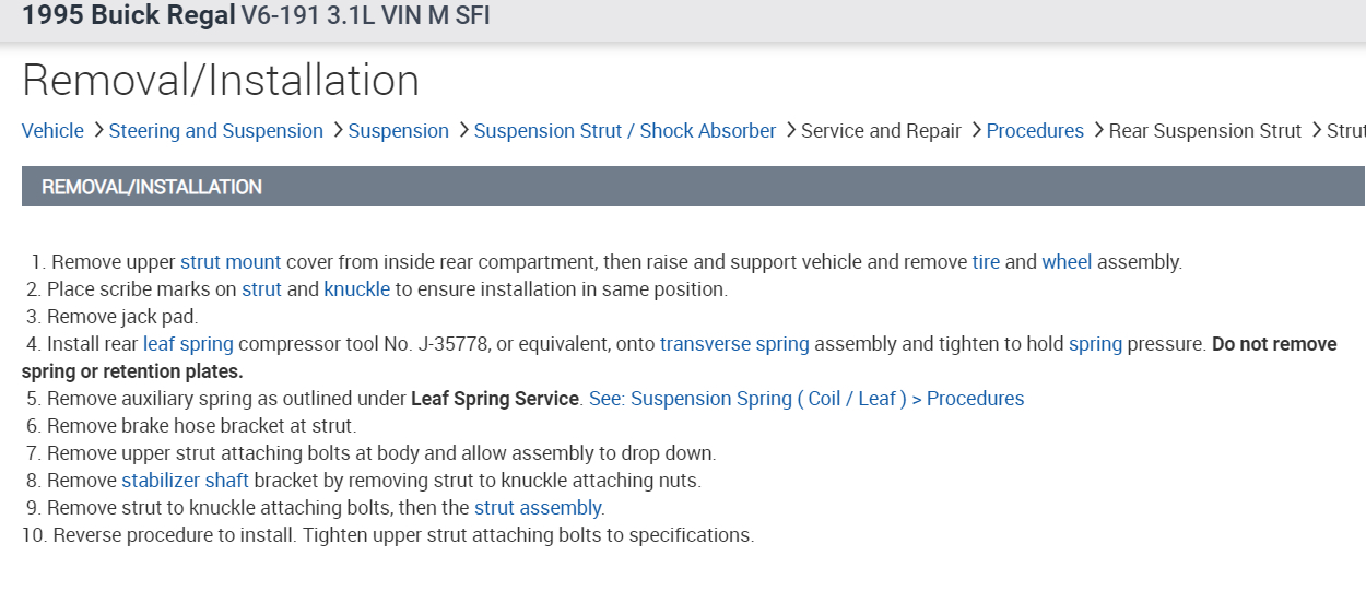

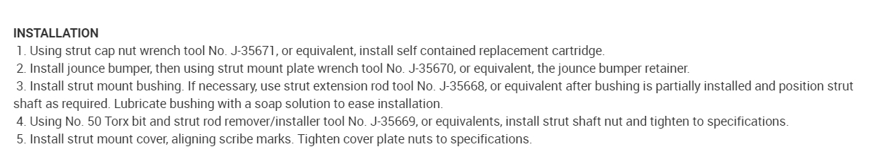

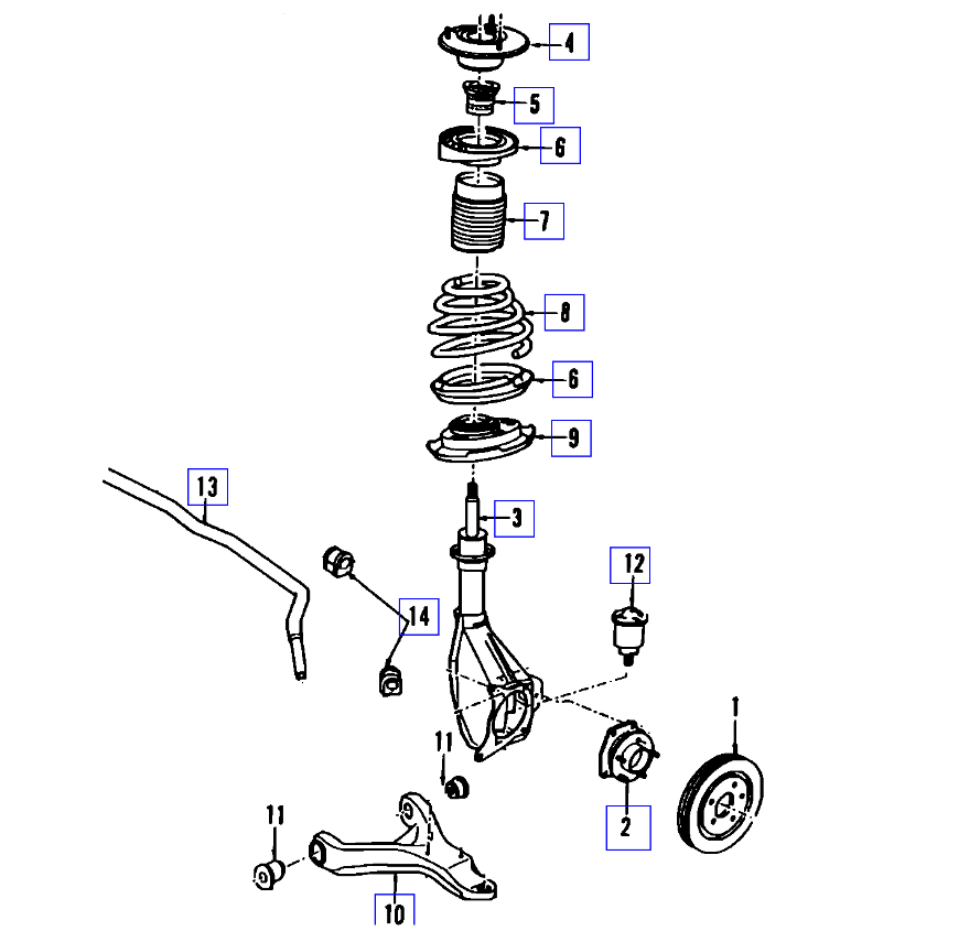

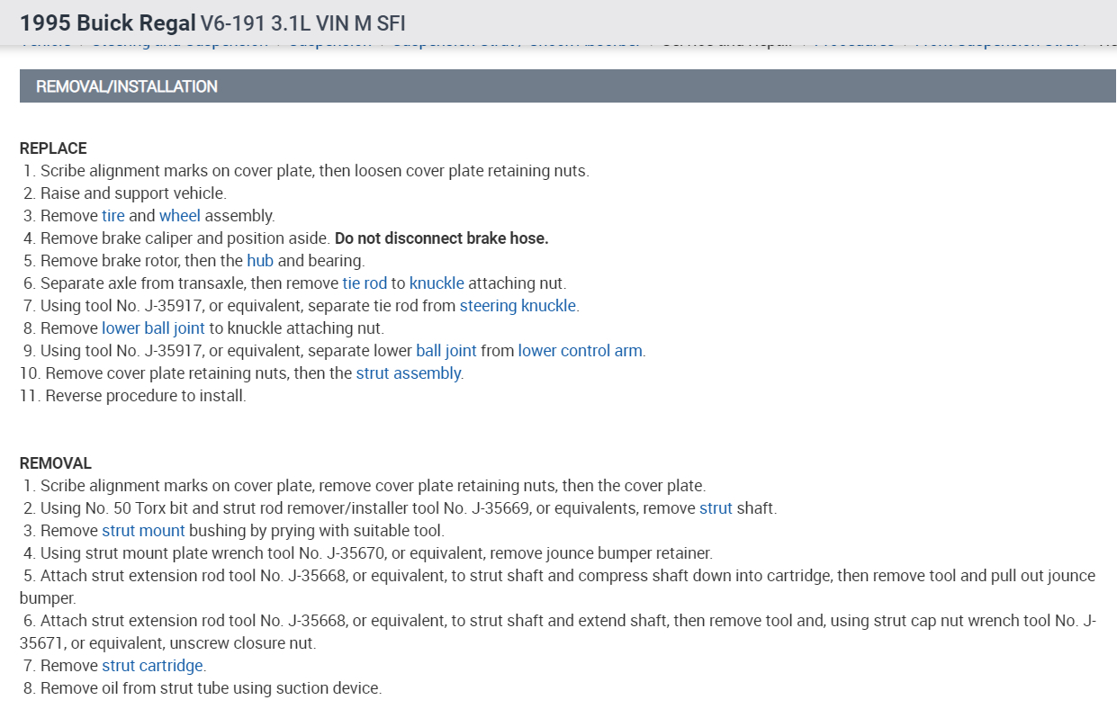

Bumpy ride at any speed when driving over rough road and/or potholes.
Mar 20, 2023 at 2:32 AM
  • 55,412 POSTS
This could be due to the air pressure in the tires being over inflated or the front struts or rear shocks need to be replaced. I have left instructions in the images below on how to do the job. Check out the images (below). Please let us know what happens.
Mar 20, 2023 at 6:07 AM
NIARB
thanks probably struts/shocks.
