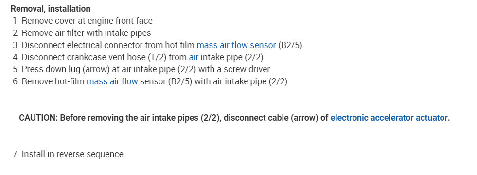

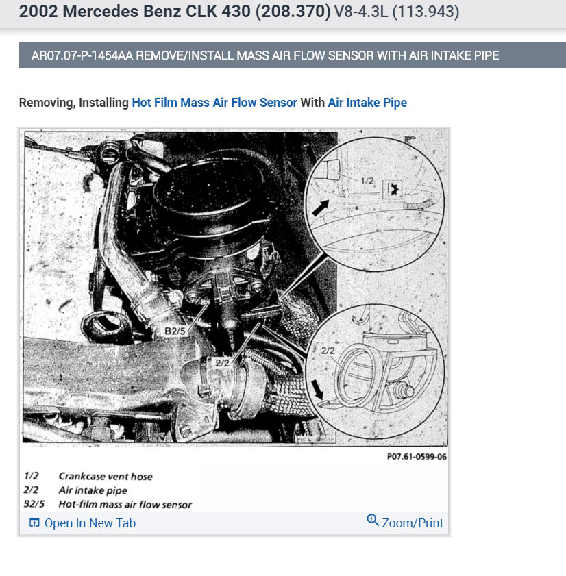

As far as the MAF sensor that is more difficult to test because you would need a new sensor to check the difference in values. The MAF is a normal wear item and should be replaced after 100,k here is a video that shows the job being done on a similar car with diagrams below to show you on your car.

I replaced it with the new Mass air flow sensor and is running a lot better but 3 5 and 6 is still is misfiring and there's still got like a vibration going through the car. when I put in first gear you can feel the rough idling. still I don't know what it would be. anything would be appreciated that I can check.
