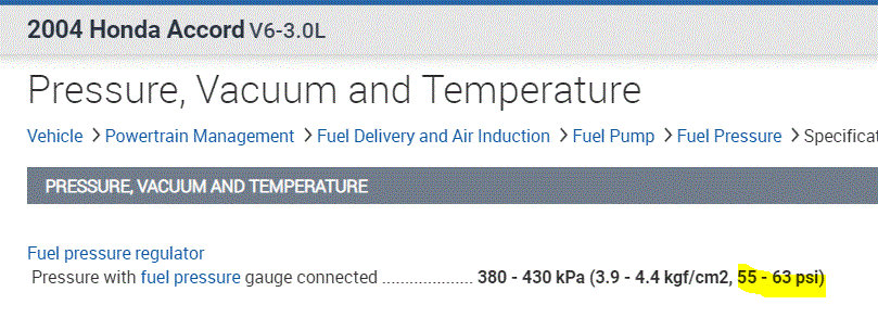

If you smell gas from the exhaust when it starts, chances are it is getting too much fuel resulting from high fuel pressure. Since the fuel pressure regulator is in the fuel tank on this vehicle, what I suggest is to check the fuel pressure. Here is a link that shows in general how it's done:
I attached the manufacturer's specifications below. You will need a fuel pressure gauge for this. However, most parts stores will lend one to you.
Let me know if you are comfortable doing this.

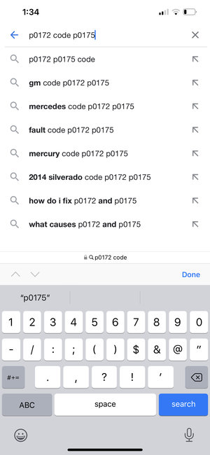

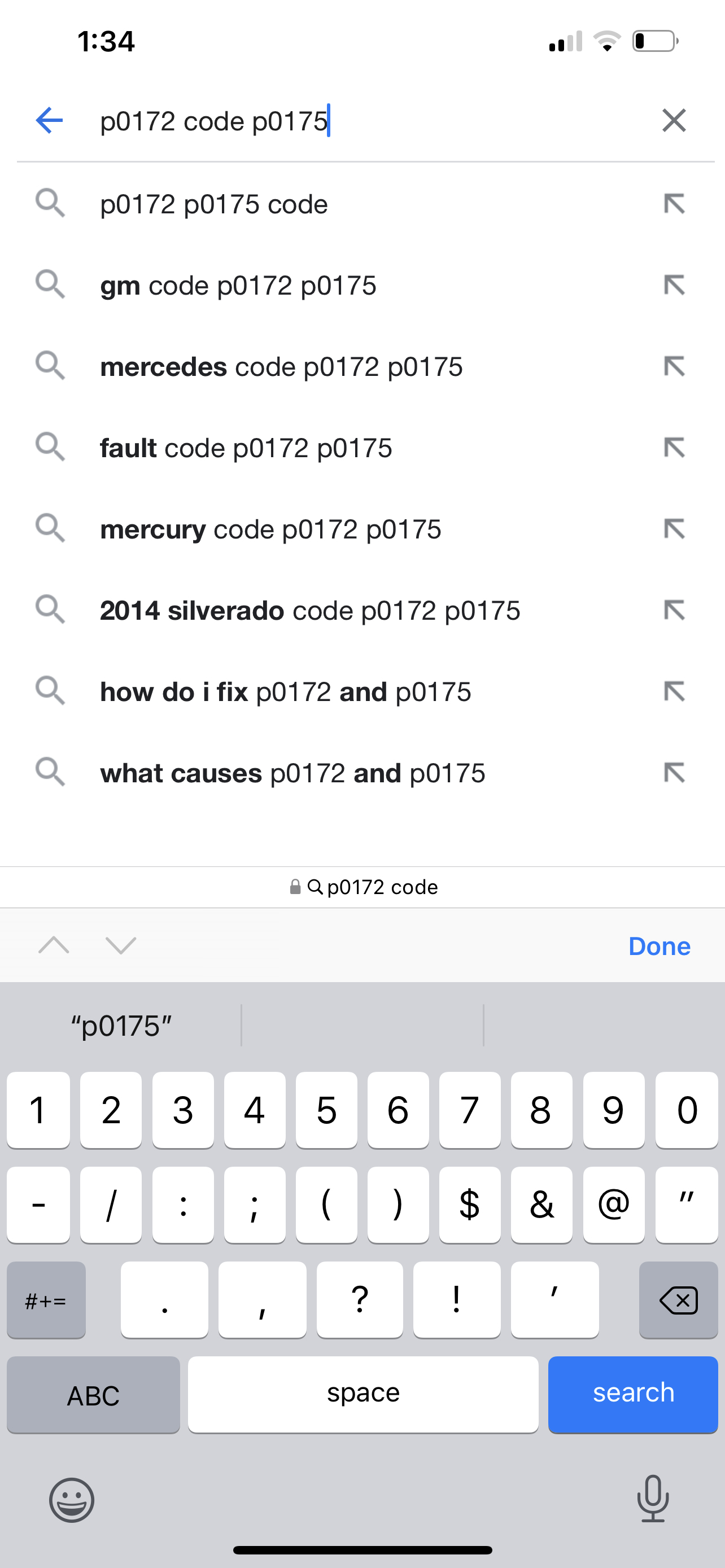

These are the only 2 codes that come up.

  • 110,244 POSTS
Both codes indicate a rich fuel mixture. Chances are the fuel pressure is too high. There are different sensors that can cause the issue, but since these are the only codes, I feel it is the fuel pressure.
Are you comfortable performing the test I provided above?
