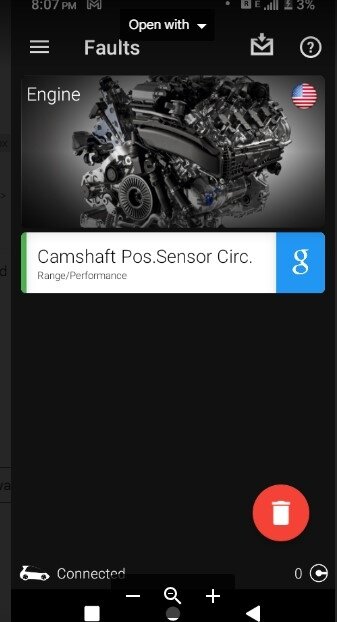

Found that the cable to the camshaft position sensor (connector) was corroded, fixed.
primed enough fuel and removed bubbles and car started. The result is that its idling rough, more like misfiring. I have cleared all the errors, but the camshaft fault seems to be coming back.

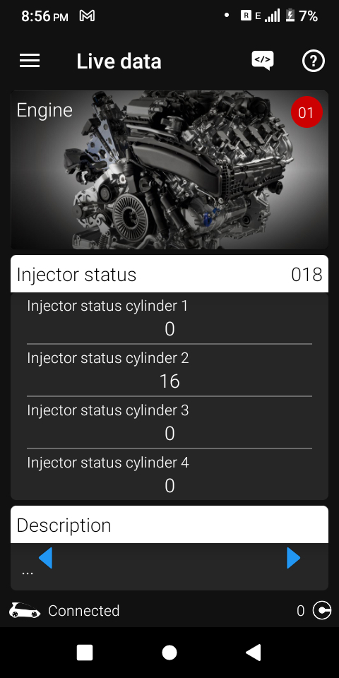

Another worrying factor is that when analyzing live data from obdeleven, on the 'Injector Status' channel, it seems as if the only responsive injector/cylinder when revving the car is Cylinder 2. The other three don't present any values at all. Please also note that the 'three' PD injectors installed have not been coded/adapted, not sure if this is the issue. But here's an attachment of the screenshot of the channel.
Any ideas would be greatly appreciated.

That is odd. What is the actual code you are getting? Let me know. Also, let me know if once off idle if it seems to run okay.

What's really funny is that I'm not getting any injector fault codes after scanning several times. The only fault code that comes up even after clearing is the camshaft fault, which I will list below. This past weekend i have reconnected a wire that was corroded on the 3-pin connector. But generally, the only fault code I'm getting is the following:
01 Engine
System description: R4 2,0L EDC G000SG
Software number: 03G906016G
Software version: 9884
Hardware number: 0281011364
Serial number: XXXXXXXXXXXXXX
Coding: 0000072
Trouble codes:
P3007 - Camshaft Position Sensor No signal
Intermittent
