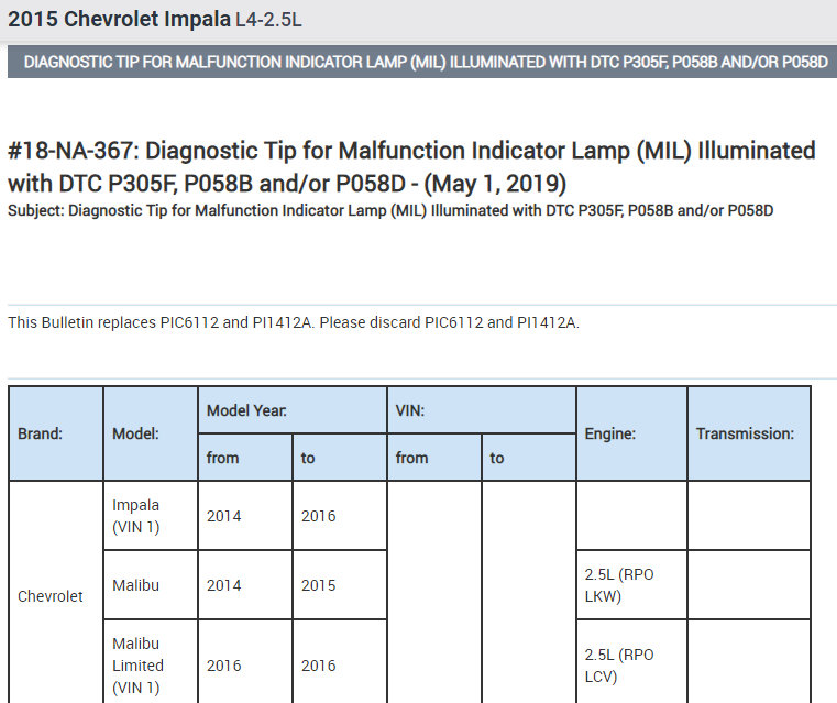

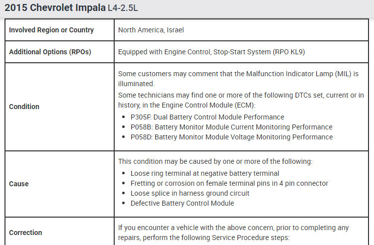

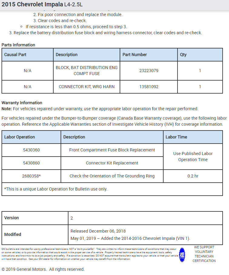

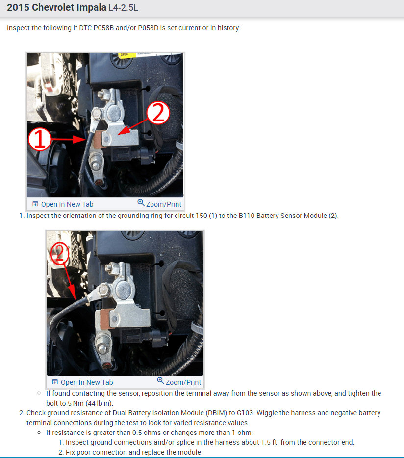

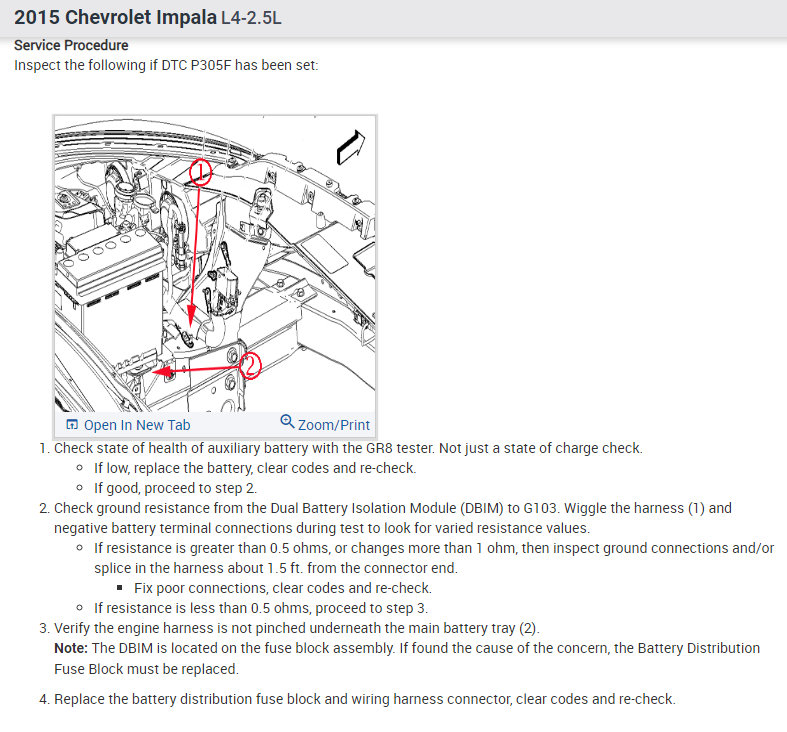

The code: P058D: Battery Monitor Module Voltage Monitoring Performance
Can be triggered due to a loose ring terminal at negative battery terminal, corrosion, defective battery control module.
I have attached the diagnostics for that code, look below.
Run down that process. Let me know what you find.

Thank you for reply, the service bulletin was exactly what I needed to point me right direction. It's a friends car that's having these issues, when he told me what it was doing and before reading MIL codes was thinking vacuum leak.

Will follow the steps of bulletin if both main and aux. batteries test good.
Checked out link in your reply, no problem with testing for faulty connections , wiring etc.

Found that one of the connections/wire to post/stud in the what I now know is the fuse battery distribution block was so lose it could be moved up and down between nut & plate. I went in house to get driver with insulated grips, wasn't sure if the wire was hot.
As you know DC packs a wallop, tool
touches something that completes circuit while tightening connector, hand holding tool is now part of the circuit.
When I got back outside he had it tightened and had to get rolling.
I'm not positive of which one was lose, if he isn't sure either. I'll know by looking at block again. I don't think it was #4 , I did some searching online earlier get informed on how that block is configured.
If I understood it and source of info was correct #4 is aux battery. #3 power steering module 1 and 2 interior fuse block. #4 is independent of #s 1,2 and 3 which are connected by a plate which allows power to be distributed across the three. Is that accurate?
I didn't have time to clear the code but it cleared itself rather quickly, I assume after a certain amount of cycles.
It appears that lose connection was the problem. I will check with him to see if the rough idle has improved.
