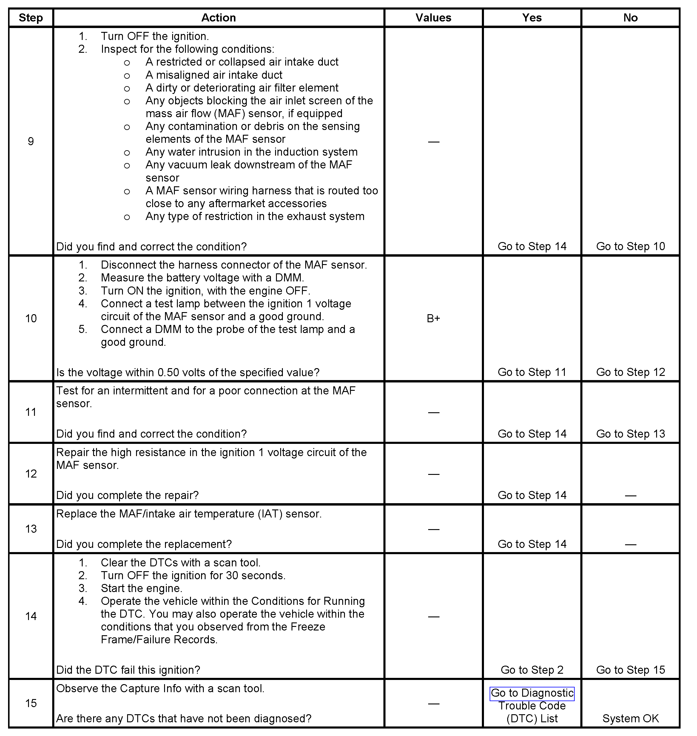

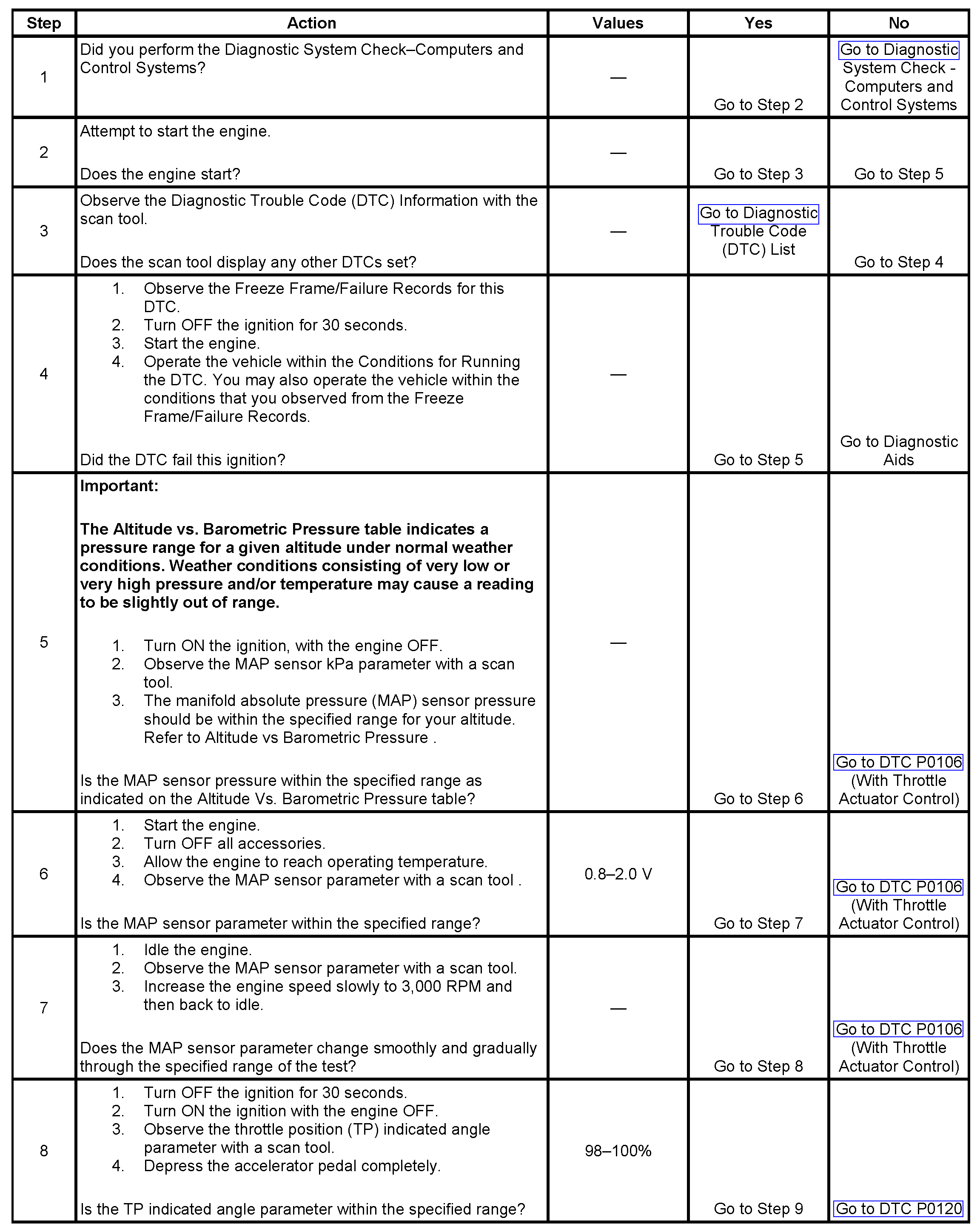

And now I have a p0101 so maybe the MAF sensor is all my problems?
Apr 14, 2020 at 8:58 AM
  • 110,248 POSTS
It is very possible. However, there are other things that can cause this code. If you want, take a look at the two pics I attached. They are diagnostic flow charts specific to this code. I'm just offering it in the event you want to confirm the MAF is the issue.
Let me know if I can help.
Apr 14, 2020 at 10:45 AM
