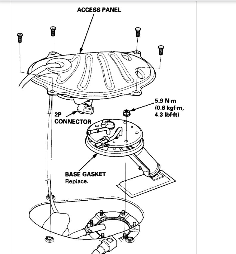

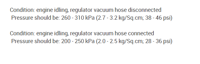

When you removed the hose, you raised the fuel pressure. By doing that, the engine runs better.

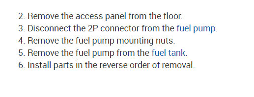

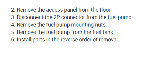

This sounds like you have a bad fuel pump not producing the correct pressure. You need to test the pressure to confirm. You can rent a tester from a parts store.
https://www.2carpros.com/articles/how-to-replace-an-electric-fuel-pump
