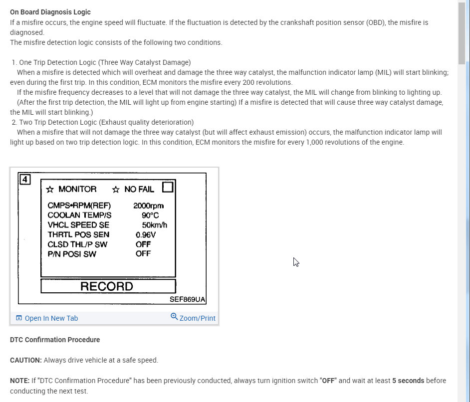

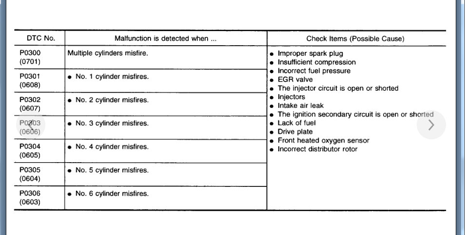

Changed spark plugs and did oil change. code 300 could this be injector? man told me bad motor, however it does not get hot or smoke or use oil. starts right up, just not running right. (AutoZone code 300 said it was fuel injector)
Feb 27, 2020 at 6:14 PM

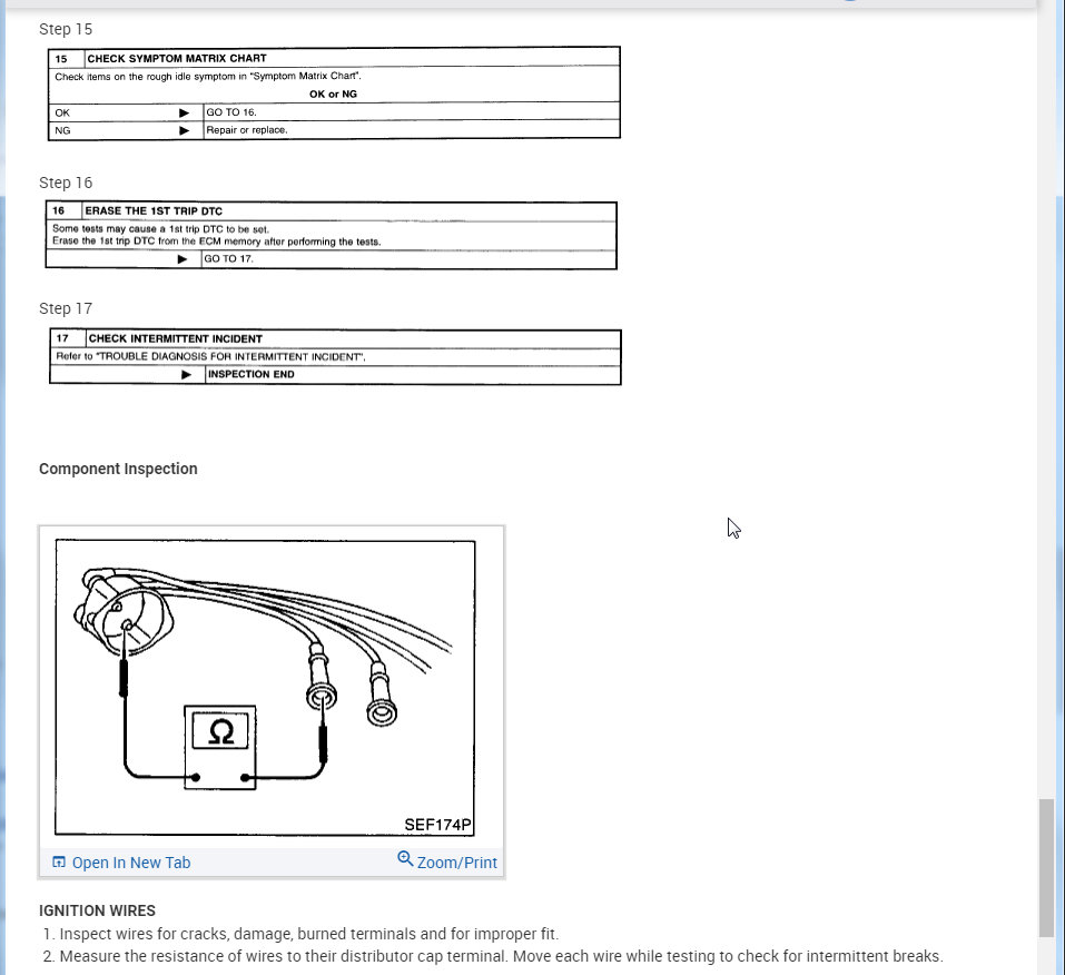

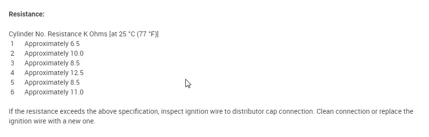

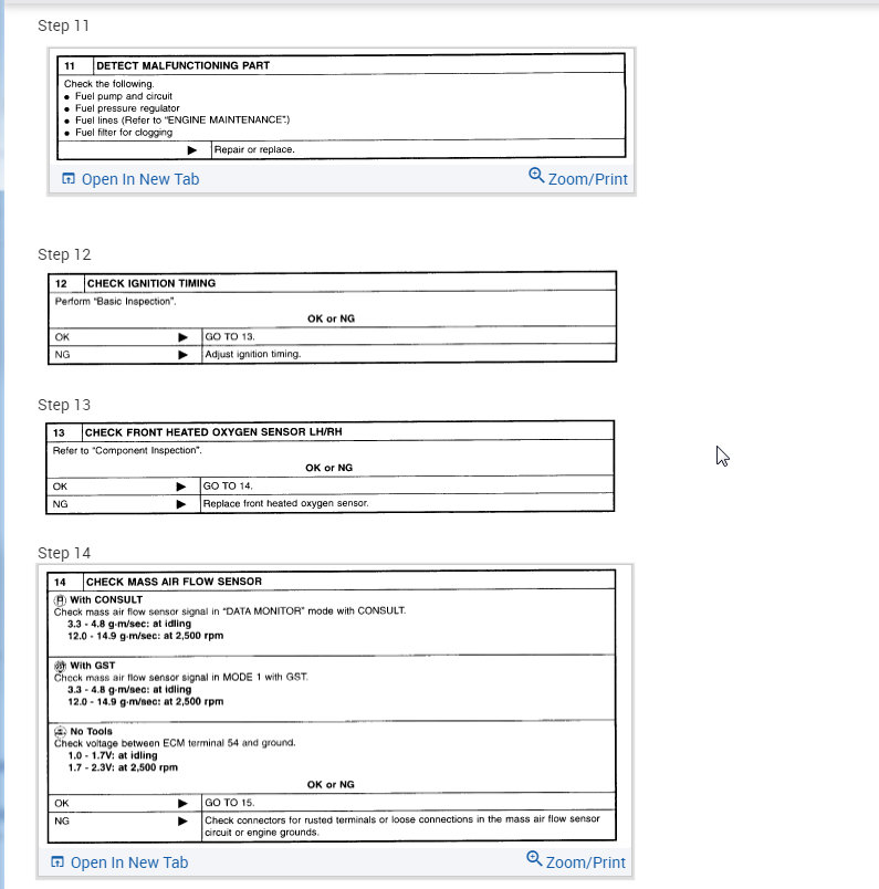

Yes. An injector is a possible cause. This code is telling you that multiple cylinders are misfiring but not consistently enough to condemn one specific cylinder or multiple ones.

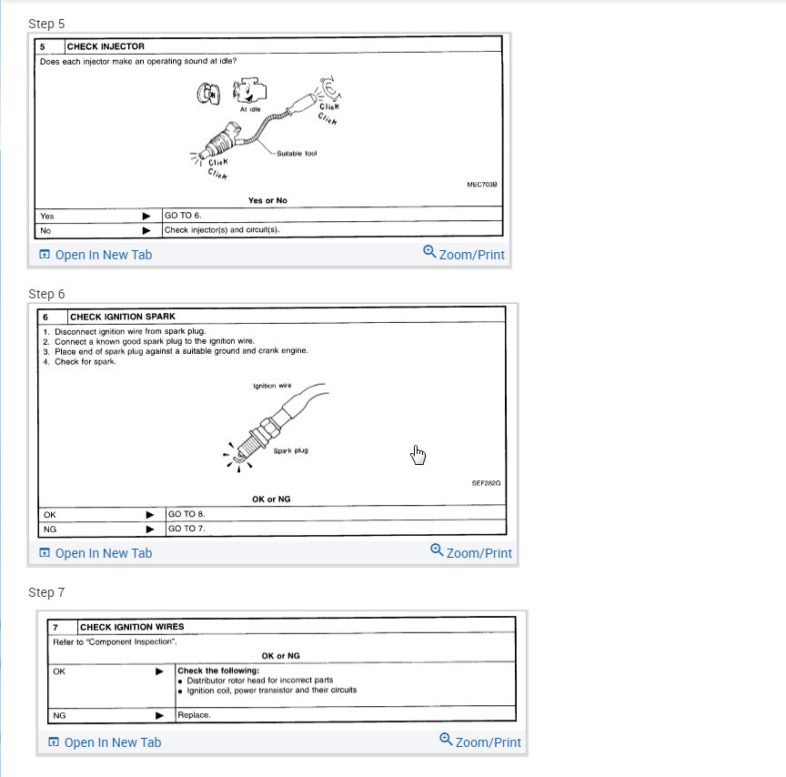

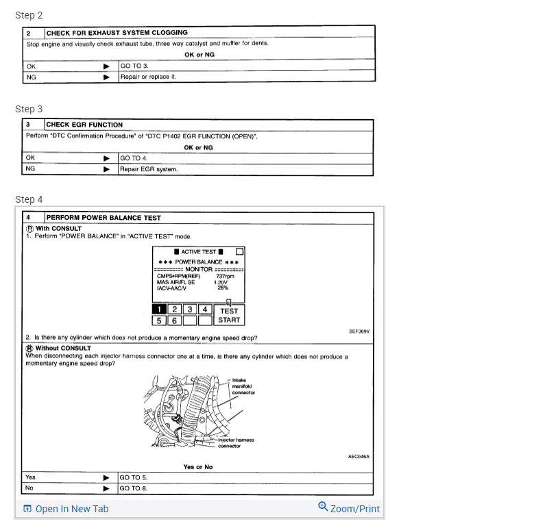

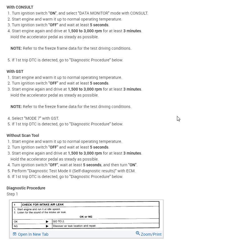

Here is the compete test that we need to go through to find what the cause is.
Take a look at this info and tell me what questions you have. Thanks

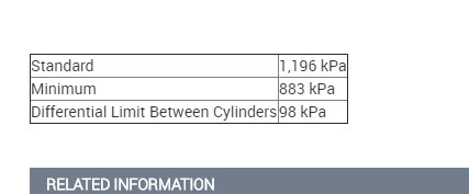

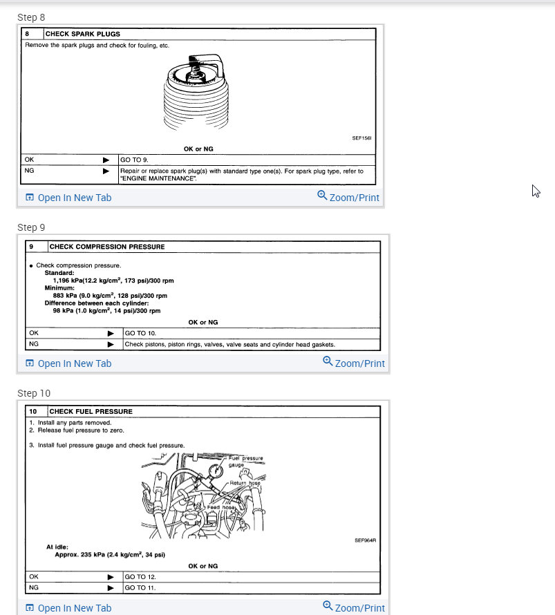

It is showing code p325 knock sensor bank 1 and ran a compression test and cylinder 3 was low only 90.
Feb 28, 2020 at 7:59 PM
Yep. That is the issue. Clearly if you have low compression on one cylinder then that will cause a misfire. Your minimum spec on compression is 130 PSI.
Long story short, we need to find the cause of the low compression on that cylinder. The knock sensor issue can be addressed after the compression is fixed.
Since you found low compression, we now need to find out where we are loosing that compression. You do this by performing a cylinder leakage test. Basically you set that cylinder on TDC on the compression stroke and then put about 20 PSI of compressed air to the cylinder and listen to the intake, exhaust pipe, bubbling in the cooling system, and oil fill cap for where you hear air escaping. This will tell you which component in the combustion chamber is leaking.
