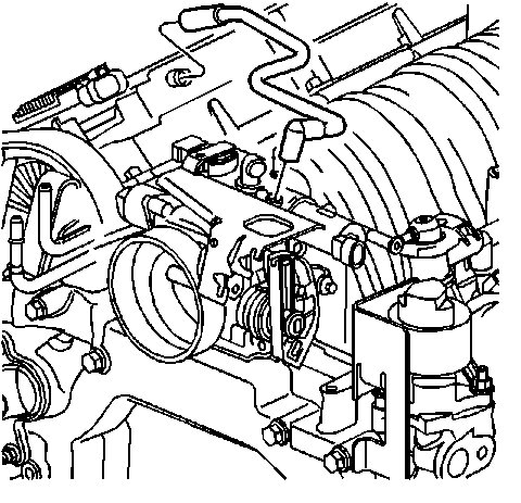

Next, a dirty throttle body or plugged air filter can also be an issue. Take a look through these links. You may want to service the throttle body.

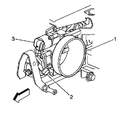

Here are directions specific to your vehicle for performing a throttle body service. The attached pictures correlate with the directions.
______________________
THROTTLE BODY SERVICE
REMOVAL PROCEDURE

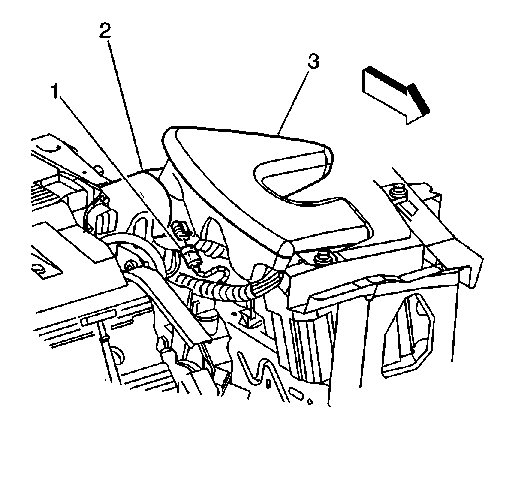

1. Disconnect the MAF sensor electrical connector.
Picture 1
2. Loosen the intake air duct clamps.
NOTE: Do not damage the MAF sensor screen. A damaged screen could restrict airflow and lead to a driveability concern.
3. Remove the mass air flow (MAF) sensor and air cleaner intake duct (2) as an assembly.

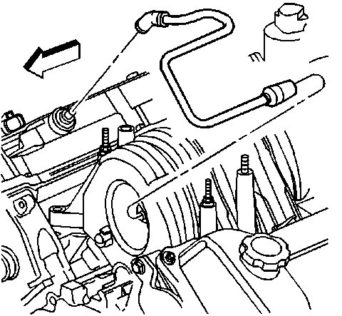

Picture 2
4. Inspect the throttle body bore (1) and throttle valve plate for deposits. Open the throttle valve to inspect all surfaces.
5. Clean the throttle body bore and throttle valve plate using a clean shop towel with GM Top Engine Cleaner, P/N 1052626 Canada P/N 993026, or AC-Delco Carburetor Tune-Up Conditioner, P/N X66-P, or equivalent product.
NOTE: Do not use any solvent that contains Methyl Ethyl Ketone (MEK). This solvent may damage fuel system components.

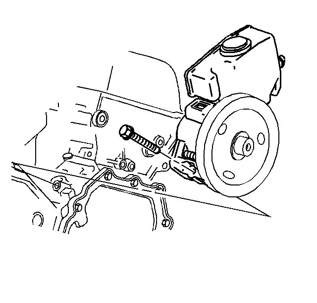

NOTE: The outlet of the air cleaner assembly and the MAF sensor inlet duct must line up when completely installed. Misalignment may cause incorrect airflow readings resulting in MIL illumination or a driveability concern. An improperly installed inlet duct assembly or air cleaner assembly may cause misalignment.
Picture 3
1. Install the MAF sensor and air cleaner intake duct (2) as an assembly.
NOTE: Refer to Fastener Notice in Service Precautions.
2. Tighten the intake air duct clamps.
Tighten the intake air duct clamps to 3 N.m (27 lb in).
3. Connect the MAF sensor electrical connector to the MAF sensor.

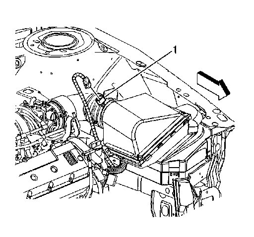

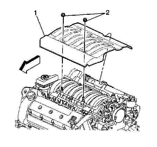

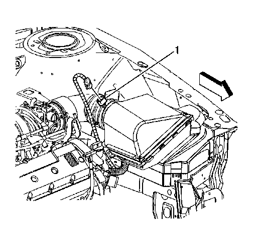

Next, you may want to consider cleaning the MAF sensor. Here is a link that shows in general how it is done.
https://www.2carpros.com/articles/mass-air-flow-service
Picture 4 shows the MAF location.

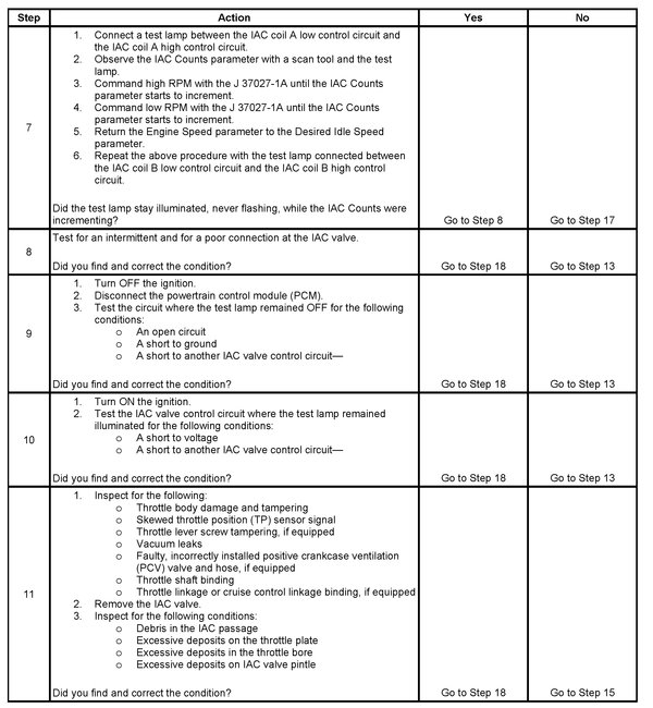

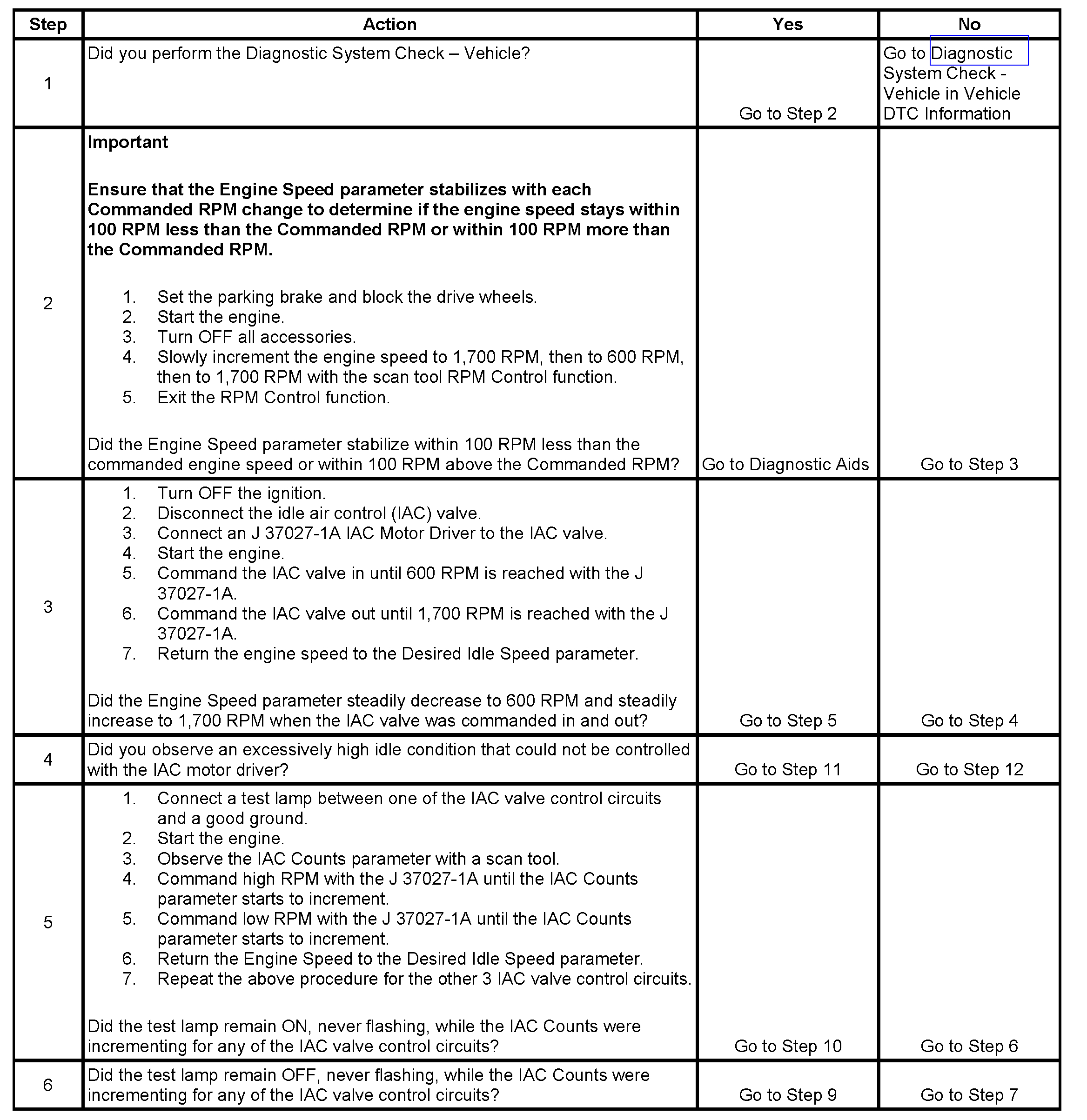

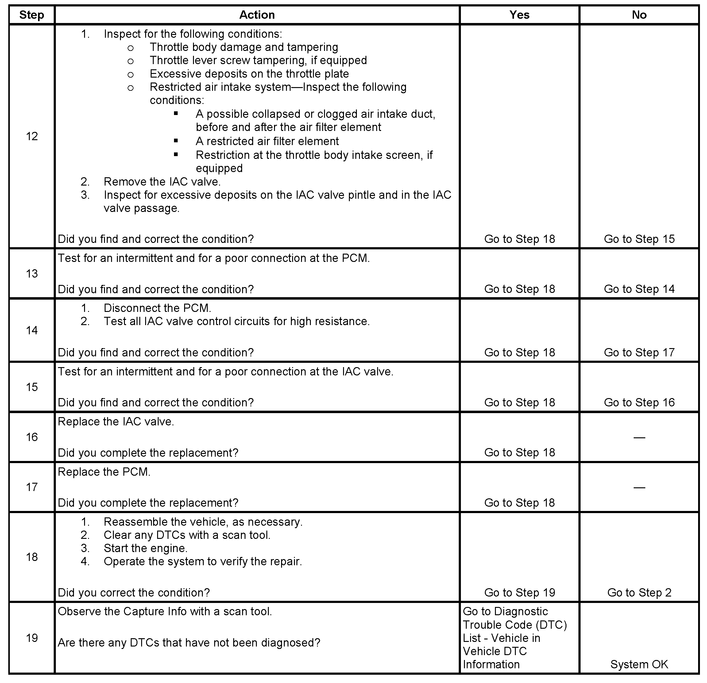

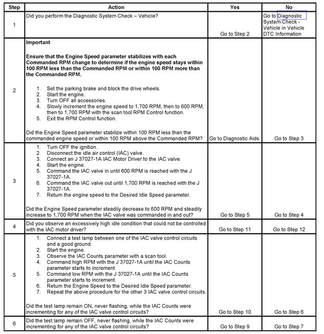

If nothing helps, then you will need to check the idle air control valve (IAC). The IAC is responsible for maintaining engine idle speed. Here are directions / flow chart for diagnosing a bad IAC. Before going to all the trouble of testing everything on the flow chart, remove the IAC and check it for carbon build up. Also, check where it goes into the throttle body to confirm nothing is blocked.
IDLE AIR CONTROL (IAC) SYSTEM DIAGNOSIS
CIRCUIT DESCRIPTION
The engine idle speed is controlled by the idle air control (IAC) valve. The IAC valve is on the throttle body. The IAC valve pintle moves in and out of an idle air passage bore to control air flow around the throttle plate. The IAC valve consists of a movable pintle, driven by a gear attached to an electric motor called a stepper motor. The stepper motor is capable of highly accurate rotation, or of movement, called steps. The stepper motor has 2 separate windings that are called coils. Each coil is supplied current by 2 circuits from the powertrain control module (PCM). When the PCM changes polarity of a coil, the stepper motor moves one step. The PCM uses a predetermined number of counts to determine the IAC pintle position. Observe IAC counts with a scan tool. The IAC counts will increment up or down as the PCM attempts to change the IAC valve pintle position. An IAC Reset will occur when the ignition key is turned OFF. First, the PCM will seat the IAC pintle in the idle air passage bore. Second, the PCM will retract the pintle a predetermined number of counts to allow for efficient engine start-up. If the engine idle speed is out of range for a calibrated period of time, an idle speed diagnostic trouble code (DTC) sets.

TEST DESCRIPTION
Steps 1 - 6
Picture 5
Steps 7 - 11
Picture 6
Steps 12 - 19
Pic 7
The numbers below refer to the step numbers on the diagnostic table.
5. This test will determine the ability of the PCM and IAC valve control circuits to control the IAC valve.
7. This test will determine the ability of the PCM to provide the IAC control valve circuits with a ground. On a normally operating system, the test lamp should not flash while the IAC Counts are incrementing.
