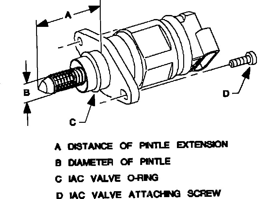

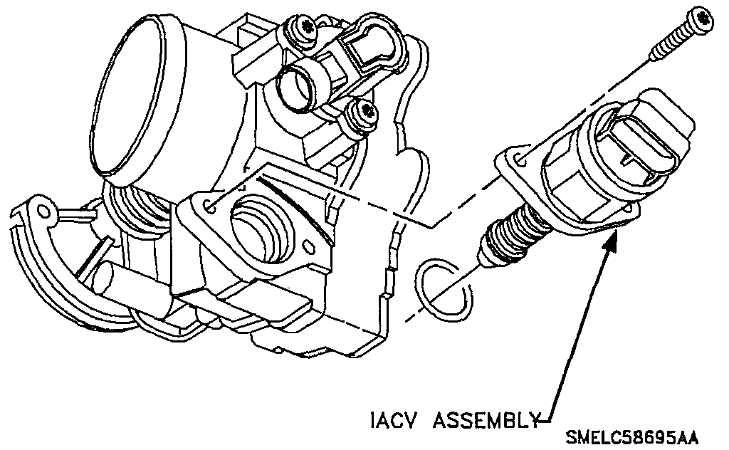

My car runs fine at start up, but once it's warmed up, it idles rough, bouncing between 400-600 rpm, and has started stalling when idling. It runs normally when driving at speed, the issue is only at idle. There are no codes and the check engine light is not on.
My plan is to replace plugs and wires, clean the throttle body and replace the the IAC. Any suggestions on what else should be checked? I've been searching the forums and the IAC, along with carbon build up in the throttle body, seem to be common issues. Any suggestions are appreciated.

Actually, you are right on with your ideas. Most commonly a bad idle is the result of a failing idle air control valve (IAC). The IAC is responsible for maintaining the engine idle speed. Also, an excessively dirty throttle body can be the cause as well. One thing you didn't mention is an engine vacuum leak, which can also cause a rough or uneven idle.

If you determine the IAC is bad, here are the directions for replacement. The attached pictures correlate with the directions.
IDLE AIR CONTROL (IAC) VALVE
Idle Air Control Service
pic 1
Idle Air Control Valve.
pic 2
REMOVAL
1. Turn ignition Off.
2. Remove air intake tube and resonator.
3. Remove electrical connector from the IAC valve.
4. Remove screws and IAC valve.
NOTE:
^ The IAC valve is an electrical component and must not be soaked in any liquid solvent; otherwise damage could result.
5. Remove O-ring from IAC valve and discard.
INSTALLATION
1. Clean the IAC valve seating surfaces on the throttle body to assure proper seal of the new O-ring and contact of the IAC valve flange.
NOTE:
^ Before installing a new IAC valve, retract the pintle using the Scan tool. Refer to Scan tool operating instructions.
^ Normal wear of the IAC pintle, characterized by a ring around the cone, is not an indication of a bad IAC valve.
^ If replacement is necessary, be sure to replace with an identical part. IAC valve pintle shape and diameter are designed for specific applications.
2. Lubricate new Oring with clean engine oil and install on IAC valve.
3. Insert IAC valve in throttle body.
4. Install IAC valve attaching screws using thread coating, Saturn P/N 21485277 (Loctite 242 Threadlocker or equivalent).
Torque: 3 NM (27 in. lbs)
5. Connect electrical connector to IAC valve. Push in connector until a click is heard and pull back to confirm a positive engagement.
