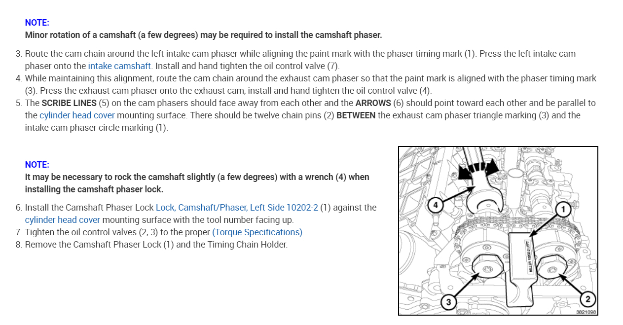

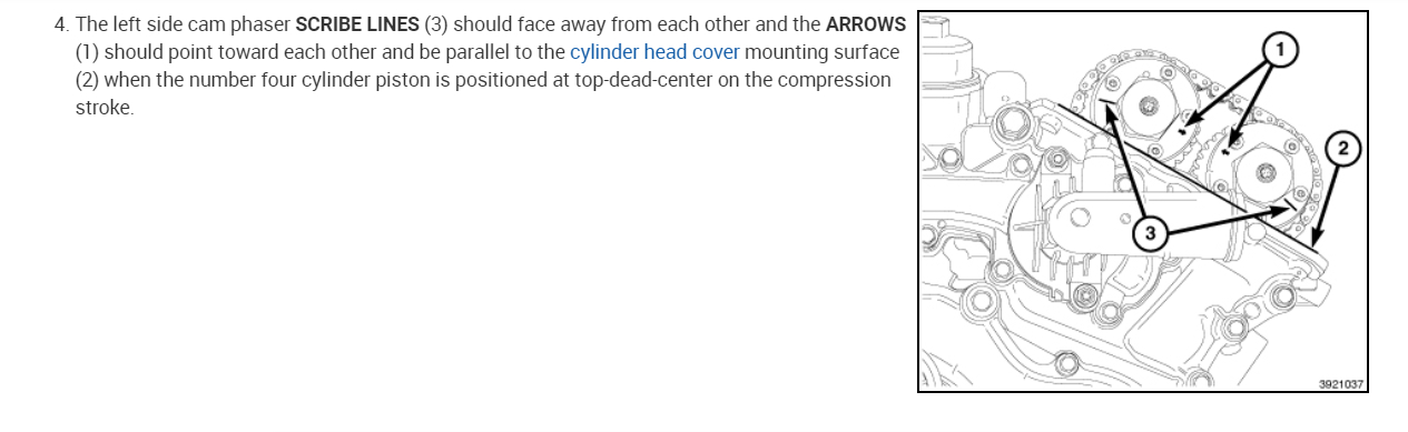

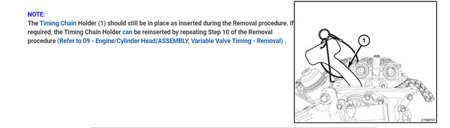

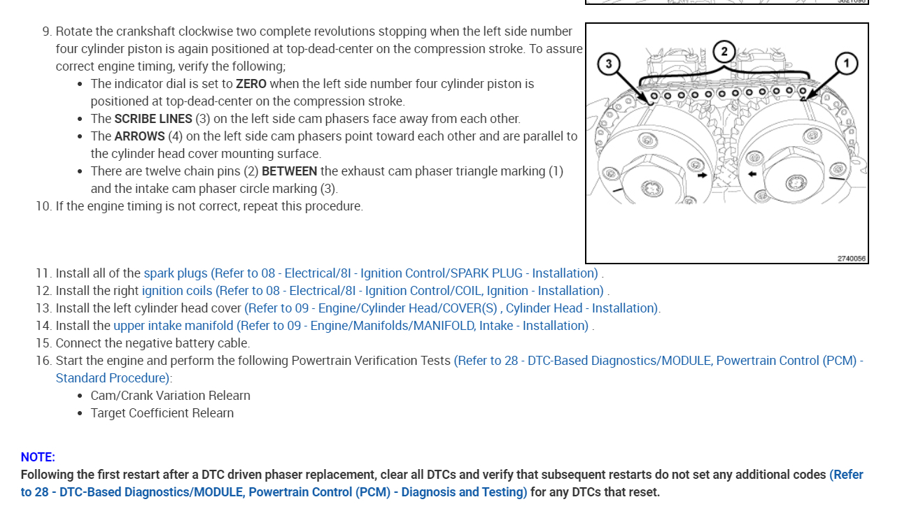

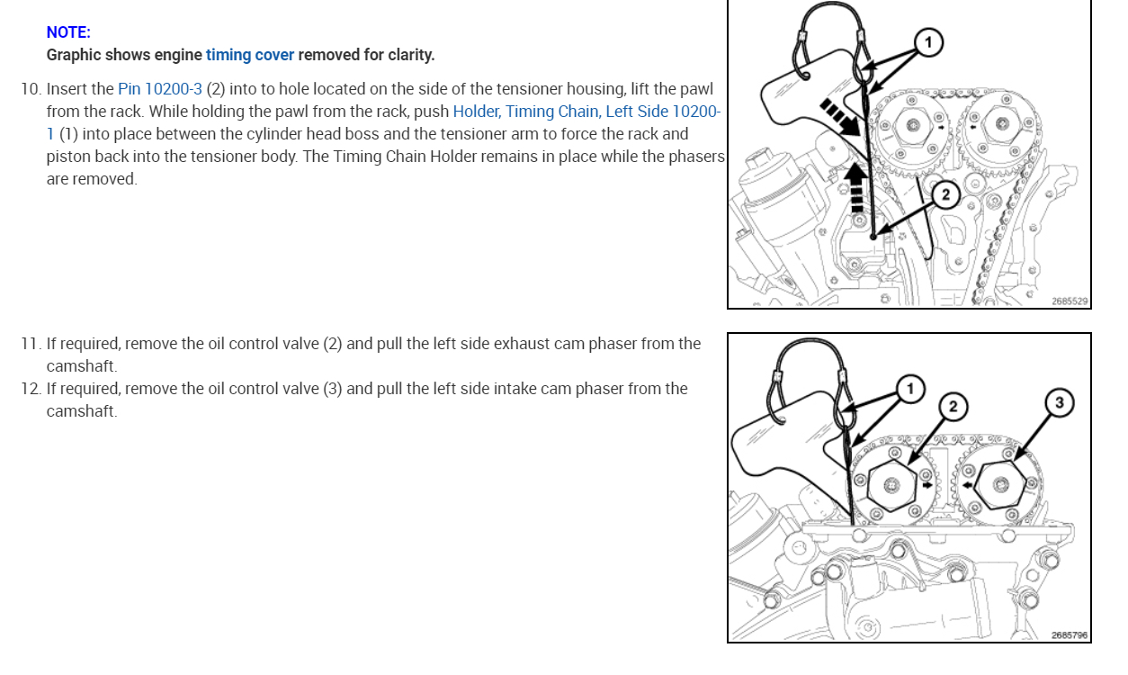

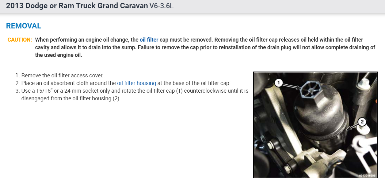

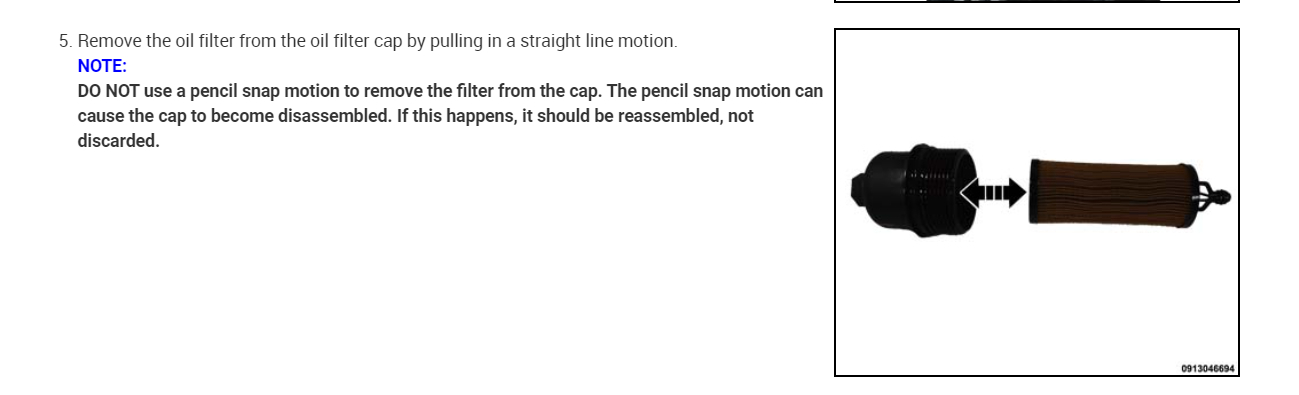

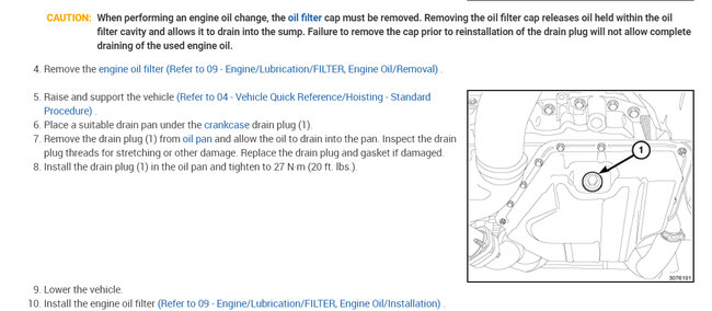

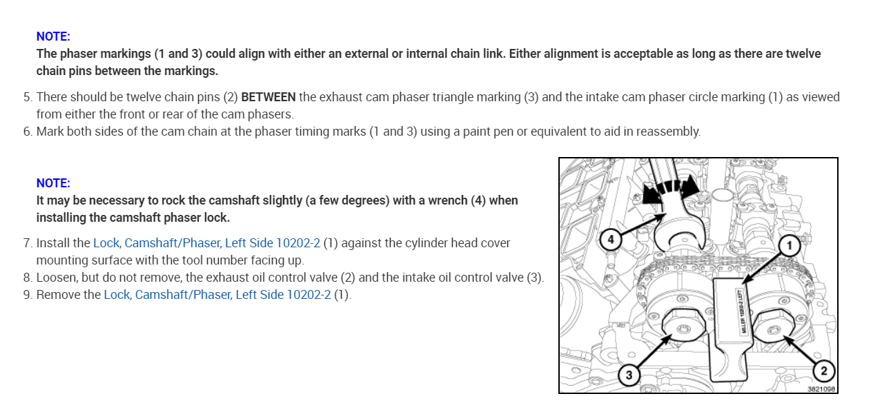

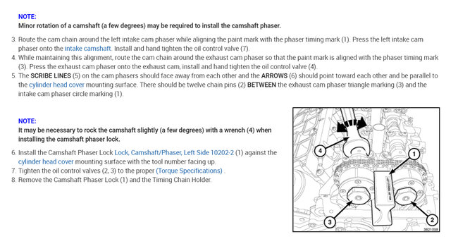

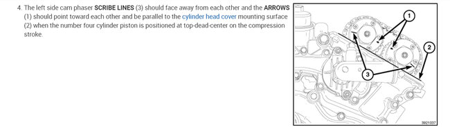

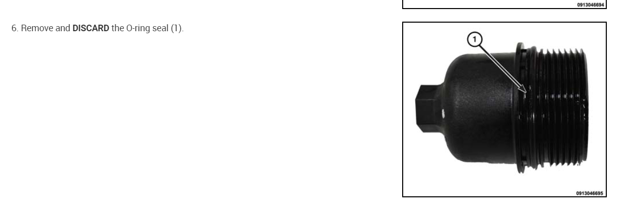

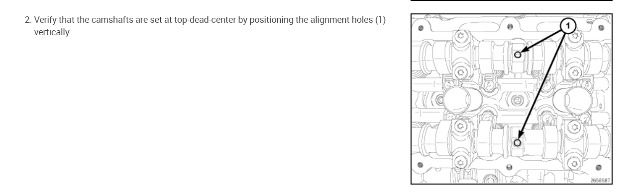

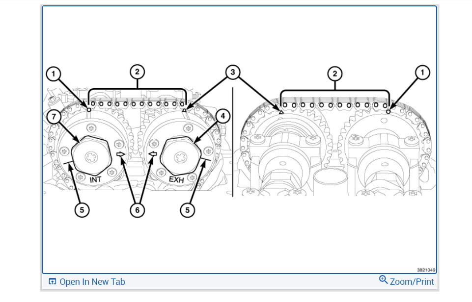

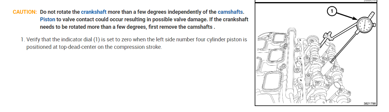

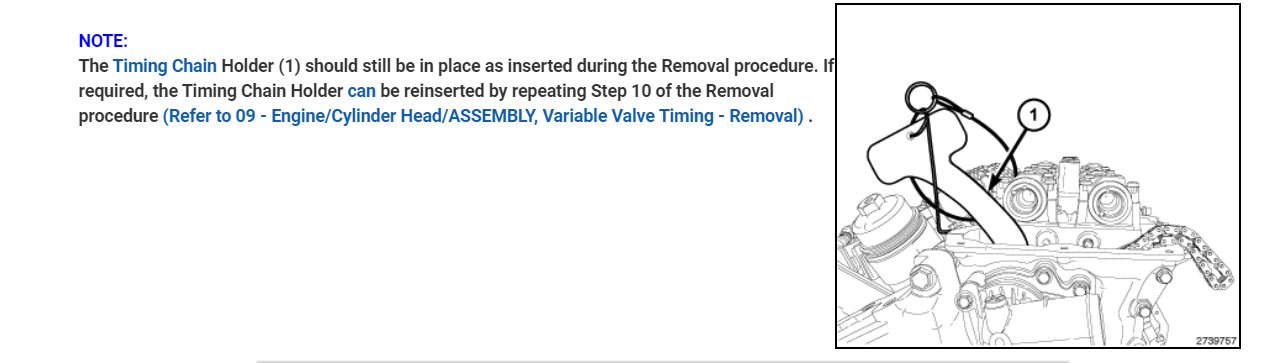

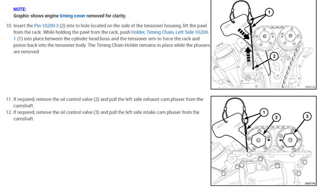

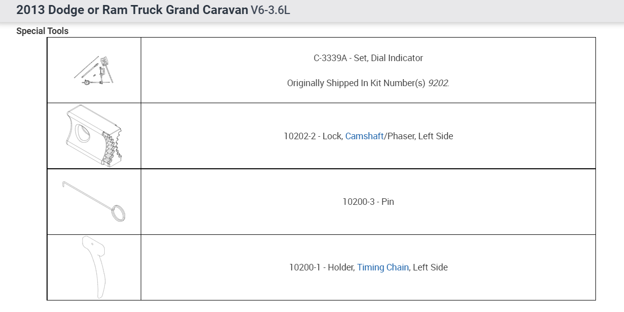

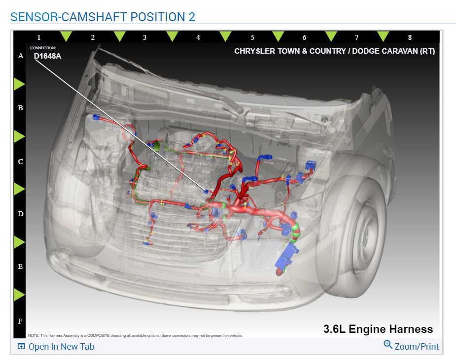

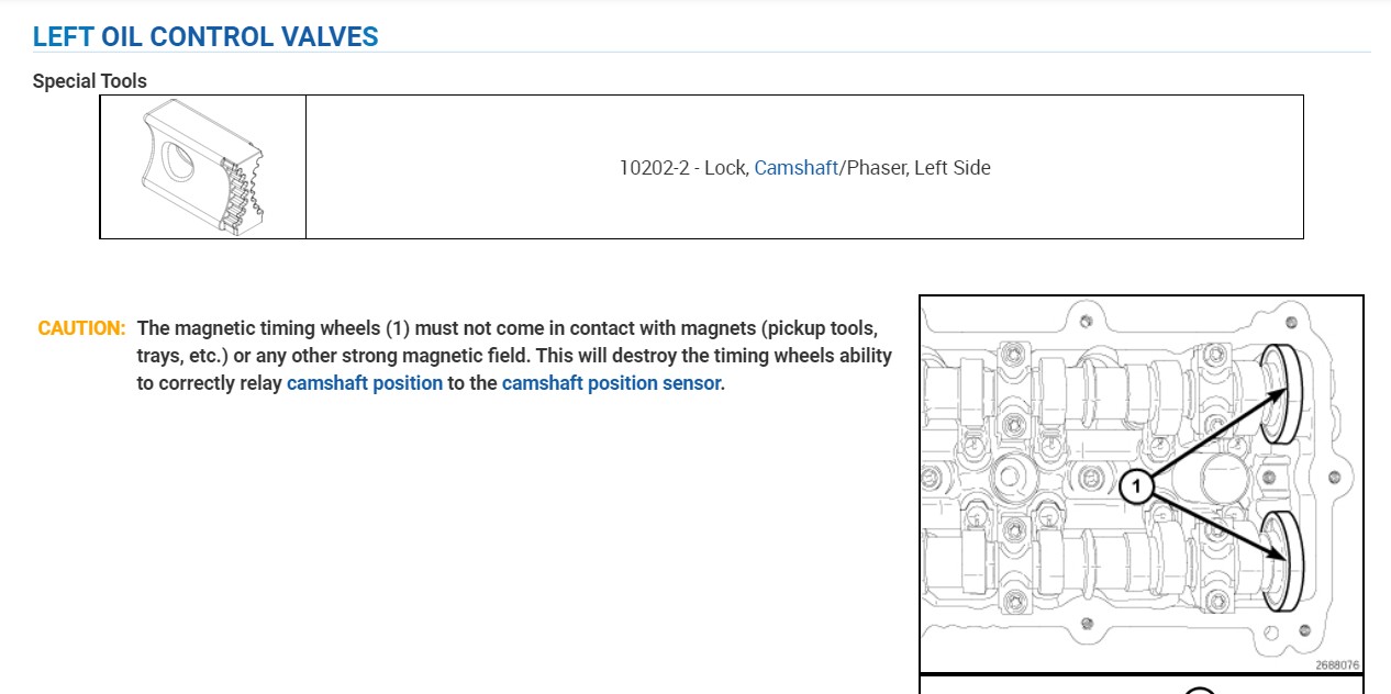

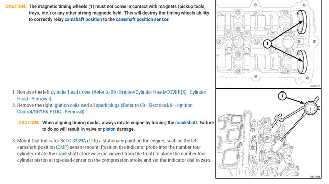

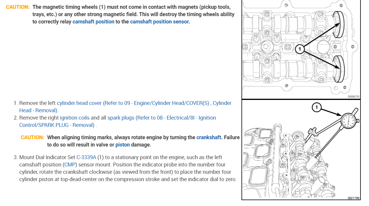

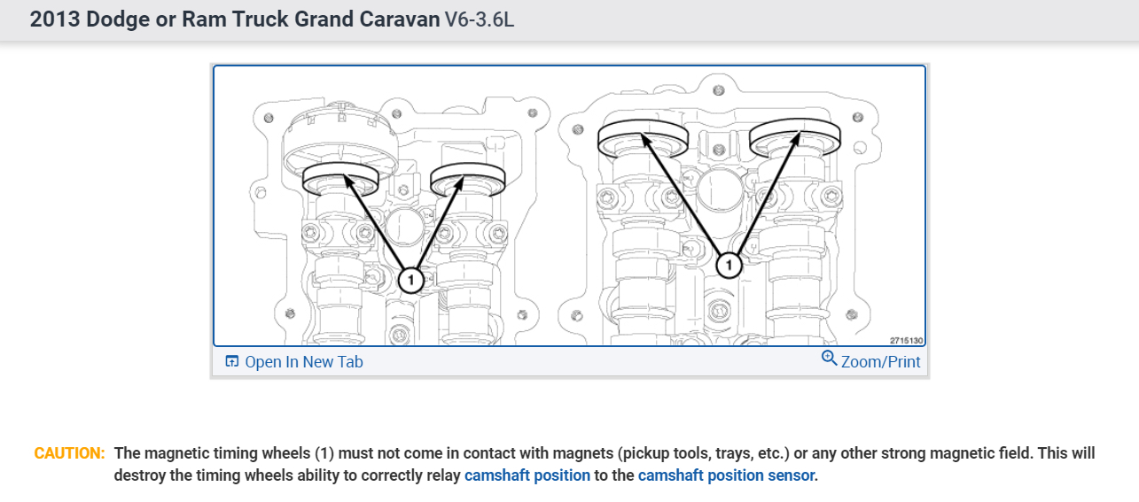

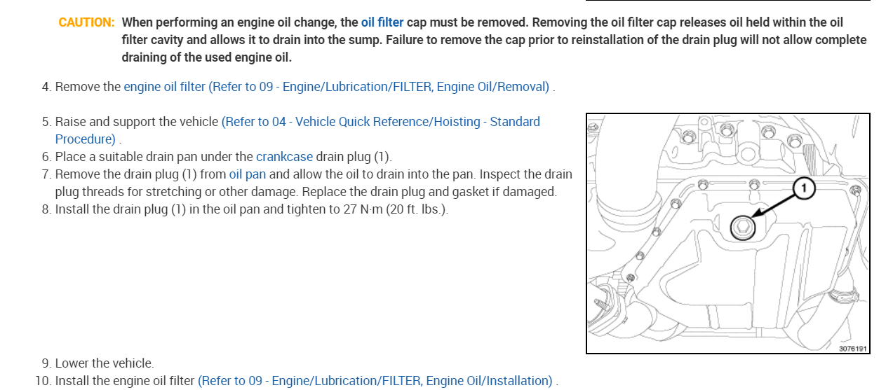

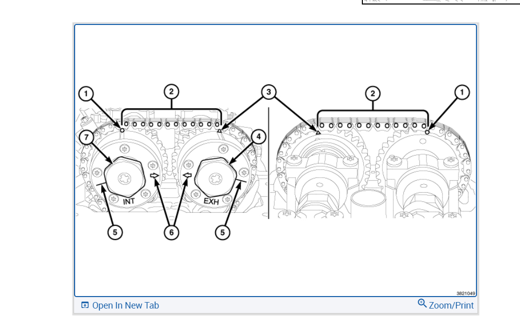

The P0018 Crankshaft Position- Camshaft Position Correlation (Bank 2, Sensor A) so this can be caused by low or dirty engine oil, so I would start by changing the oil and filter and it will cause a rough idle condition as well. This generic guide will help walk you through the service with instructions in the diagrams below, also use a good grade of oil. If this doesn't fix the problem, you will need to replace the left bank.
Here are the instructions for that as well:
https://www.2carpros.com/articles/how-to-change-engine-oil-and-filter
Check out the images (below). Let us know what happens and please upload pictures or videos of the problem.
