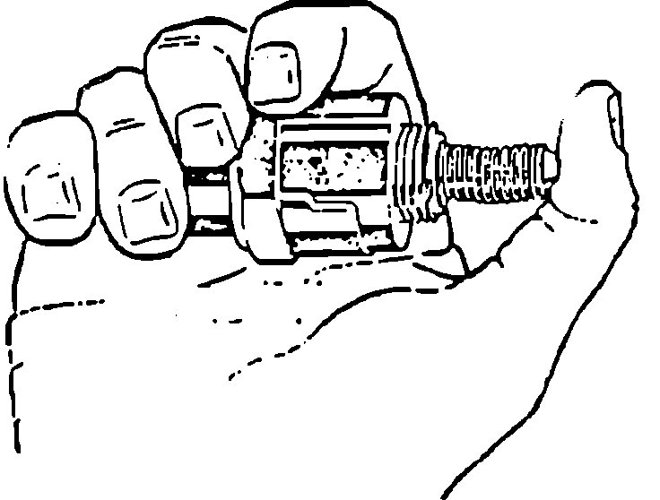

It sounds like not enough air is getting to the engine at idle. There is a component called an idle air control valve. It basically allows air to enter the engine when at an idle. I have a feeling that is the issue or the throttle body needs cleaned.
First, here is a link that explains how to check a throttle body. Try this first.
If that doesn't help, then I need you to remove the idle air control valve (IAC). I am going to provide the directions for replacement of the IAC. However, before you replace it, confirm that both the pintle valve on it and where it enters the throttle body are clean and free of carbon or dirt. That is the only place air enters when the throttle plate is closed.

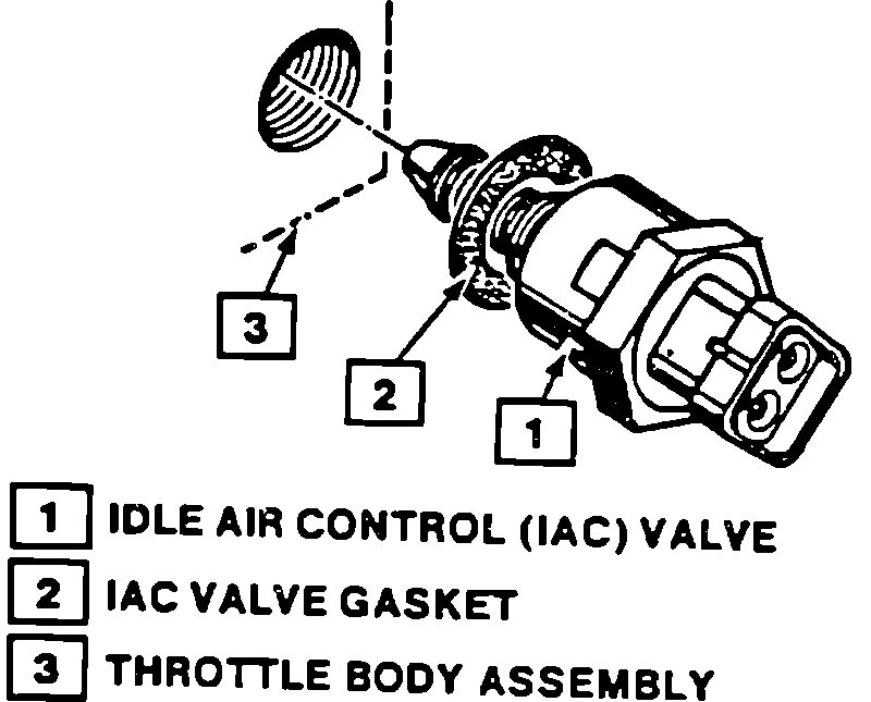

Here are the directions. The attached pics correlate with the directions.
IDLE AIR CONTROL (IAC) VALVE REPLACEMENT
IAC Thread Mounted 10mm Pintle
picture 1

REMOVE OR DISCONNECT
1. Disconnect electrical connector.
2. Remove IAC valve, use a 32 mm (1 1/4") wrench.
3. Remove IAC gasket and discard.
4. Clean old gasket material from surface of throttle body assembly to insure seal of new gasket.

Idle Air Control Valve Pintle Retraction (Manually)
picture 2
NOTES:
^ If the IAC valve was removed during service, its operation may be tested electrically with the IAC/ISC Motor Tester (J-37027 or BT-8256K) or equivalent. Before installing a IAC valve, measure the distance between the tip of the valve pintle and the mounting surface. If the dimension is greater than 28.0 mm (1.10 inches), the valve pintle must be retracted to prevent damage to the valve. This may be done electrically using an IAC/ISC Motor Tester or manually by exerting firm pressure, as shown in the illustration, with a slight side to side movement on valve pintle to retract it.
^ No physical adjustment of the IAC valve assembly is required after installation. The IAC valve pintle is reset by turning the ignition ON for ten seconds and then OFF. The ECM then resets the pintle to the correct position. Proper idle regulation should result.
INSTALL OR DISCONNECT
1. Install the IAC valve into throttle body with new gasket.
NOTE: New IAC valves have been reset at the factory and should be installed in the throttle body in an "as is" condition, without any adjustment.
2. Tighten IAC valve assembly to 18.0 Nm (13.0 lb-ft).
3. Reconnect electrical connector to IAC valve.
4. "START" engine and allow it to reach operating temperature.
