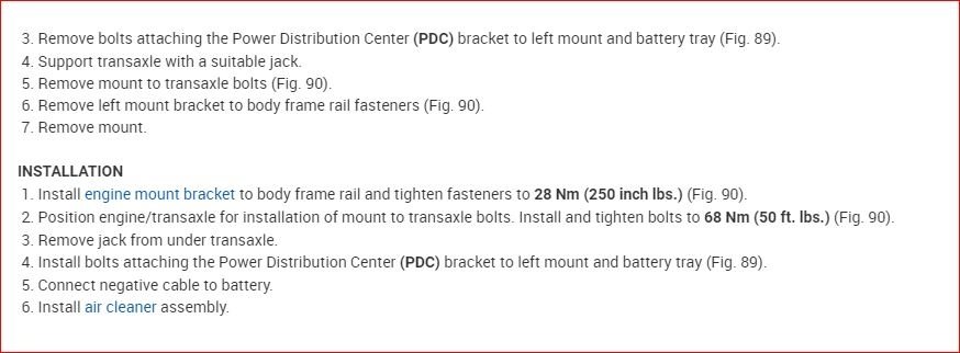

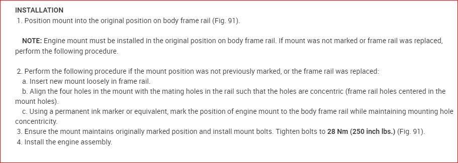

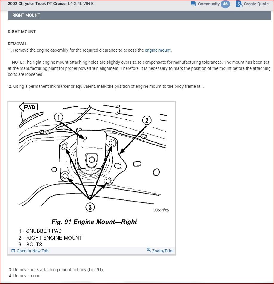

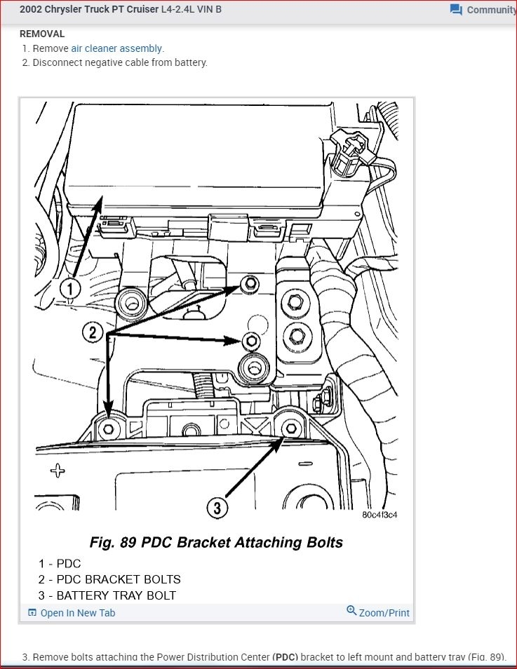

Have you checked mounts? These vehicles are known for having engine mounts wear out and they ground the engine and you feel all the engine pulses through the vehicle.

I believe it could be mounts as the ones on this car are worn out. Thank you. It has been tough to think as i am going through chemo treatments. Again thank you.
