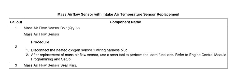

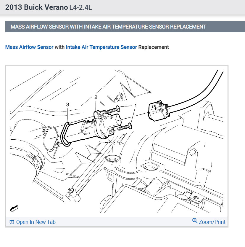

I then cleaned the MAF, MAP, Throttle Body, and checked for any Vacuum leaks but couldn't find any (sprayed carb cleaner everywhere with no noticeable idle change then tried water). I was due for spark plugs, so I went ahead and replaced all 4 with OEM and did an oil change with no change to the rough idle. except one time I saw a P0303 code which went away and reverted back to the P0300.
