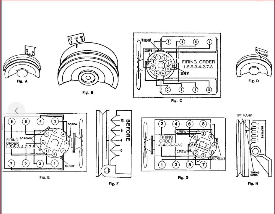

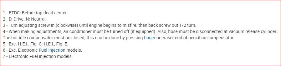

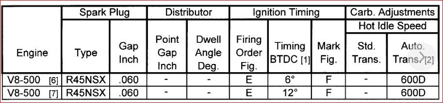

I now have set at 6 degrees advance, but with rough running, can't get to run very slow, maybe 800 RPM, and even then stalls when put in drive. I do have vacuum off and plugged when timing. Specs. call for 600 RPM idle, so maybe centrifugal advance is messing up. I'll try to get it slowed down, advance timing a little, idle speed screw a little, when next can, next two days, and tell you how it goes. Some folks say up to about 10 degrees is where they advance to, so I'll try that. I'll check number one at Top Dead Center, make sure timing mark, rotor, are where they belong.

Okay. Sounds like you have a few things to try but just remember that we always set timing first. Then go back and set idle mixture and idle speed. Moving the timing will affect your carburetor settings. So I would get the timing advanced to about 10 like you said because 6 is the low end of the spec. Then go back and tune the carburetor.
