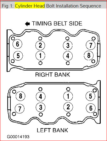

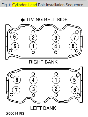

CHRISTIANA.DENISE
Head bolts.
Aug 5, 2018 at 6:20 PM
DANNY L
  • 5,648 POSTS
Hello again.
I have attached a picture of the head bolt tightening sequence.They are to be torqued 76-84 Ft Lbs. Let me know if you need any other specs. Hope this helps and thanks for using 2CarPros.
Danny-

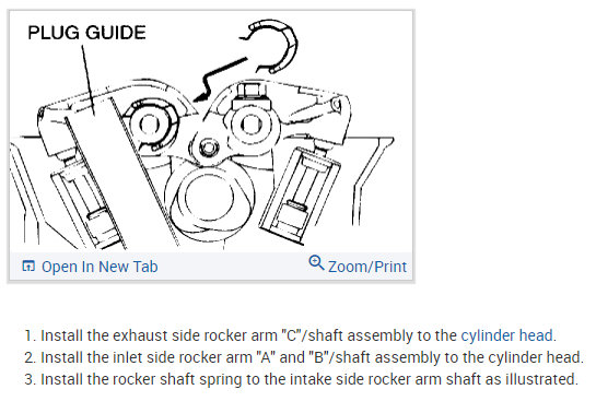

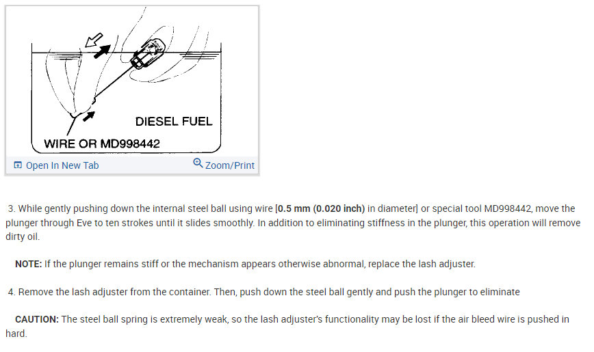

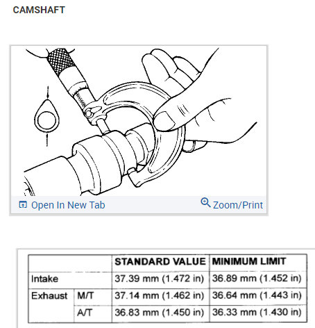

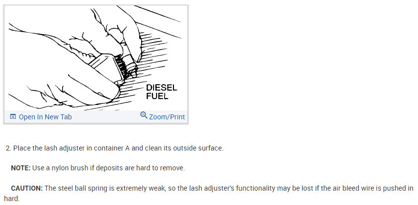

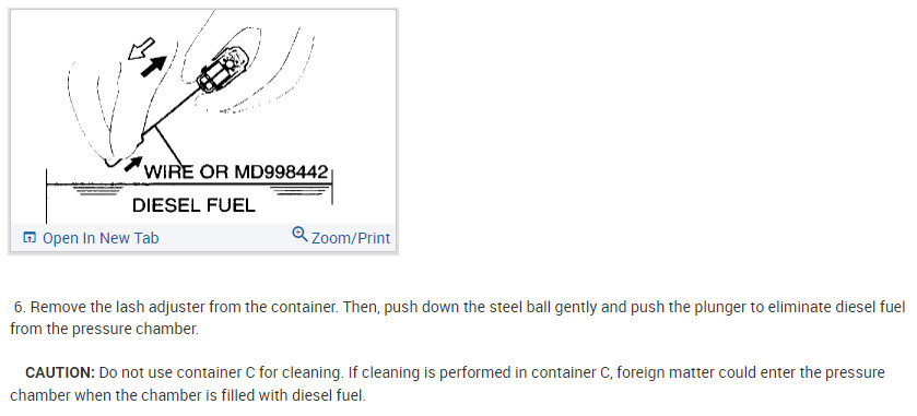

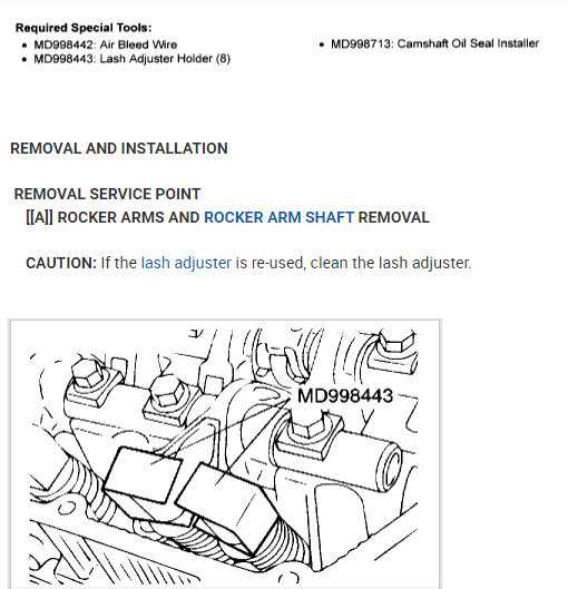

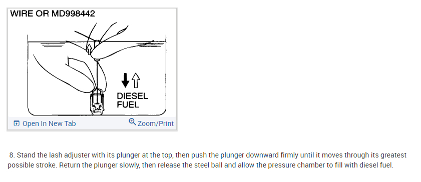

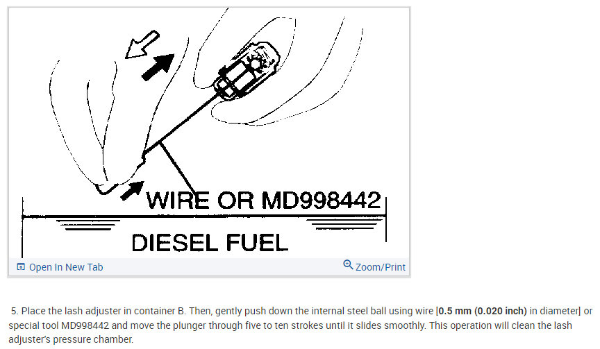

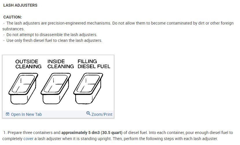

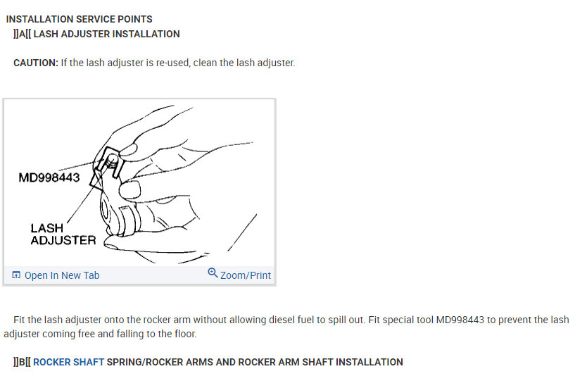

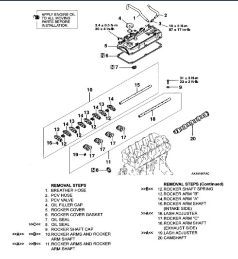

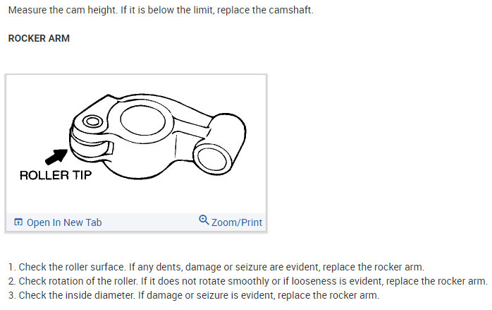

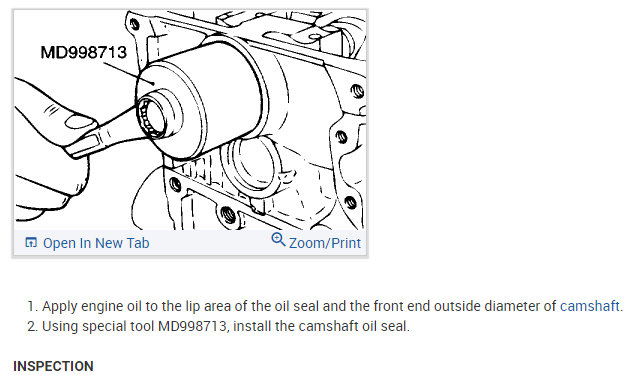

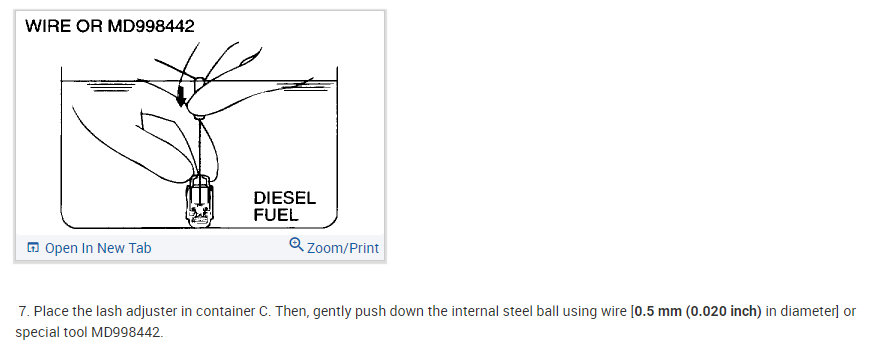

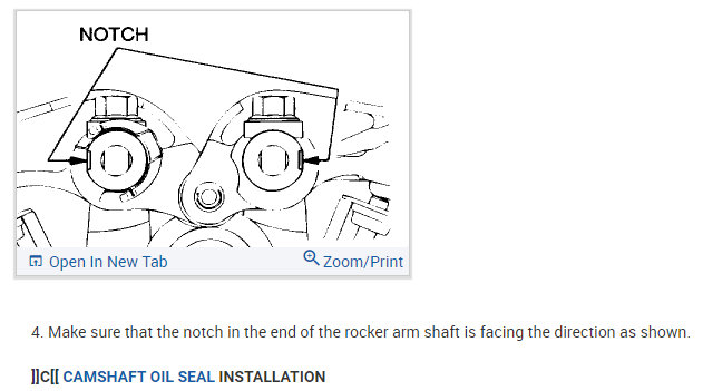

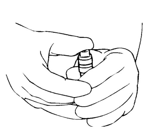

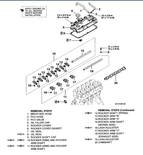

On a mitsubishi 2003 2.4 liter, does the head need to have the timing set to put the rocker on?
Mar 11, 2021 at 10:36 AM
DANNY L
  • 5,648 POSTS
Hello, I'm Danny.
Here is the information you requested. Yes, having the timing set will aid in properly adjusting the valves which are controlled by the rocker arm assembly. I've attached picture steps below for your Eclipse 2.4L. Let us know if you have any further questions on this issue. Hope this helps and thanks for using 2CarPros.
