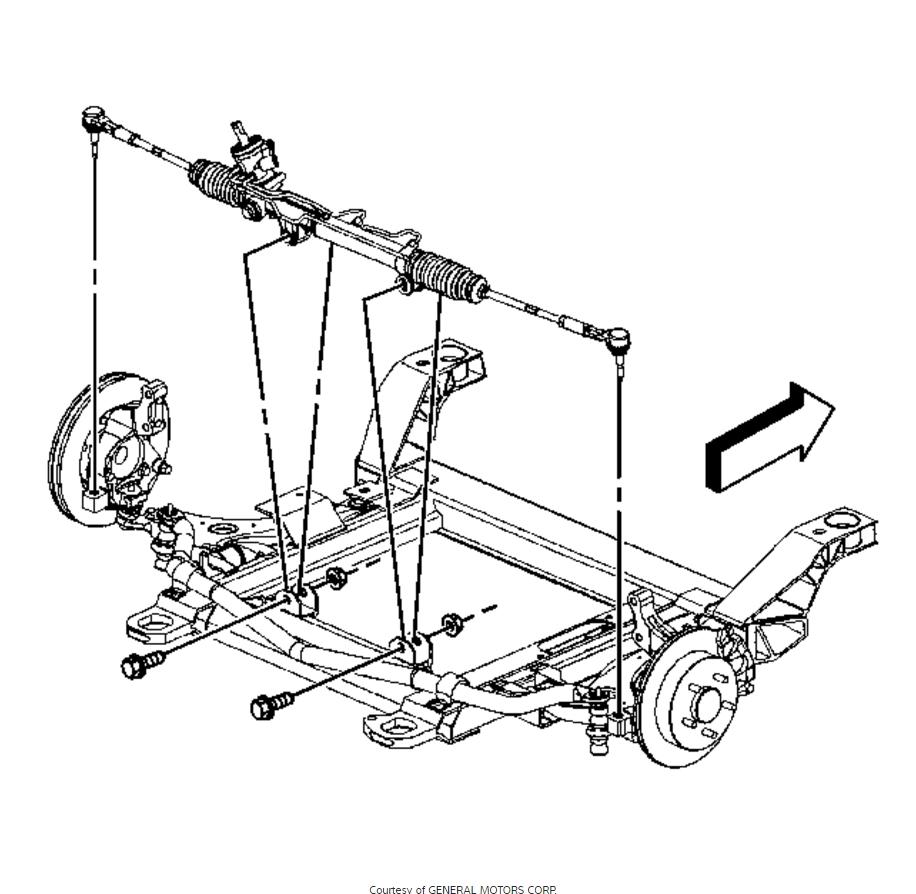

The rack and pinon is failing and I need to removed it, can you help me by sending me the directions on how to remove it please?

First jack your car up safely by following this guide

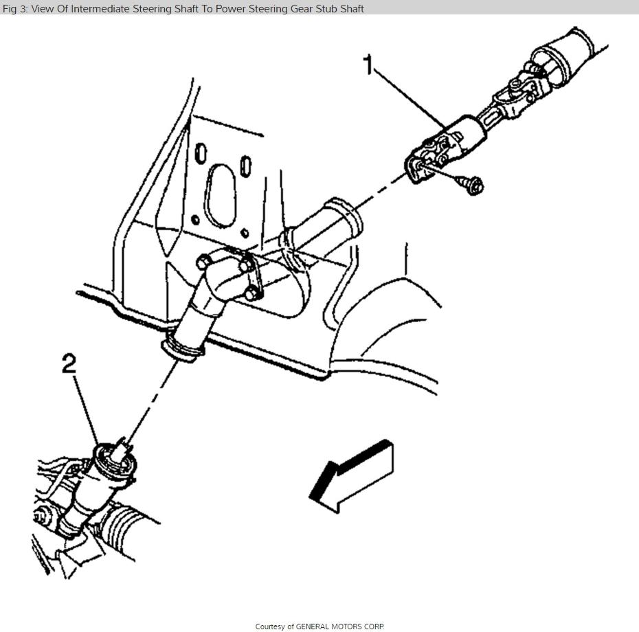

Then undo the bolt to the steering column, followed by the tie rod ends follow the guide below:
https://www.2carpros.com/articles/tie-rod-end-replacement
Next, would be the power steering lines be sure to have an oil drain pan ready because fluid will leak out at this point.

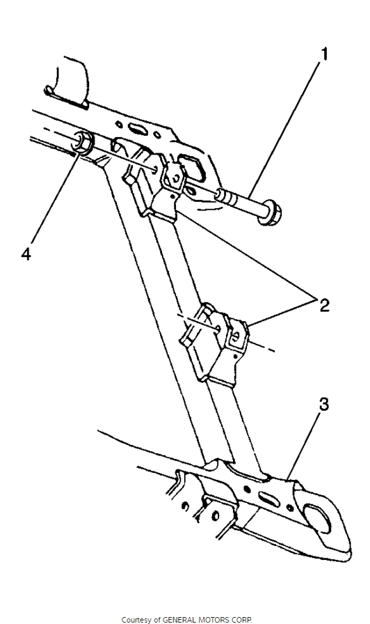

Next: Remove the main rack mounting bolts.
Once the rack is out match it too the new unit, and reverse these instructions to reassemble , please let me know if you have any further question or problems you would like help with.
