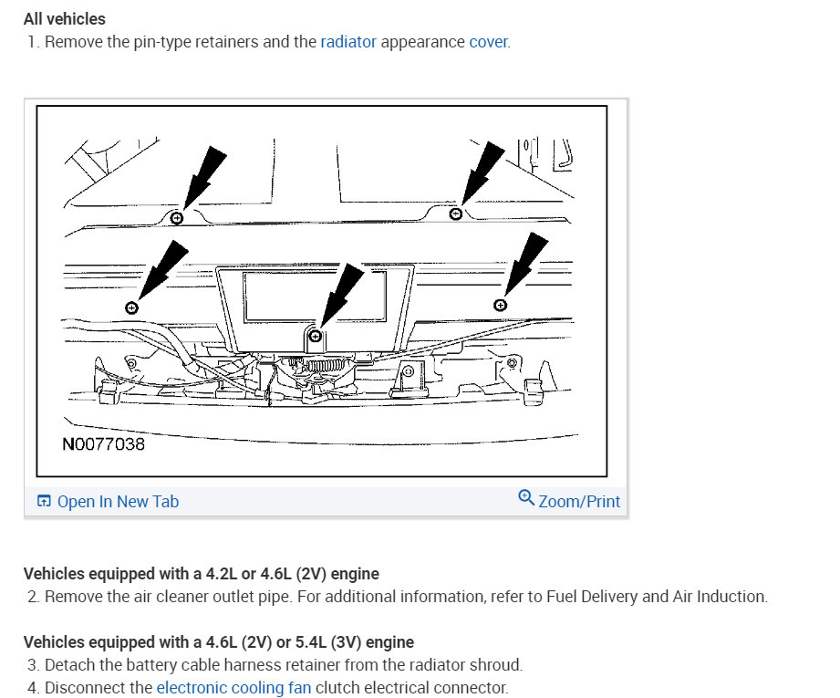

So, when my truck is running between 10 and 45 MPH there is a roaring noise on the passenger side of my engine, and the A/C will stop cooling in and out. The compressor stays running, but it won't be cool air. It's not an exhaust leak. Not rotor noise. Not misfiring. Transmission shifts fine. I've recently fixed just about everything you can think of. All coil packs. All plugs. Catalytic converter on bank 1 side. Cleaned throttle body and intake system. It's just lacking power between that 10 and 45 MPH. Could ignition coils be the culprit? I'm running out of ideas on what the issue could be.
Jun 7, 2022 at 10:28 AM
  • 55,732 POSTS
It sounds like you may have two problems, the first I would check the fan clutch because it sounds like it is locked up which will cause the noise and the low power you have described. Please start a new question for the A/C problem

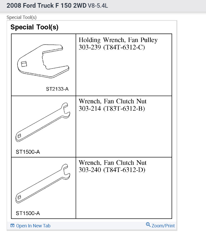

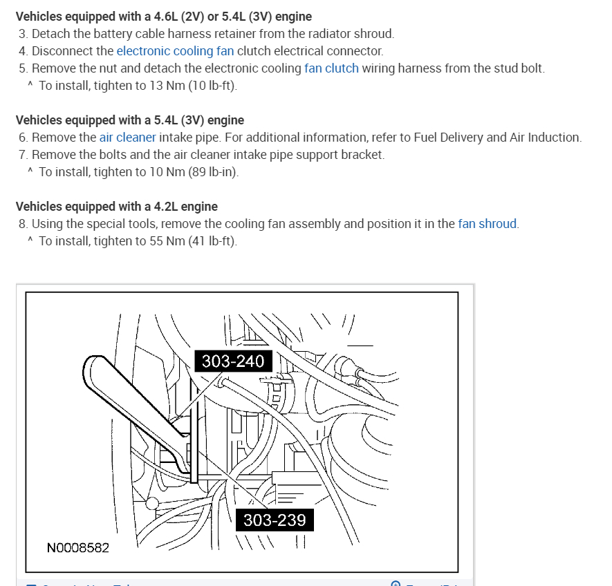

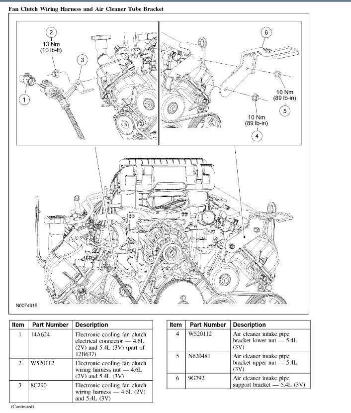

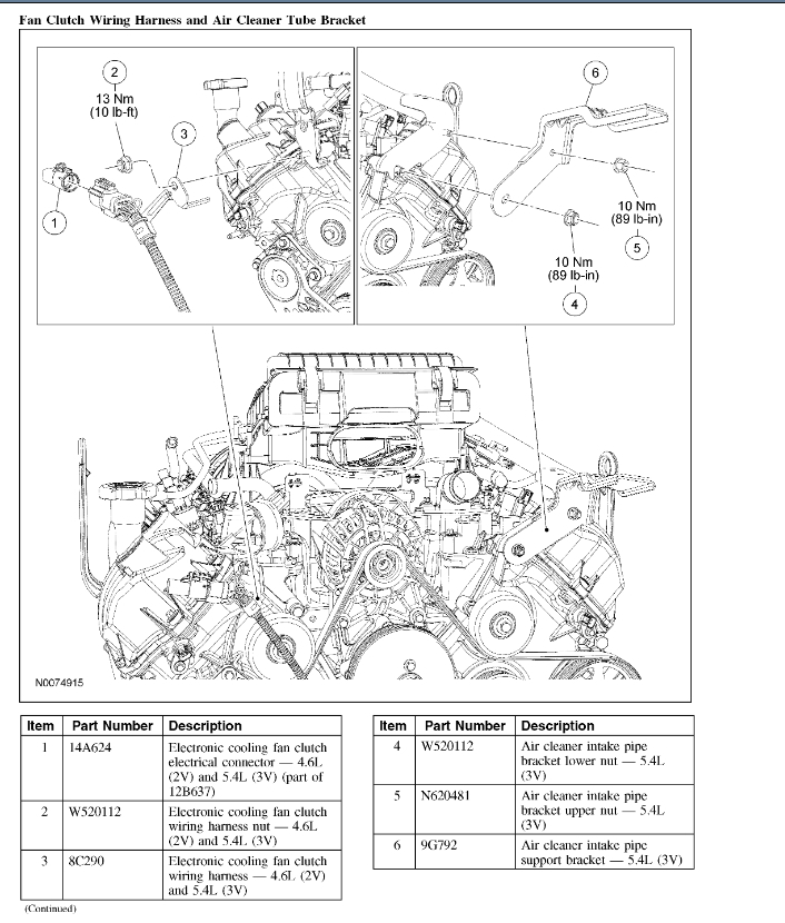

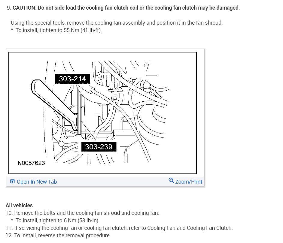

Here is a generic guide on how to remove the fan clutch and how to tell if it is bad. With instructions for your truck in the diagrams below:
https://www.2carpros.com/articles/fan-clutch-symptoms
and
https://www.2carpros.com/articles/fan-clutch-removal
Check out the diagrams (below). Let us know what happens and please upload pictures or videos of the sounds or the problem.
