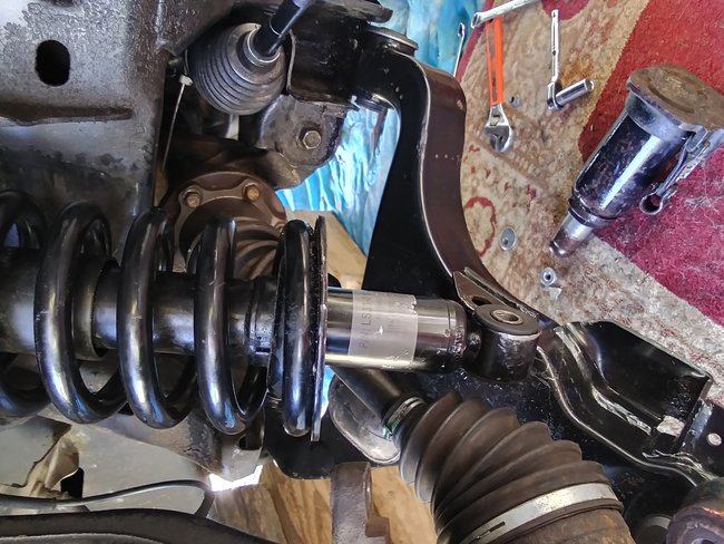

I'm trying to install the lower control arm, the problem i'm having is getting the shock mounted. i have tried taking the shock and strut apart at top and trying to hit those 3 screws is a real problem. i have tried trying to get shock on and it's giving me fits. can you help me figure out how to get this lower control arm mounted please?

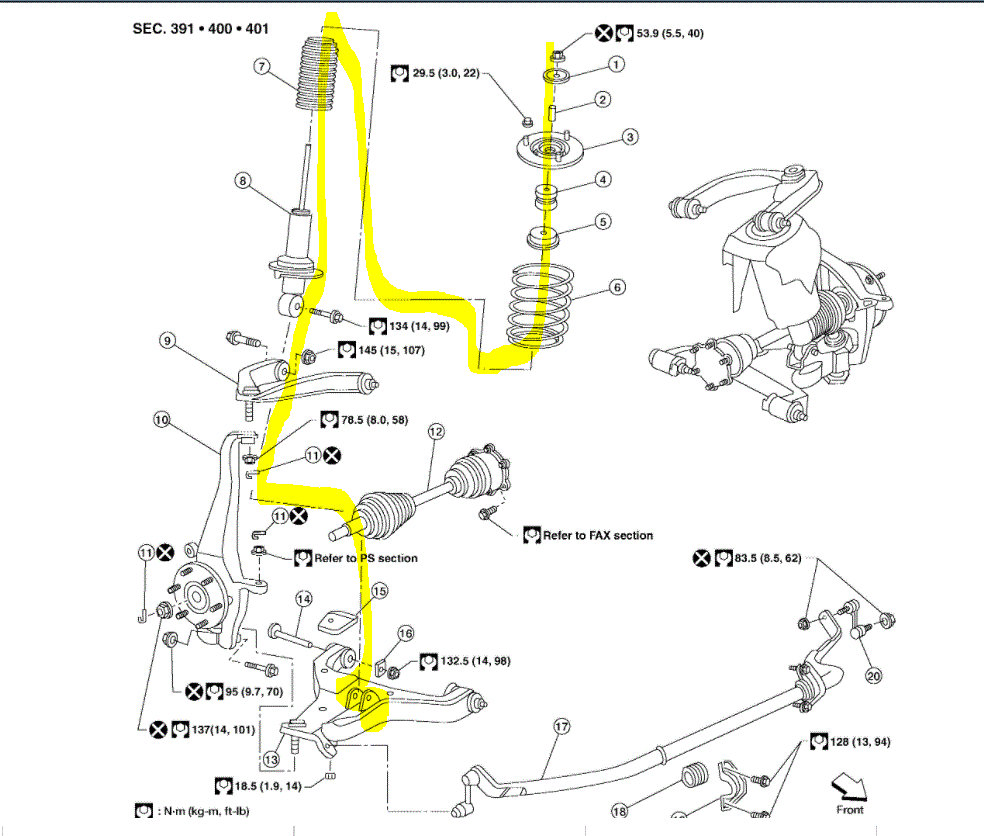

The strut assembly needs to be assembled. I attached a pic below. Can you explain which end you are having trouble with? Do you have both ball joints attached already? You will likely have to separate one place the assembly in and then apply pressure to reattach the ball joint.

Ball joints are on already. just need to know what is the best way to install shock?

I always start at the top so the bolts go up through the strut tower and place the nuts on them to hold it in place. Then, it usually isn't an issue to get the bottom in place. However, if that isn't working, the only thing I can suggest is to remove the lower ball joint get the strut in place, and then reinstall the ball joint.
If that doesn't work, I need you to take a pic of what you are dealing with and upload it for me to see. Hopefully, I'll see what is happening.

This is my problem. i think taking out ball joint is the answer.

Wow! That is so close. Is there any way you can pry it into place? If not, the only thing I can suggest is to remove the lower ball joint, get it into position, and then you may need to use a floor jack to push the control arm high enough to reinstall the ball joint.

Man i finally got it, had to take steering knuckle out , then put ball in at bottom, and get spindle thru hub, then get reattached to the upper. was a pain but it's in. thank you
