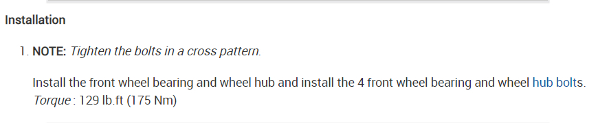

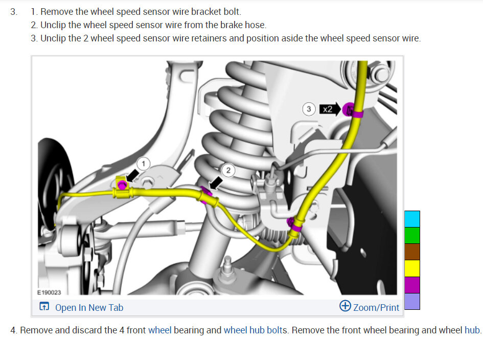

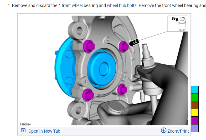

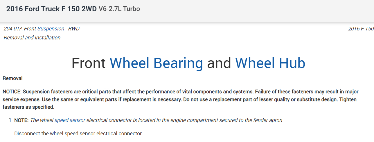

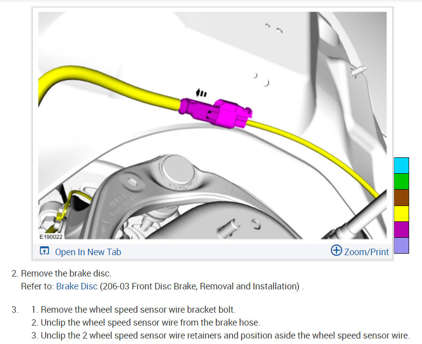

Can you check please recheck the front and rear pads. Sometimes the noise can seem like it is coming from the front, but the problem can be in the rear. This is a classic brake pads noise. If the pads are okay, it must be the bearing hub, they can go bad even though they don't have play. How does the wheel sound when you just spin it? Here is how to change the bearing hub out in case you need it. Check out the images (below). Please upload pictures or videos in your response of any problems so we can see what to help you with.
