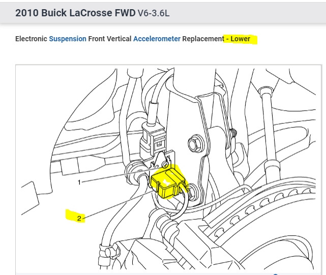

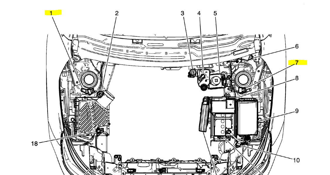

I need to replace the Accelerometer on my car listed above, but I don't know where it is. I need help in locating it.
Oct 18, 2023 at 6:11 PM
  • 110,241 POSTS

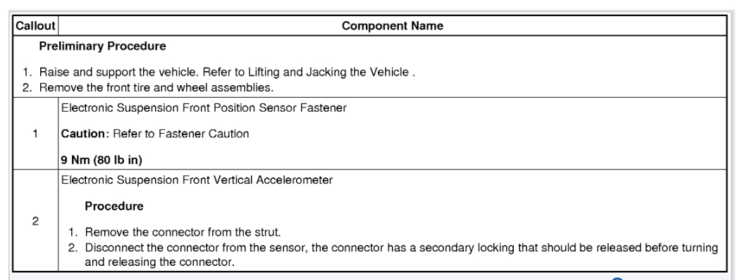

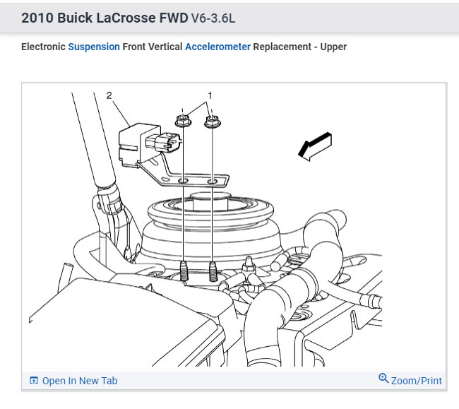

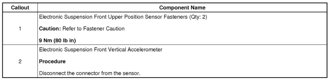

If you look below, pic 1 shows the upper sensors. Pics 2 and 3 are the directions for replacing the upper. The remaining pics are for replacing the lower.
Take a look through this and let me know if it helps or if you have other questions.
