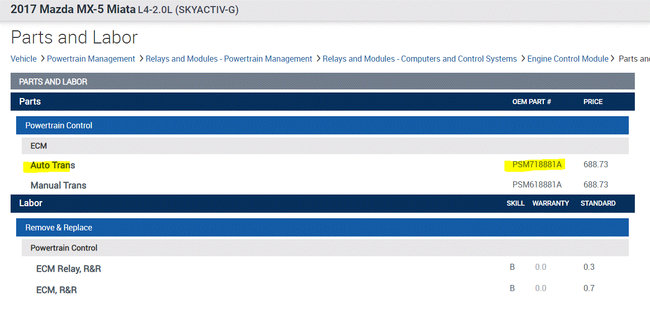

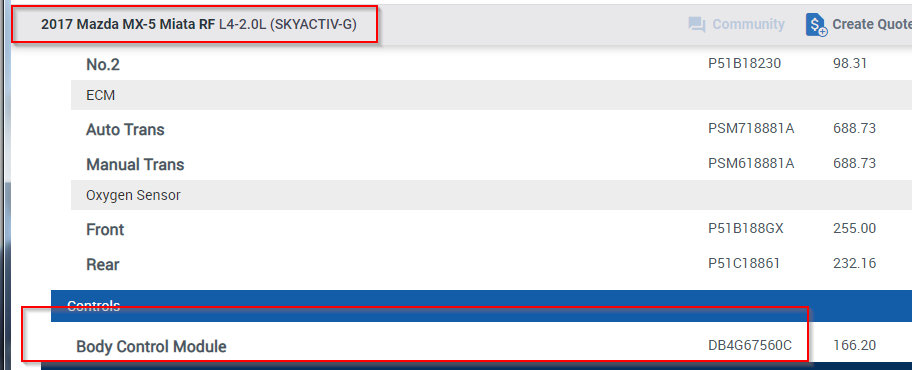

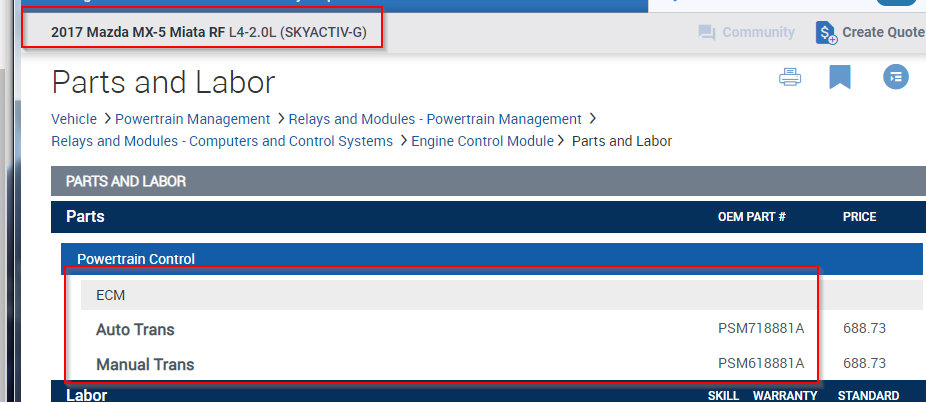

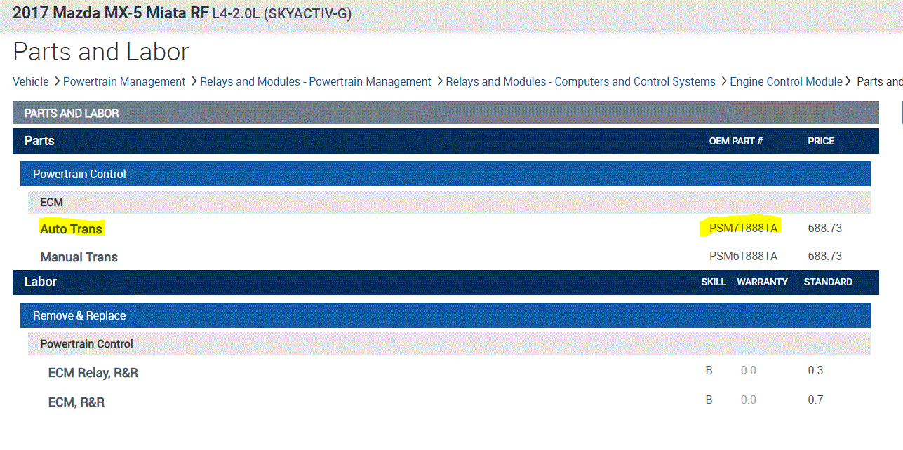

I need to know if a new ECU I purchase has to be from a hard top or soft top.
Mar 13, 2021 at 12:56 PM

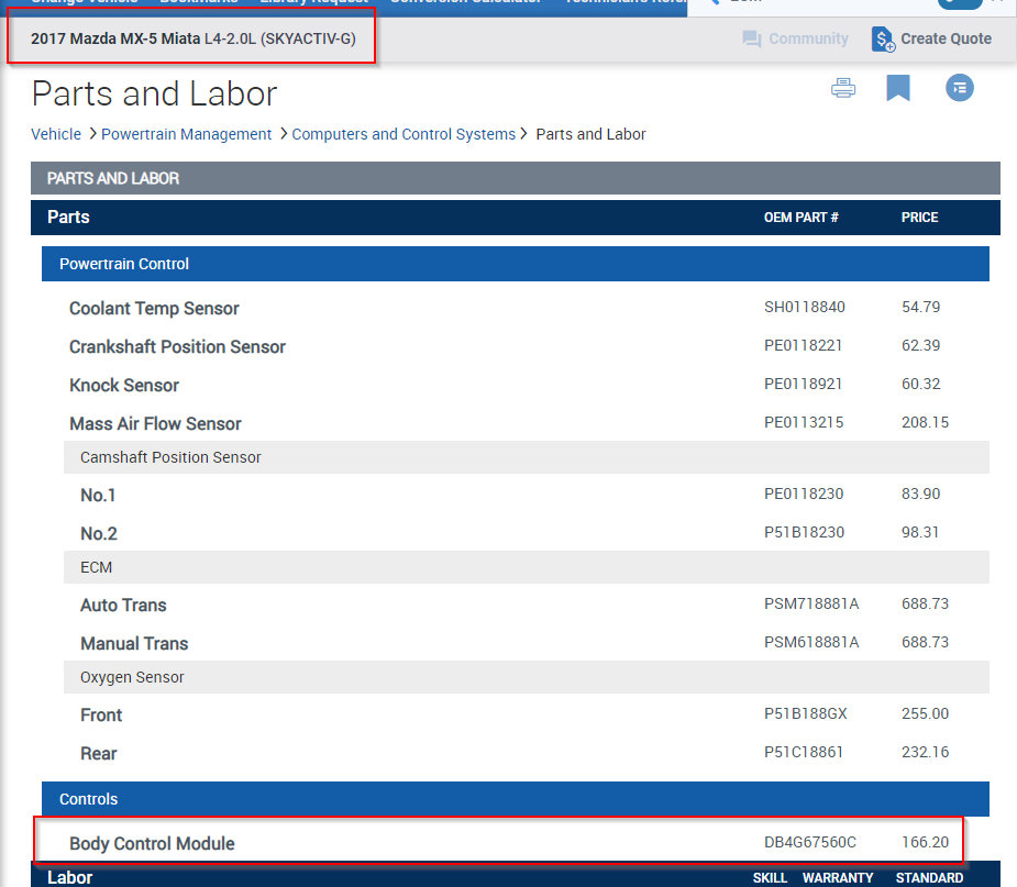

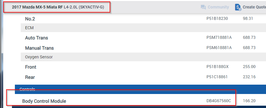

When you say ECU, which ECU are you talking about? There are many ECUs on a vehicle. I assume you mean either the body computer BCM, or the engine computer, ECM.

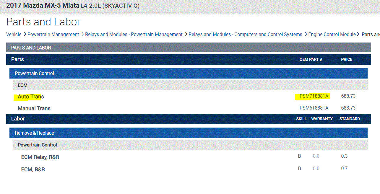

I don't show a different ECU for these systems depending on RF or not so let me know if you had something else in mind. Below is the part numbers for each.
Let me know if you need other info. Thanks
Mar 15, 2021 at 12:28 PM
  • 110,244 POSTS

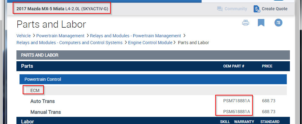

I looked up the part numbers for both. They are listed as the same part. If you look at pic 1 below, it is for the RF model. The second is soft top.

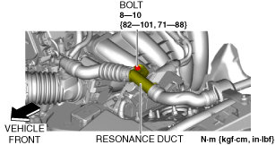

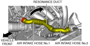

2.Set the resonance duct and air intake hoses No.1 and 2 aside as a single unit using the following procedure. (With resonance chamber No.2)
(1)Remove the bolt shown in the figure.
pic 3
amxuuw00005618

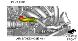

(2)Disconnect the air intake hose No.1 from the joint pipe.
pic 4
amxuuw00005619

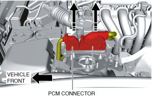

3.Disconnect the PCM connector. (See PCM CONNECTOR CONNECTION NOTE .)

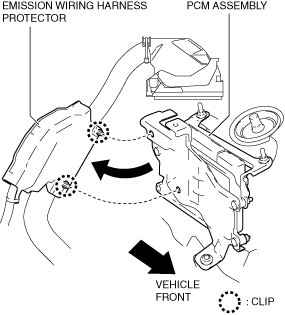

4.Detach the clips and remove the emission wiring harness protector.
pic 7
amxuuw00003658

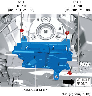

5.Remove the nuts and bolt.
pic 8
amxuuw00003659
6.Remove the PCM assembly.

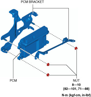

7.Remove the nuts.
pic 9
amxuuw00003660
8.Remove the PCM from the PCM bracket.
9.Install in the reverse order of removal.
