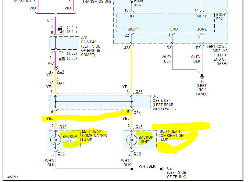

I would like to splice into the reverse wire for video. I want to connect a male RCA connection to an Android radio.
I have the nav style original headset.
It should be 1 to max 2 wires I presume.
Hopefully someone can help me identify this wire.
Jan 10, 2024 at 5:45 PM
  • 110,194 POSTS

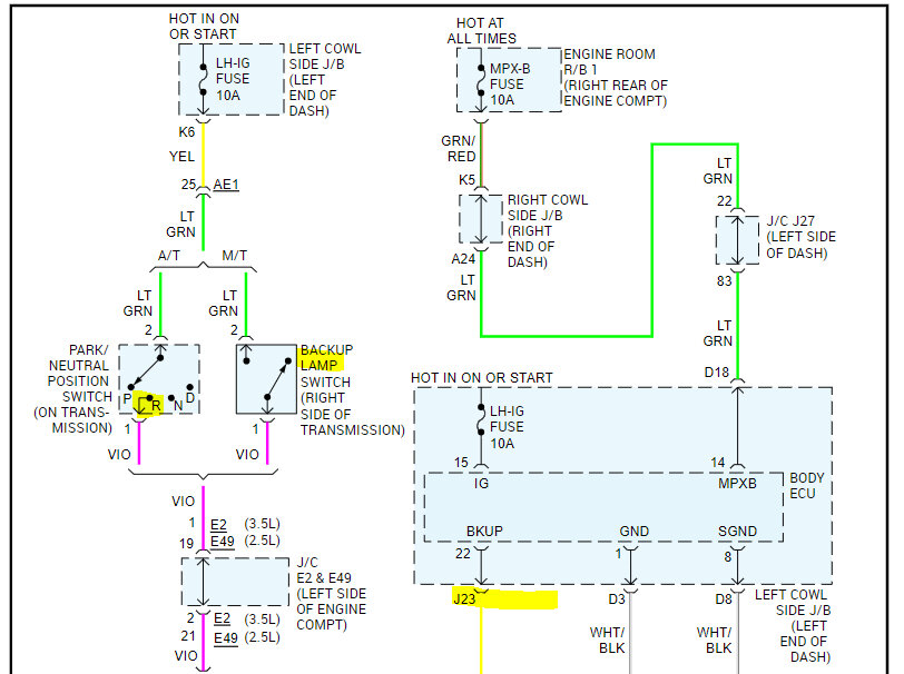

The wire to the reverse lights is yellow. That should receive power when the lights turn on.
If you look below, I attached the wiring schematic for the reverse light circuit. Take a look through them and let me know if you have questions.
Let me know if this helps.
